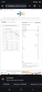

Are there any woofers that roll off smoothly?

"The woofer is supposed to naturally roll off ...in order to gentle cross with the tweeter that uses a single capacitor as the whole filter crossover" to which I replied "Once upon a time, I made something like that. And recall some drivers like that. Nowadays, I've been looking at a lot of different types and sizes of woofers and NADA. Nothing seems to roll off smoothly any more."
Am I blind? Missing something? Everything seems to have resonances on the top end and gyrations in frequency response...
