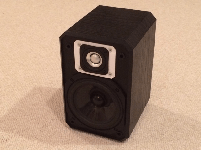

In addition to the numerous amplifier types that Dave & I mentioned above, I’ve also built several pairs of FAST/WAW and many more pairs of single driver/full range systems. It should be kept in mind that one of the design precepts of the former types is crossover points much lower than has become the norm in mainstream commercial 2ways - e.g. often between 250-320Hz or at least 2 octaves below the more common range of 1200-2000Hz. While selecting drivers that could play well in either scenario won’t be particularly troublesome, it will of course be as much subject to the subjectivity and predilections of the user as empirical specifications. Moreover, the cost of components for passive filter networks for WAW types can quickly escalate, and most of our implementations were actively bi-amped; as most of us long term DIYers have more than one or two spare amps kicking around, the cost of doing so can be as minor as a few dollars worth of caps and resistors to effect a PLLXO. It’s been quite a few years since my last foray into this field, but here’s a quick technical explanation of the subject and hopefully still functional link to spreadsheet here http://www.t-linespeakers.org/tech/filters/passiveHLxo.html
