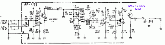

I made PCBs of my favorite amp - a Roland JC120 (just preamp side). The ultimate undisputed "Clean" guitar amp. Does everything from Jazz to Metal.
I coupled one PCB to an ICEPower 200ASC amp module and it sounds excellent. Also made another coupled to a Gainclone (LM3886). Only one channel, so doesn't do that gorgeous chorus, but can add another channel with a Boss Chorus pedal and achieve that sound....
So good that am now selling my real JC-120.
Google my friend....I cloned the original JC-120 schematic with the 2SK117, not the later versions with opamps...
I had a fellow here do the artwork, and I ordered the fab from China. It sounded OK, and it sat in my closet for a while, then I realized the four 2SK117 I used were fake. I replaced them with known real 2SK170 and it sound better than the real one (with opamps).
Dotneck - you wanna PCB to try yourself for free (I had to make 20 pcbs)?
Dot - Just for S&G, I went thru my 335 stage a few years ago...nice semi-hollows. Still have a Gibson Memphis (339)....I have been preferring the gorgeous cleans of my homemade tele with EMG Alinco...
Ha, I found it on my laptop...
Also attaching what I built...I removed the third 2SK117 - the one right after tonestack - plenty of gain.
I bought some 2SK117's (green) and I am not sure if they are fakes or not. Any way to tell? I was planning to do a simple preamp also.
Look at the top of the transistor - you should see a small rectangle on the seam joining the two parts - flat side and "d" side.
That little rectangle should be right smack in middle - centered on seam. Fakes are offset to one side on the 2SK170 and 2SK117.
Also, the Drain-Source resistance should be around 50 ohms for the 2SK170, unfortunately I cannot remember what it was on the 2SK117...
This may or may not be factual (I found all this out here on DIYAudio), but have no reason to not believe....made huge difference in my guitar preamp and a pacific phono stage that sounded ok/crappy for longest time due to "fake" 2SK170.
