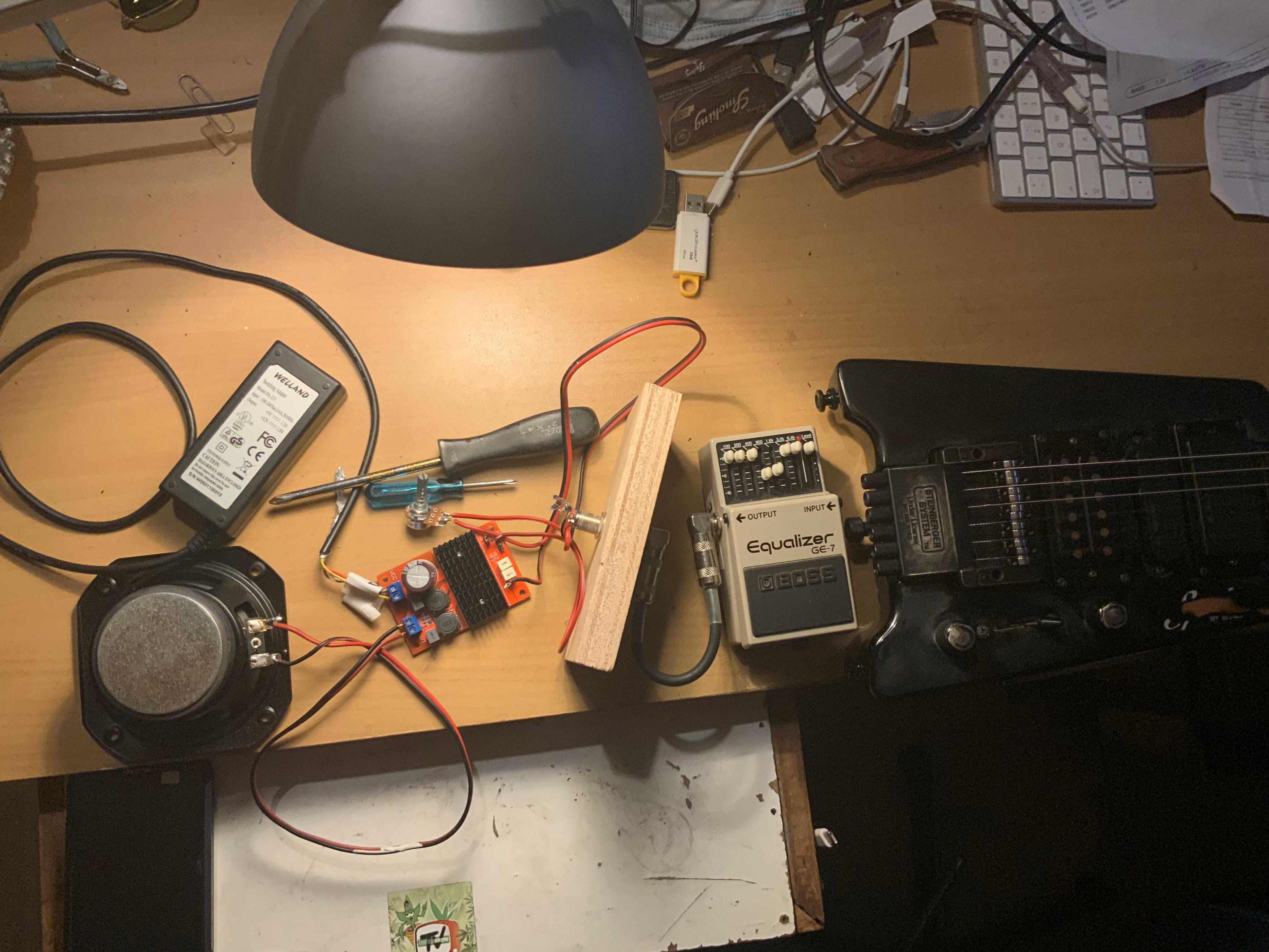

I know this thread is a few years old but I am making a guitar amp with the 3116 class D chip. I hooked up a guitar straight into the board and powered it with a 12v hard drive transformer. It of course was not a good sound. Brittle and thin. I presume I need a pre amp and probably with tone and volume controls but i don't know what kinds of specs to look for that would work with my amplifier board. And I was curious if anyone thinks I need more than 12volts for the power for that amp board? My speaker is 4 ohm by the way.
The input impedance on my TDA3116 based amp is 10k ohms. That's way too heavy a load for a guitar pickup. If you went straight in from the electric guitar to the TDA3116 amp, then I think that's why it sounds wheezy and thin.
Yes, I'd use a preamp in front of it, with tone controls. You won't need very much gain, because the typical TDA3116 amp board comes configured for something like 26dB gain (that's 20X gain). Maybe a single 12AX7 and a Fender-style tone stack would do it? Make the first 12AX7 the input tube, using a 1M ohm grid leak resistor and a 10k grid stopper. Then comes the tone control stack, and then the second 12AX7 could be a cathode follower. Or even a 12AT7 might work well for guitar (more harmonic distortion than a 12AX7, a bit less gain).
I'd also put a low pass filter in there somewhere, since electric guitar has zero frequencies above about 5kHz (and that's stretching it).
Do you use effects pedals? As was said the input of that 3116 is too low for a direct connection to guitar, but if you put your pedal-board in front of it, the output of any one of those should drive it better.
By pedal board I mean perhaps a graphic EQ pedal, a compressor pedal, a Wah pedal, a distortion pedal, a phasor / reverb / echo multi-effect pedal - all mounted on a board at your feet (with its own power supply). Plug your guitar into that chain, then your 10K input class D amp.

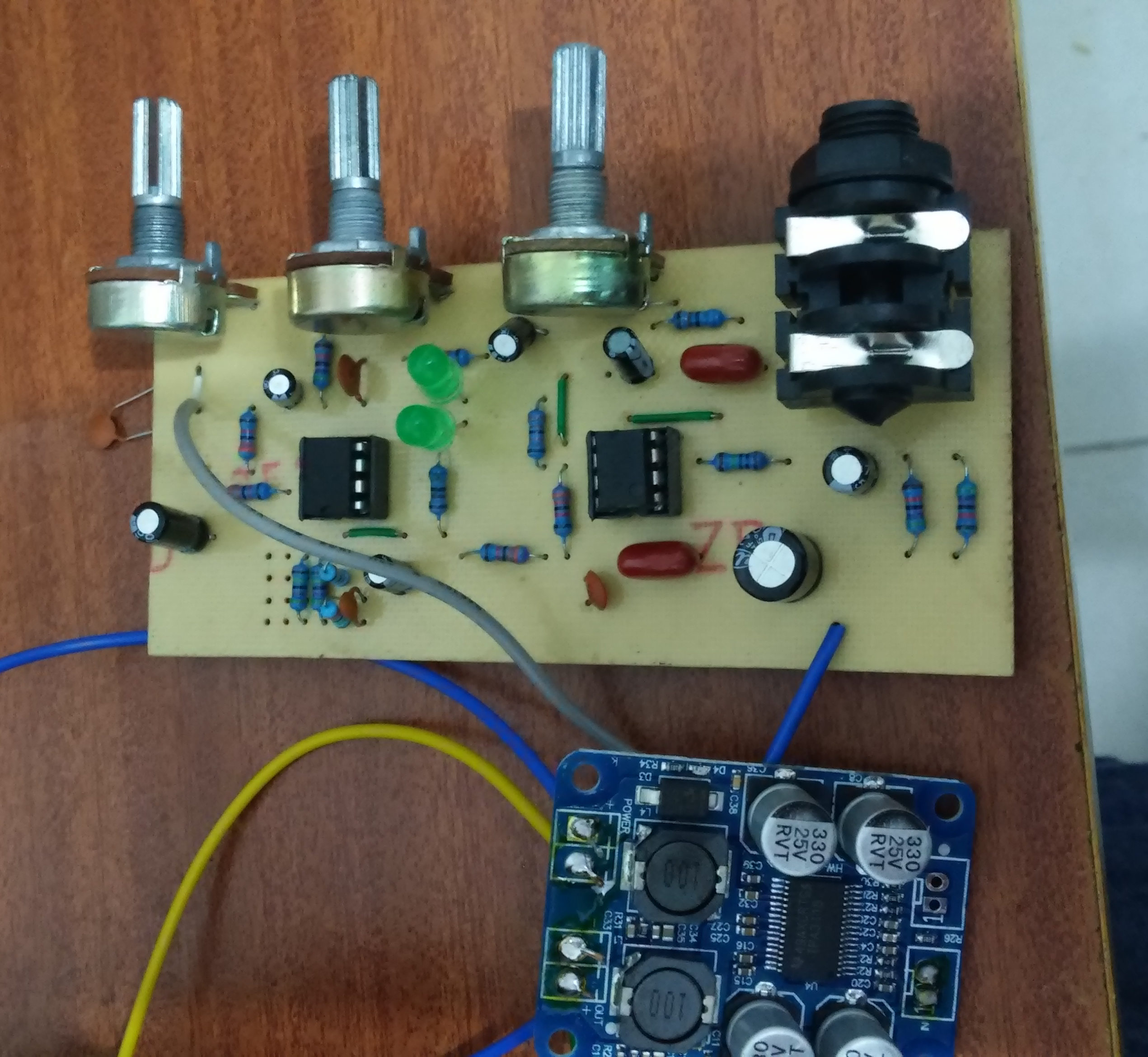

Reply to All above and below:
I WILL TRY to efficiently address all questions and clarify for All of you:

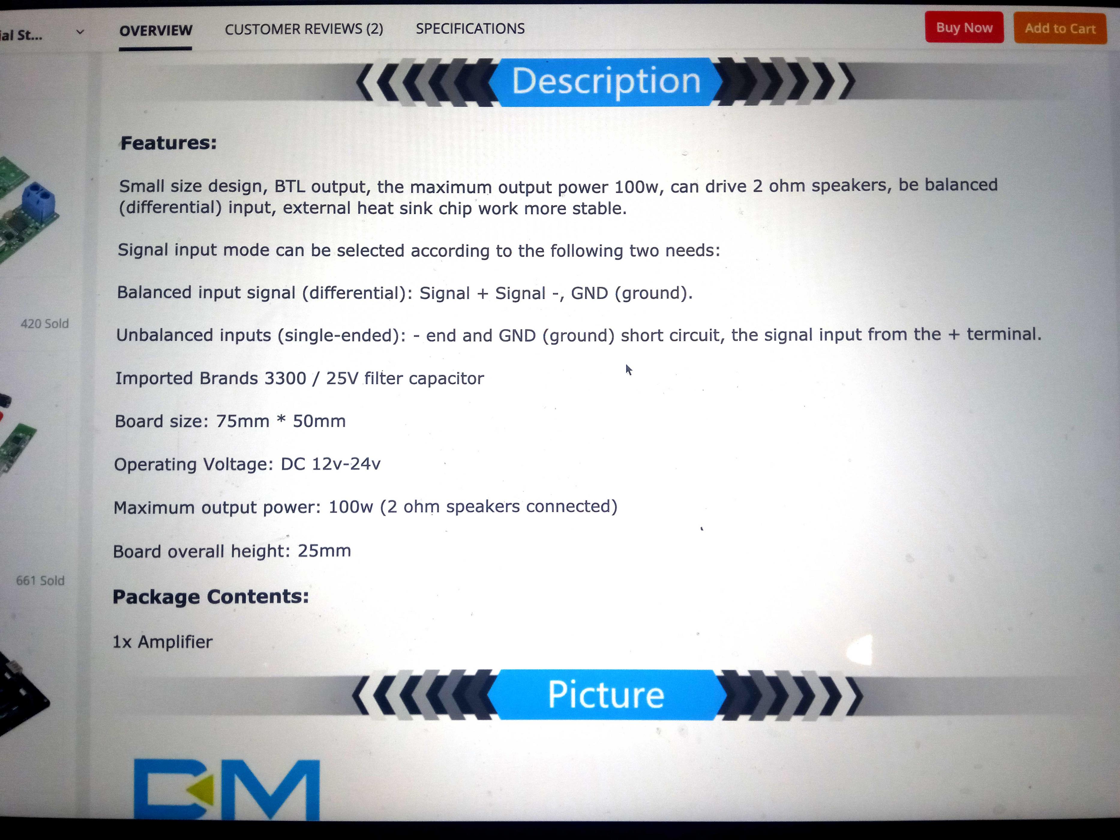

1- This will be all solid state. 2- Super small to fit in backpack. 3-See photos for lots of questions answered. 4- I play weird rock & roll but positive in nature. 5- No tube pre amps needed. Looking for correct solid state version with 3 tone knobs and volume and headphone jack. 6- Speaker is 4 ohm rated at 40 watts (I presume up to 80 watts rms) 86 Db. Seems good and I don't mind a bit of distortion. 7- EQ pedal/pre amp OUT is 1K ohm. 8- Guitar is shown but I use many. 9- Having a hard time finding schematic for amp board but i know it's a 3116 and photo attached has all the info I have. --- GENERAL INFO: This is a super small travel rig that will get MIC'd into a PA to get the warmth and lows that aren't right out of the speaker (works great like this for me and has a compression i like). This amp will act as my monitor but also feed into a PA system via microphone. I wanted the 100 watt board to have this thing be loud enough on live stage for my monitor but mic'd too for house sound. --- (MUSIC DEFINED: Mature but a bit strange and intellectually stimulating and even some spiritual insight. But also with roots rock & roll. Think if Morphine met Tom Waits in a circus tent for a strip show and invited Leonard Cohen to riff then the stripper comes out and puts clothes ON and then Neil Young comes in to remind all that ROCK & ROLL WILL NEVER DIE, with good heart and GROOVE!)

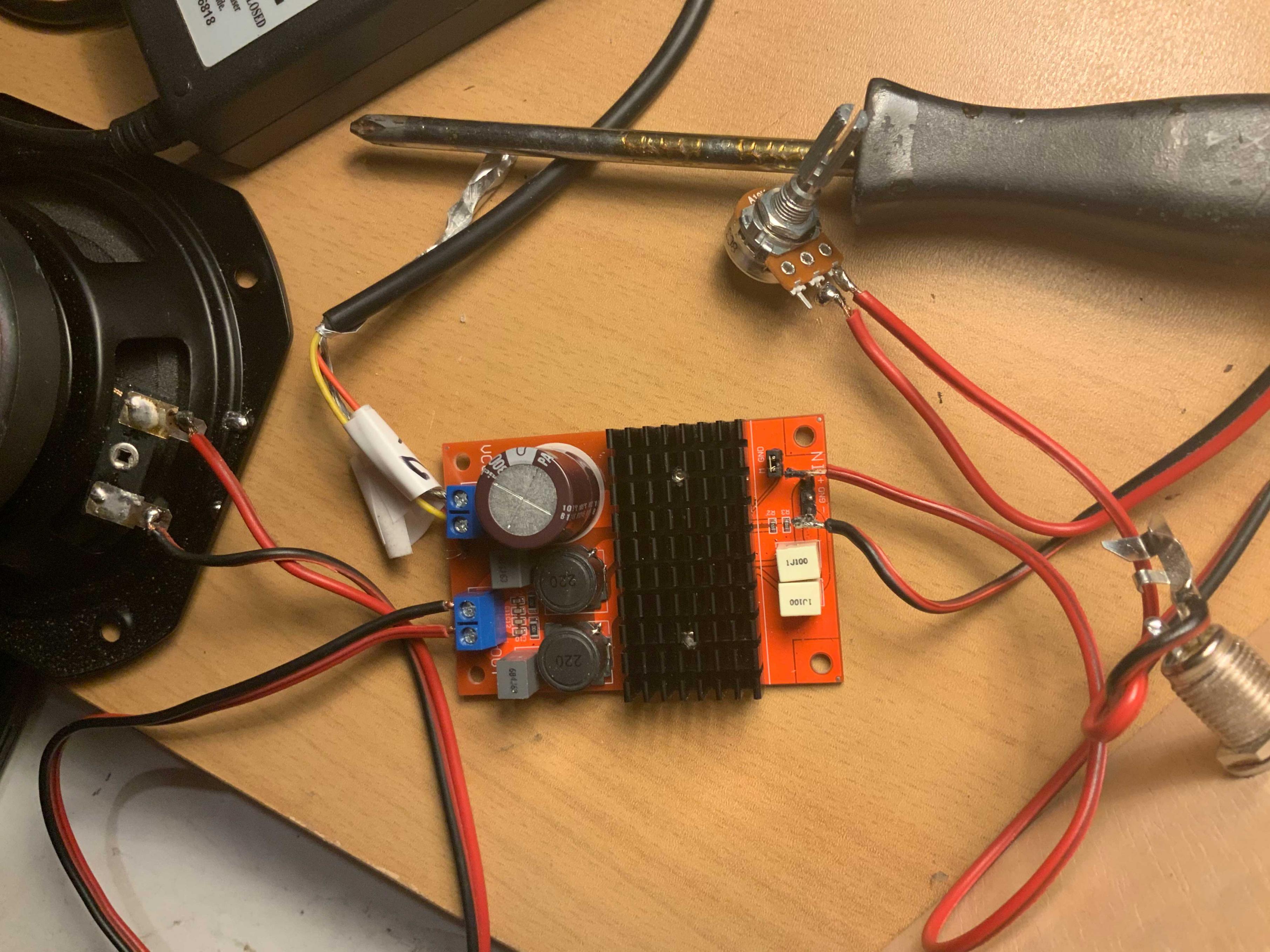

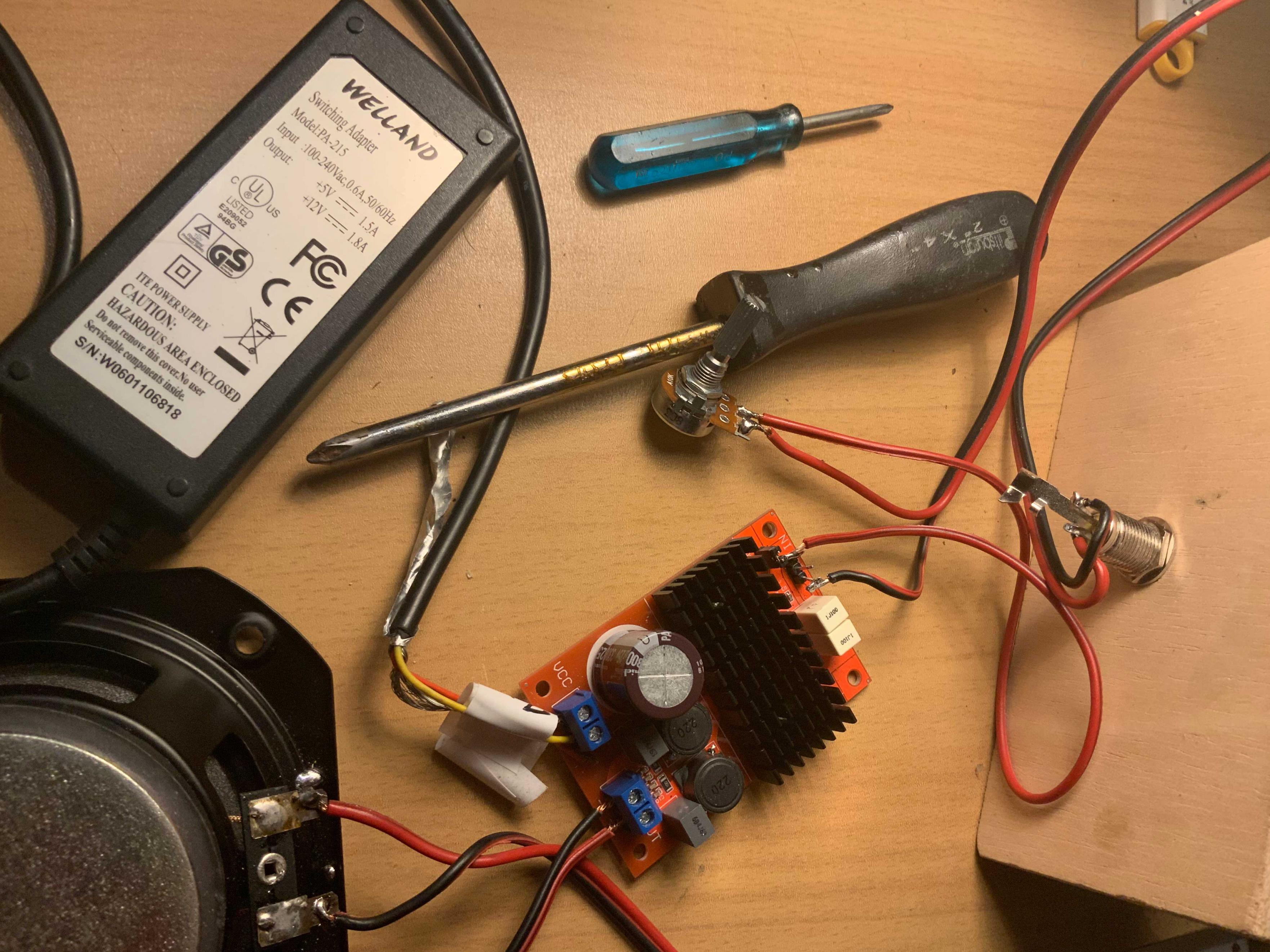

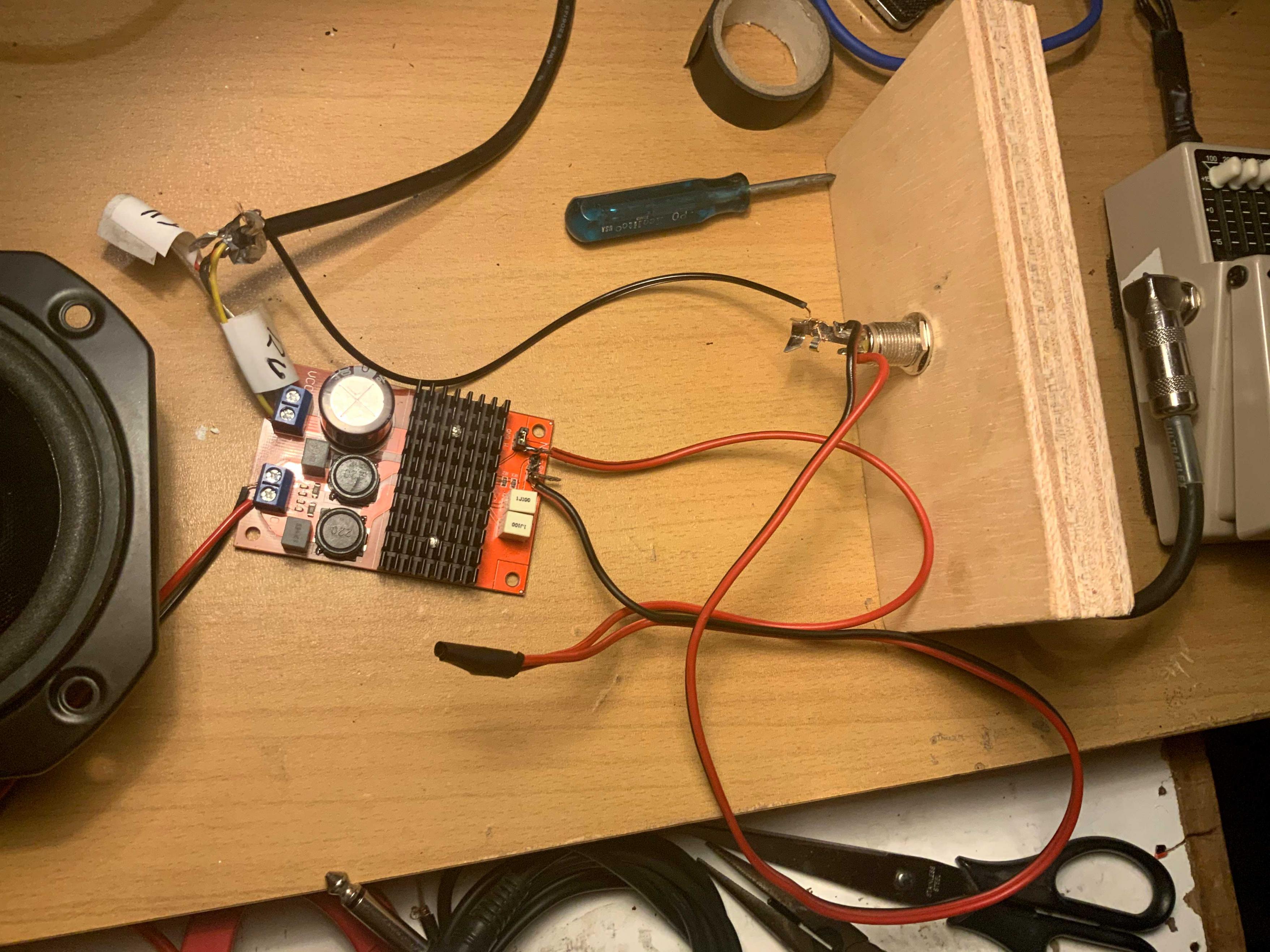

Yes, I understand sir, but I test first without a box. Box comes when i know the elements i must mount. UPDATE: I realized yesterday that the main problem was with the first guitar i used (borrowed). Now it works fine but I would love to have some help with grounding issues. In photo attached you will see I have grounded the power wire with the ground of the guitar plug. It sounds perfect. Zero hum. But when i unplug the guitar input (with or without pre amp EQ) there is noise, not just hum, pretty bad noise. So, is there a rule of thumb on how to ground everything appropriately? Attachment:

All guitar amps use a switched input jack. When there is nothing plugged in the switch shorts out the signal lead to ground. When we ask what kind of music you want to play (my fault not specific) we really mean what range of sound you want out of the guitar. The graphic EQ shows that you like the mid scoop of some guitar amps but that make be also due to no cabinet around the speaker.
Speaking of, is this your intended speaker? Do you play with a band as it may not cut it at those levels. Also you are not getting 100W on a 12V supply.
Speaker is 4 ohm rated at 40 watts (I presume up to 80 watts rms) 86 dB
The speaker is not a guitar speaker I take it. Depending on your volume it may not take the power it is rated for. You will not be getting 100W, 50W will require a 24V supply that is regulated as this is the maximum the chip takes. Get a 19-21V laptop power supply.
Basically find yourself a distortion pedal you like the sound with the type of guitar you intend to use and see if you can find the schematic for it.
PRINTER 2: "Also you are not getting 100W on a 12V supply."- I understand. Thanks.
I think it not efficient to reply to your other points but I hear you and am paying attention.
I THINK what i need is a rule of thumb or exacting comments for GROUNDING APPROPRIATELY the board and all else and FINDING SPECS FOR THE LOUDEST 4 INCH SPEAKERS i can find. The amp says it goes down to 2 ohm.
