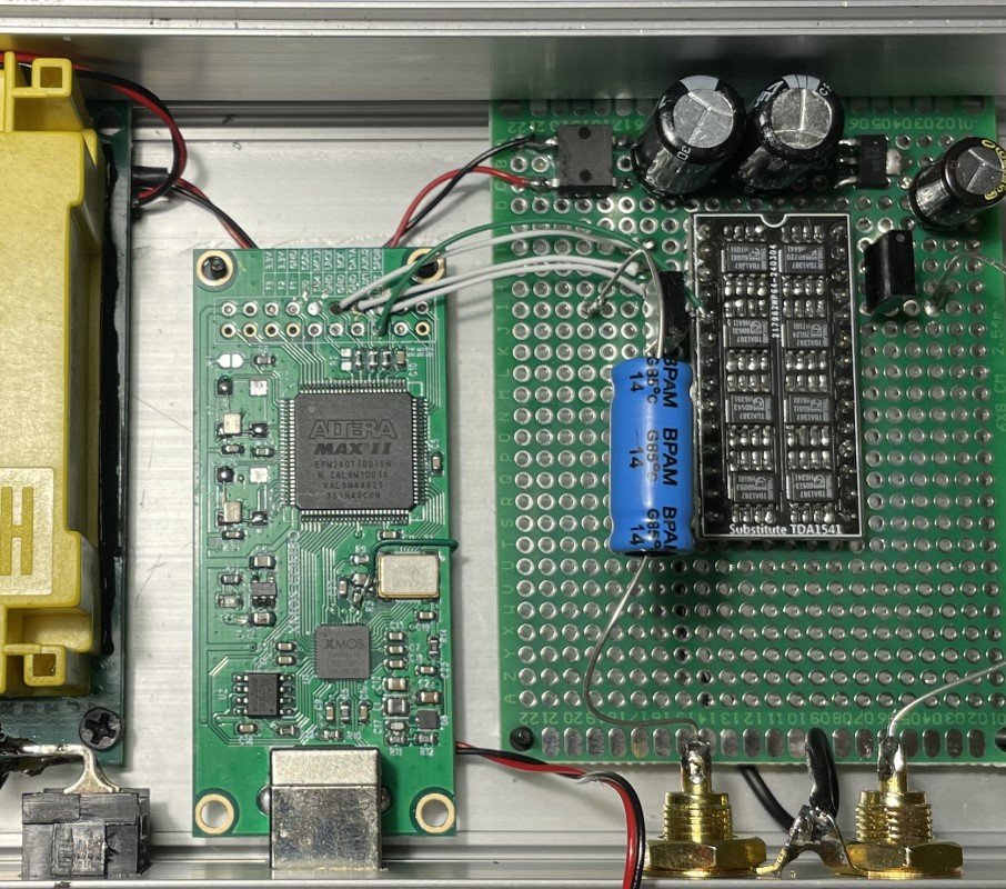

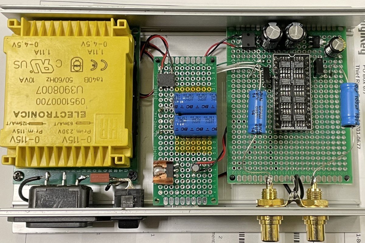

Almost done TDA1387x8 DAC. Very cheap 5USD board, but need some DIY and extra money investment. Excellent for it's price.
Don't look at output caps, just find comfortable place to listen to different types, it is very easy to swipe. Now it is CDE BPA series (for audio coupling).
Regarding the OT. Not the complete DAC, but only eight additional passive components are required, and a standard Philips I2S signal. TDA1387 X8 module, I2S input to pins 1, 2, 3 (LRCK, BCK, DATA, with 100-430R serial decoupling resistors), ground pin 5, +5VDC pin 28 (2000uF decoupling cap), right channel out pin 6, left channel out pin 25. Simple, passive I/V with two 430R resistors from output to ground. Output coupling caps with PP film 3.3uF for 10k SS inputs, lower value for higher impedence inputs. A simple NOS DAC. Gerber for PCB. Build one and hear it for yourself.
