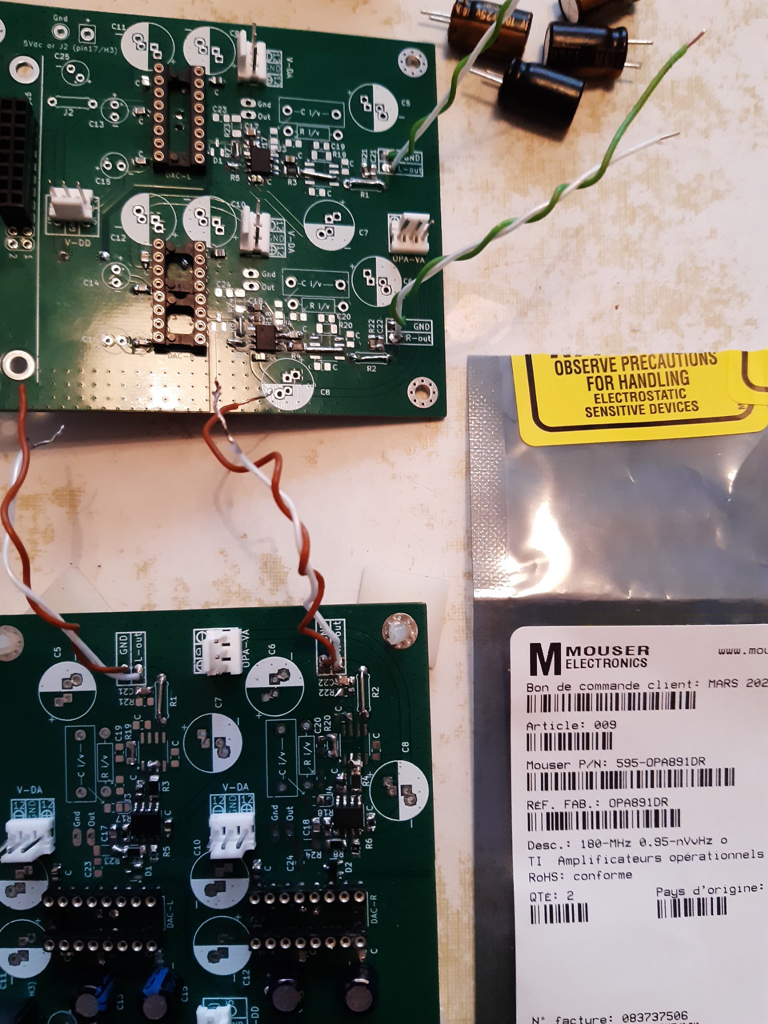

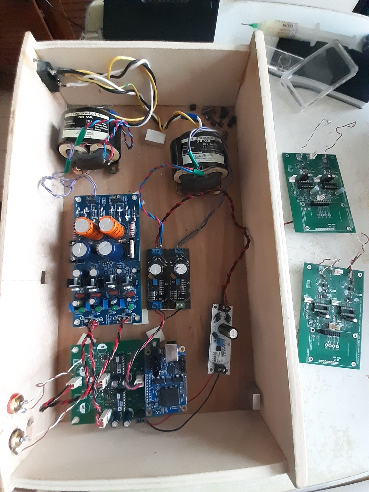

If you look at the first pic, you can see I also layouted an output near the dac output for tubes (wires). You can also use Tht caps & resistor for the I/V and use the RCA output. Initially this 4 layers is made to benchmark I/V alone or I/V + buffer/gain follower for fast op amps that are demanding about the layout.
All the guys saying the opa861 is bad don't know it sounds very good with a goodpower supply and chosen cap & resitor for the I/V of a current output dac chip. How strange a same dac sounds not the same with just 2 differents passive parts and any trained guy or musician can immediatlt hear it whatever he is not aware of the mod... SINAD number, the same, one sounds more acurate the other so-so... 😉 .
Here I test the opa891 you will not see in a cheap chi-fi dac, but the layout was also made to benchmark on a same DAC smd parts or Tht I/V parts for the special opa861. Ad811 curent operational amplifier was tested too. No one sings the same, and no one reacts the same to the same passive parts. There are not ultimatly best passive parts you can put everywhere. It simply doesn't work like that. It asks time and hours of experiments !
What chi-fi low cost doesn't is to voice their DACs : you need to play with everything for correct tonal, it's really not about SINAD !
