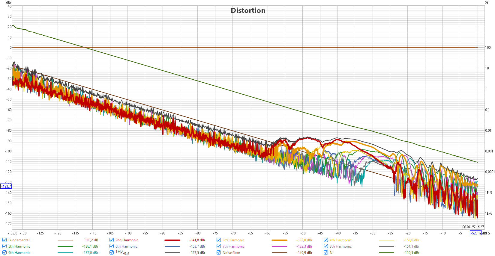

Regarding spureous noise spikes in DAC:
An example of stepped response measurement.
Takes about 4 hours to be done
0.1 dB step. 88kHz bandwith, 1k sin
If there were spurious noise spikes at some point during the measurements the noise measurement should also have a spike. But it does’t.
And that is really impressive!
