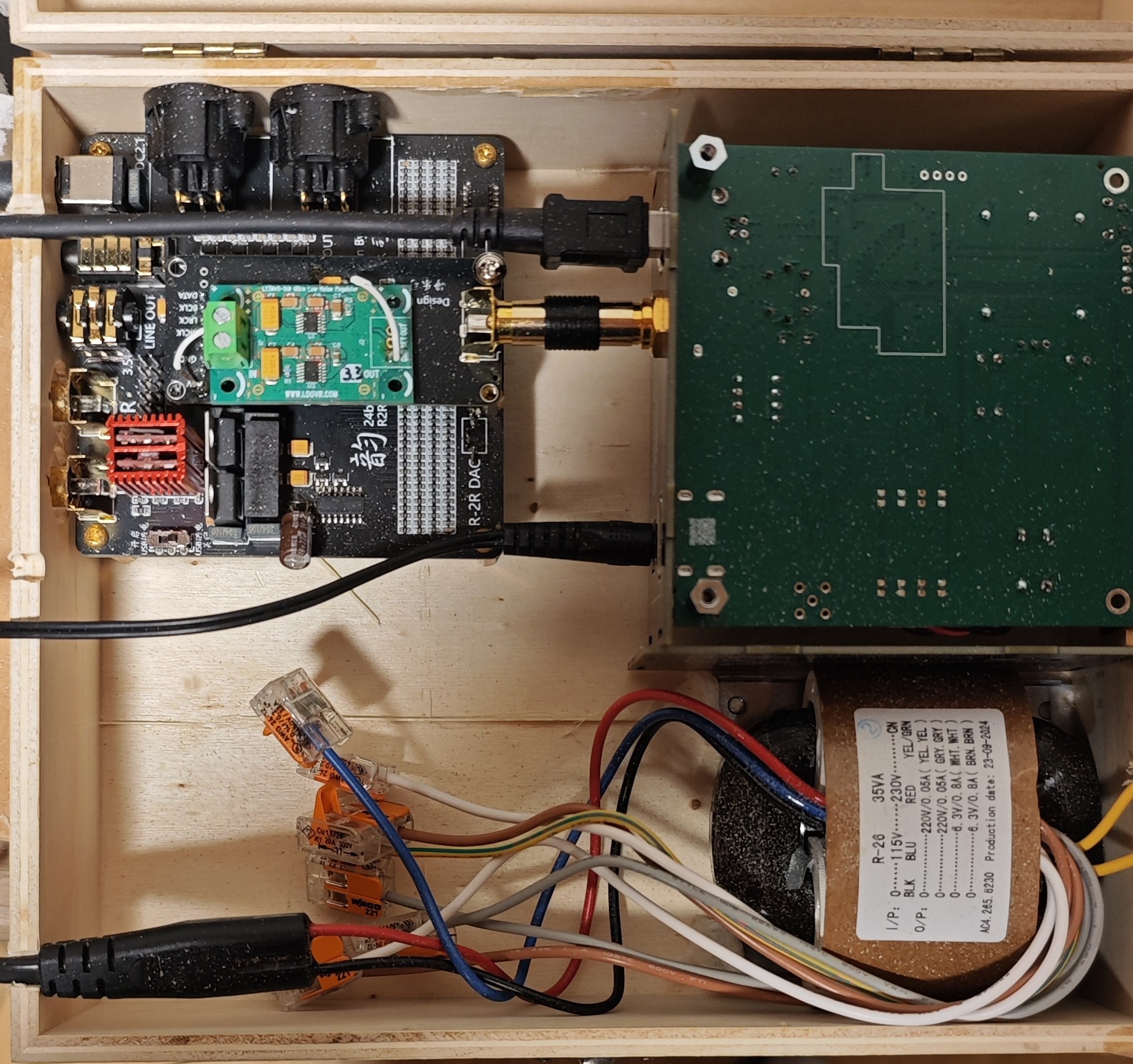

I still highly recommend this guy for a spacious analog like sound. They reduced it to $106
If you are willing to dash out $85 for the Sparkos SS2590 then you get rewarded with even more clarity and spacious representation than with the Burson V7V.
The only negative point is not related to sound: They keep on changing the circuit of the output stage. I got two different versions but they sound the same to my ears.
Here is my test implementation hooked up to the excellent UAC1 Fifo DDC board.

Besides the unsafe & dumb way of working the screen of the transformer should be connected to PE. It seems a tube transformer being used as isolation transformer but then both secondary 220V windings should be used in parallel. It has too many unused secondary windings that should have a load. Not even the 5 minutes needed to make an IEC inlet and holes for cabling in the wood were spent. Also loose transformer and boards are sloppy even when prototyping. Wooden case and no required shielding so high chance of different sound over the day. Dirt/dust on the important resistors of the R2R DAC (that originally had a metal/shielded casing). But it has Sparkos 🙂https://a.aliexpress.com/_Ev27OJO

Maybe such pictures are better not posted.
Too late to edit my post but take care in selecting when finding the R2R DAC. Since the chinese understood the buzzwords attracting audiophiles like fish swimming to bait on a hook many versions exist. The R2R DAC described is available at the Aliexpress High End store in many versions with at least different PCB layouts but sometimes also different circuits. This also counts for the input boards with various interfaces (dual USB-B & USB-C, single USB, SPDIF etc.), plastic or metal casings and even PSUs. To make it complete also the onboard regulators can be different just like the output circuits. Then the "upgraded" and "improved" versions of the previous. Much choice, exactly as we like it but difficult to select. Do all versions work OK? And ... which one is good or best?
For those swimming to the gadget on the hook it would be good to start a thread about this marvel of technology and to make a list of which exact versions exist and what their differences are. Also firmware versions, how to implement boards the best way etc.
