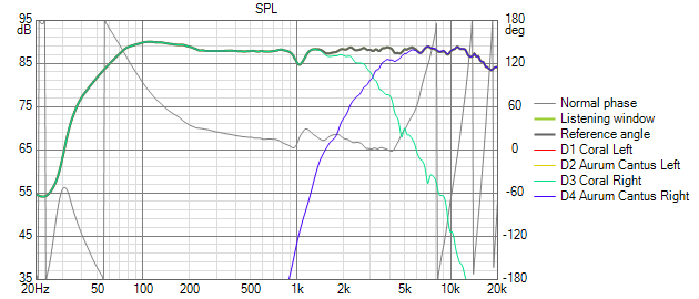

It's also important to compare the response on a real, finite cabinet. A driver might have a very smooth response flush mounted on an infinite baffle but due to excessively wide dispersion suffer severely from cabinet edge diffraction that completely ruins the response.
Smooth published infinite baffle responses don't predict how a driver will measure on a real, finite baffle.
This is where a waveguide loaded ribbon tweeter (or any waveguide tweeter for that matter) is at a major advantage - put it onto a regular finite baffle and the response will be much less affected by cabinet edge diffraction - you will get pretty close to the infinite baffle response in practice even on a real cabinet.
So it might start off slightly less flat on a perfect infinite baffle but actually measure flatter on a real baffle thanks to the directivity. This effect can't be underestimated. Nearly all dome tweeters mounted on traditional small flat baffles have severe cabinet edge diffraction anomalies in the frequency response which can't be solved with a 1/2" round over.
Anyway, I don't know what ribbon tweeters tvrgeek has measured that have "horrendous response curves", but I wouldn't put mine into that category.
With a small amount of gradual EQ in the high pass crossover near the crossover point and at the very top they are +/- 1dB and smooth with no resonances all the way from the crossover at 3Khz to about 15Khz. (Above that my microphone and hearing are both not up to the task...)
This is the Vituixcad sim for the crossovers based on real in cabinet measurements of both drivers:
attachment.php
Tweeter looks pretty smooth to me, considering this measurement includes cabinet edge diffraction from a shoebox cabinet without even round overs...
They sound clean and smooth even at high SPL where the full range driver is starting to break up a bit with bass / midrange intermod...
