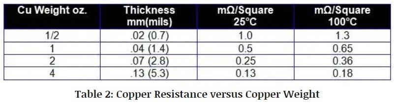

People are right its all about the current handling of the trace. I was just taken aback because I never calculated the equivalent wire gauge of a known PCB trace before now. I was really surprised by how thin the equivalent wire is on PCB's, eye opening.
Cross-section is only a potential issue for heaters: tube circuits tend to work at high voltage/low current conditions (there are exceptions, in transmitters, welders, etc. but they are outside of the DIY realm).

For those interested in mental estimation of track resistances.
https://www.edn.com/counting-square...e of 0.5 mΩ per square, and,x 0.5 mΩ = 3.0 mΩ.
So if a track is on 1 oz copper and the trace is 1 unit wide and 10 units long it will have a resistance of 0.5 milliohms x 10 so 5 milliohms.
If the track is passing 4 amps it will dissipate (power= current squared x resistance) power = 0.08 watts, the voltage drop will be V=IR so Vdrop = 20mV
