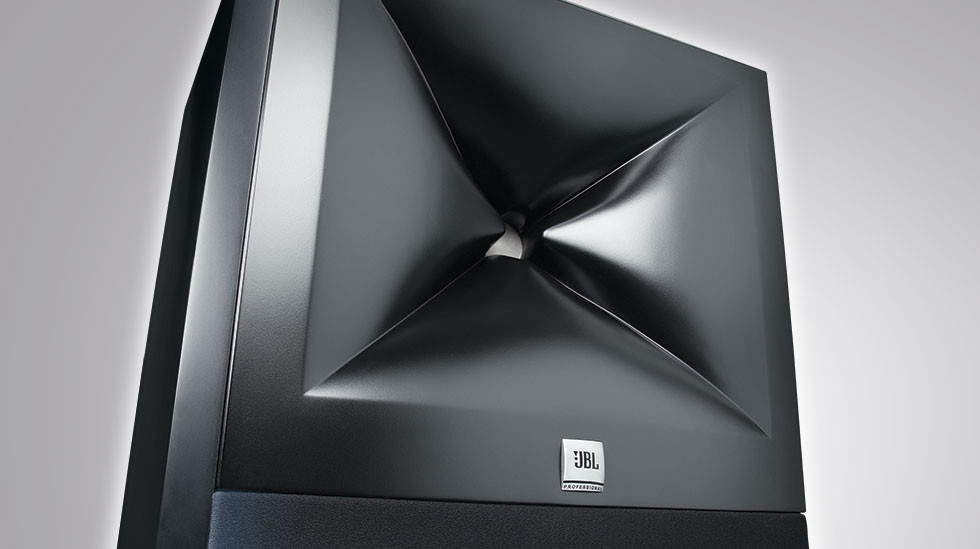

I would tend to think the math required to design this one would boggle the mind.
___________________________________________________Rick..........
I highly doubt that there is any math behind this. They probably used some BEM software and just crunched out some shapes.
Now this is what amuses me. Transitioning from one plane to another via the shortest and smoothest radius possible is expected of any tradesman for reasons of economy and grace. Deviation from this route would seem superfluous and wasteful. I see this as a given. Arggghhh.

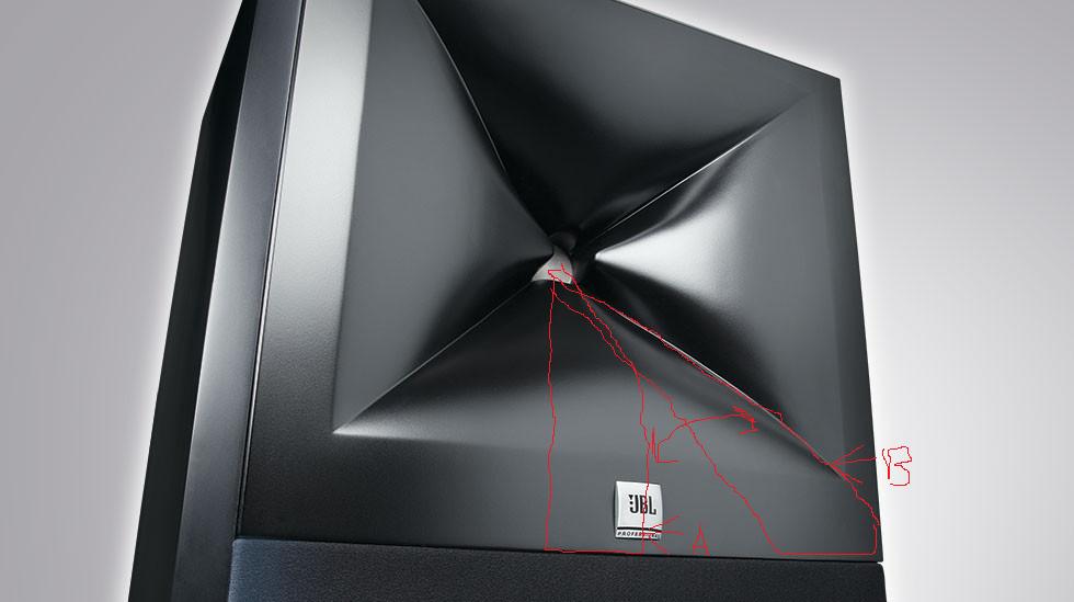

I spent a couple hours trying to make one of those in Autodesk Design 3D, with little success 🙁
-picture it without the hole - as if it extend to the center in the same shape.
It's two sets of weird "triangles". Essentially you want to "cut" the triangles in half - making half of one.
Start with the profile/contour for the *center* of one triangle (its plane), then
(Note: make sure that all triangle profile/contours *start* as if from the center of the waveguide - like the hole isn't there.)
Make the profile/contour for the creased "edge" (its plane relative to the first), then
Use the loft function to connect the two profile/contour "slices", then
Use the mirror function to mirror over the other half of the "triangle", then
Copy that new "triangle" and invert it to the opposite side and move it into position.
From there all you should need is the profile/contour of center of the next other set of triangles - and you can loft that to each "crease" on that side of the triangle you've already created. And again new triangle: copy and correctly place relative to the other triangles.
Once that's done all you need to do is create your center hole diameter as an extrude cut and your done.
The toughest part is getting the spline/line for the contour the way you want it, but there are really only 3 of them: 2 different centers contours (similar, yet one is longer than the other), and one crease contour.

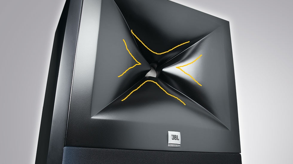

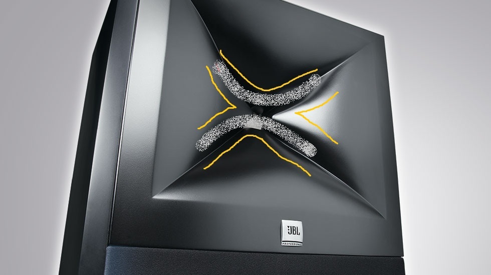

Yes, the 4 "triangles".
Please excuse my poor paint skills.. 😱
Rather (on what to do in the cad),
"A" represents the contour of the center of the top and bottom "triangle".
"B" represents the contour of the outer-edge of the triangle or "crease".
The double arrows points to the two outline "slices" you want to use the loft function on.
Both are "cut-away" representations, as if you cut a very fine slice through the top of the waveguide (cutting downward) and looked at that cut on it's side. (..and I'm assuming a relative "box"/right-angle shape for everything but the waveguide's contour/flair.)
Both have their own planes and are relative to each other. It's really a 2D outline/sketch on that plane, and then lofting one sketch to the other.
It's probably best to start with some guide-lines for the center (top-down perspective) to get the placement and angle right for each plane to draw your "slice" on.
I see it like two curves
its like an orchid, really
and doing double duty also being a phase plug at the same time
