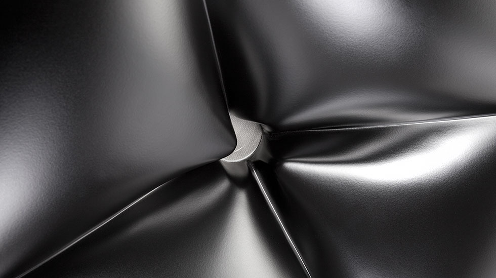

I would tend to think the math required to design this one would boggle the mind.
___________________________________________________Rick..........
I spent a couple hours trying to make one of those in Autodesk Design 3D, with little success 🙁
