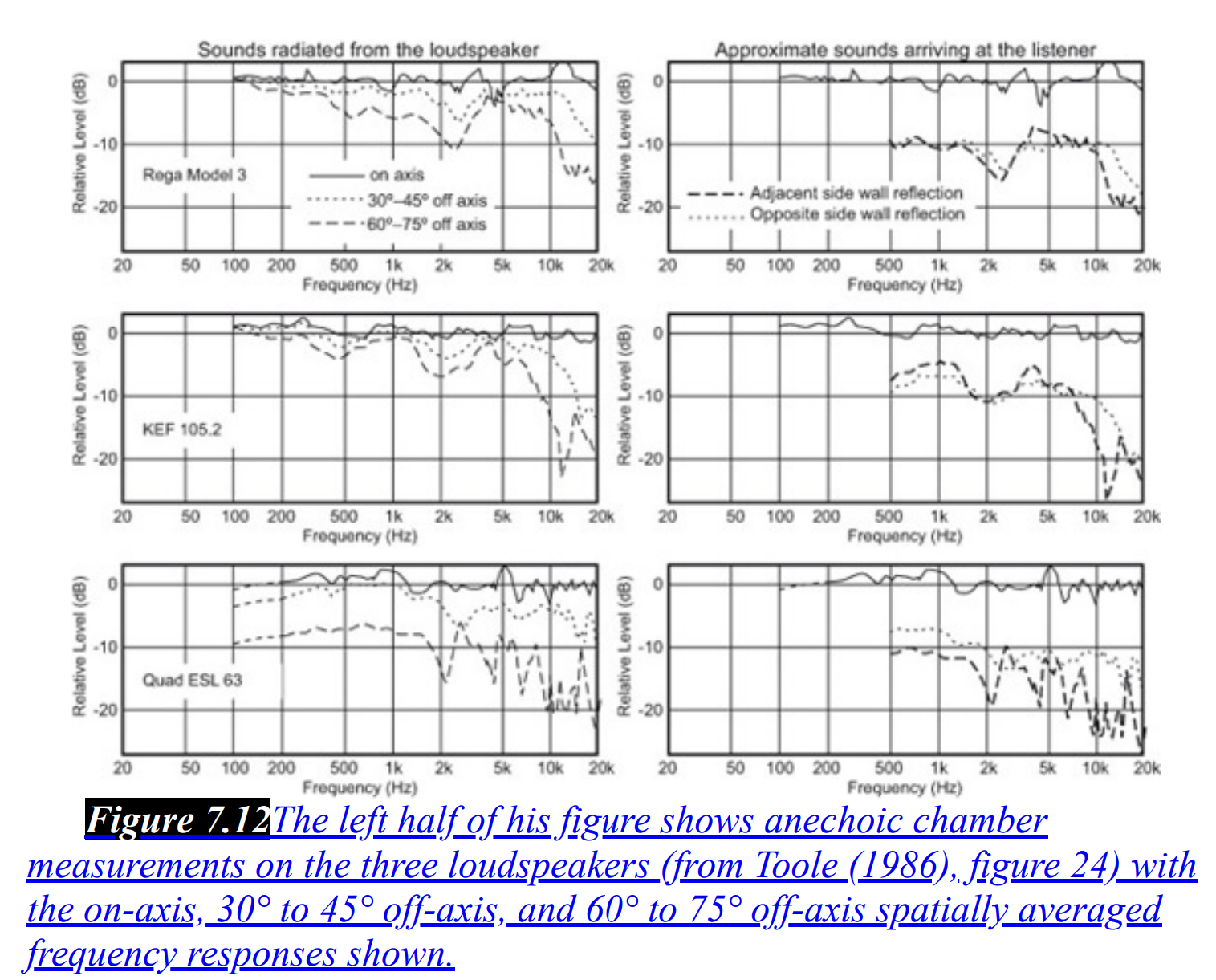

The opening paragraphs of 7.1 in Toole's Third edition book (that you referred to be before) has added a few disclaimers and warnings due to misinterpretations of those research findings. Toole's book now aligns more closely with the quote from Geddes wesayso posted above.
Exactly right! People, please do read the 3rd edition, it is definitely NOT just a cosmetic update. There are MANY changes to the book.
And in fairness, it wasn't just misinterpretation. I think Toole's wording was a bit misleading on this particular issue (though I'm sure unintentionally so) in the previous editions of his book.
I may even go as far as guessing that he may have realised that he was a bit... how shall we put it?... plain wrong about early reflections, and then decided to gently walk back some of what he'd said, without overtly admitting that he was actually mistaken.

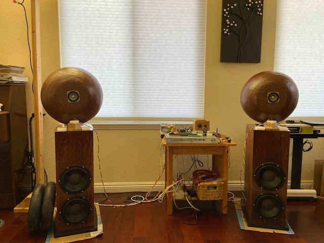

I completely agree, of all the speakers I have made - this speaker for me, has the very best imaging and is about as narrow as I could get. The tweeter is now waveguided too - to match mid/tweeter dispersion at crossover exactly.
Is that a volt mid dome? How does it compare to other mid domes?
Just to provide an example to support the idea that great imaging is not limited to speakers with narrow baffles.
Fostex FF85wk's in spheres running from 200Hz up. The imaging is impressive.

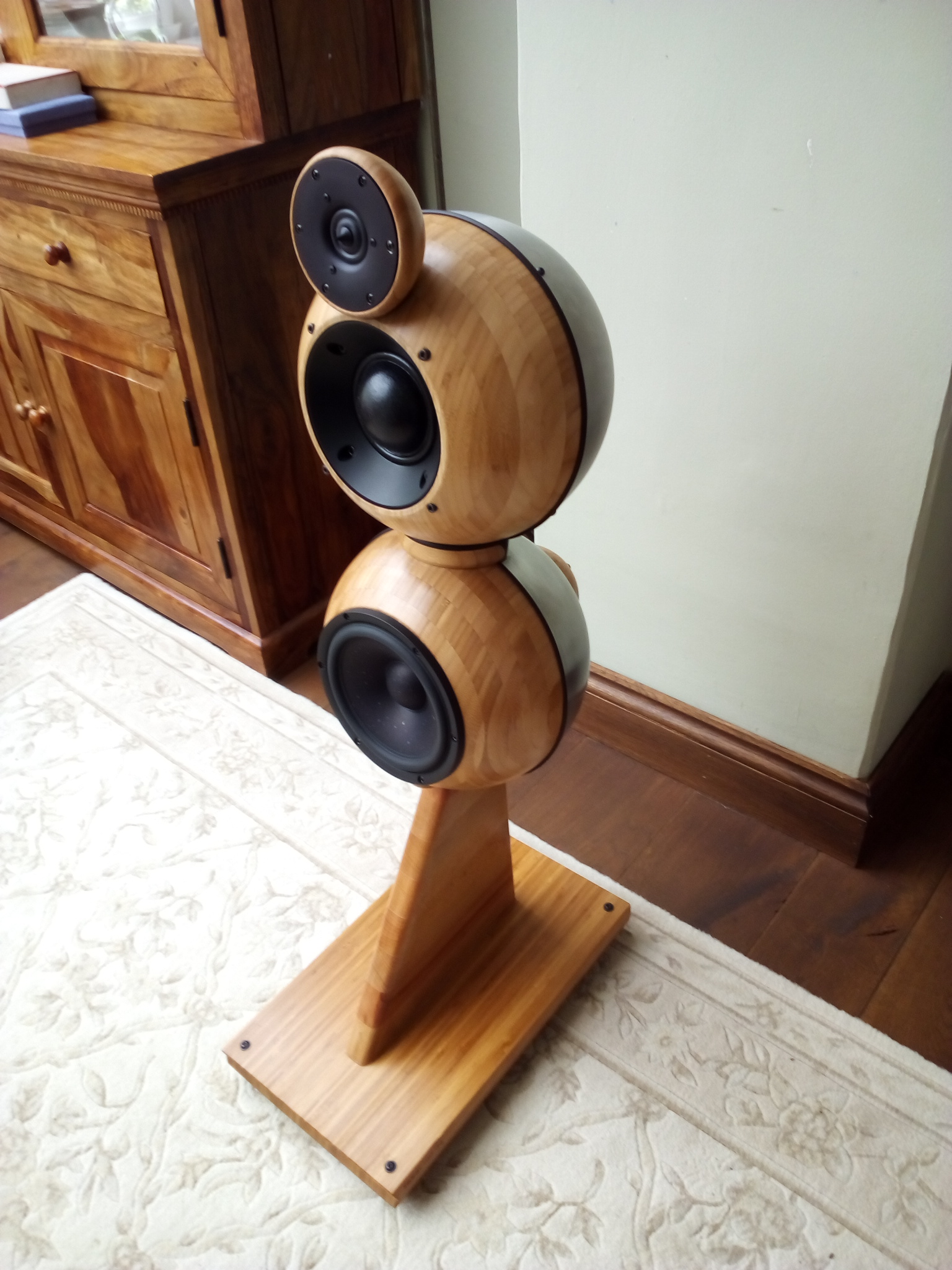

KCHANG ... I wouldn't consider that tweeter hemispheric baffle "small". What is more interesting is how the shape works to launch enough energy toward its mate to build the image. This is the quality that true constant directivity speakers lack.

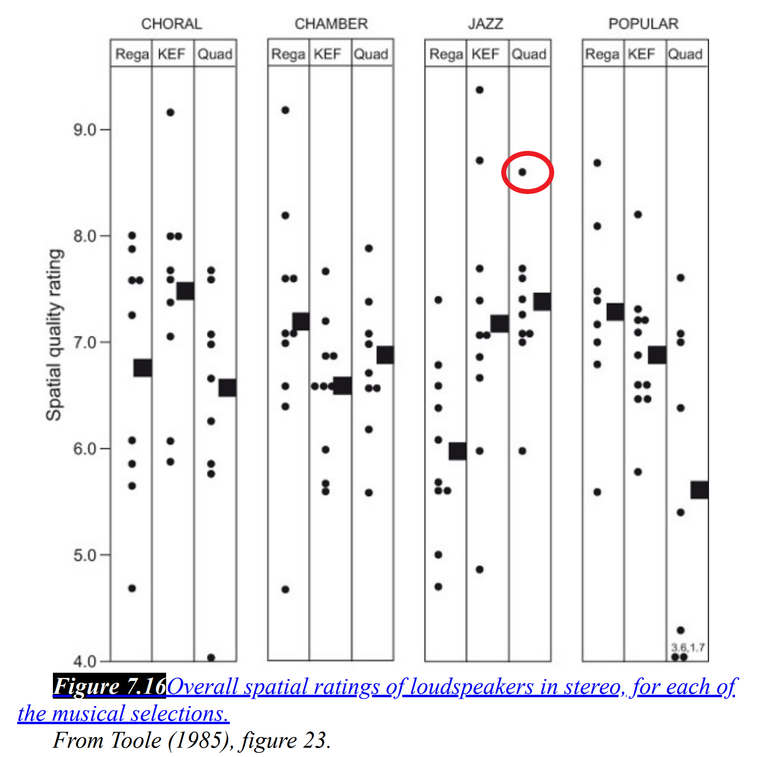

If you look through all the research on blind listening studies the greatest confounding factor is always the program material that was used to conduct the test. So while the results are valid for the music that was used to conduct them it is not always completely transferrable to other types of program material and goes a long way to understand why the results can be valid but other people still come to their own different conclusions based on what they listened to.
A few years ago I couldn't care less about imaging and often found it to be distracting and annoying. In my most recent system I have reduced the early reflections significantly and changed the positioning of the speakers. I can now hear some very precise positioning within and beyond the bounds of the speakers and I must say that I have been converted to the point that I listen to some tracks just because of the amazing imaging. I can now see why some people are so fanatical about it.
Toole included the impact of program material in his 3rd edition. I think it's good for people to read the chapter 7 sections and take a close look at the images he includes. I circled one of the dots in red to make sure people understand I'm not conflating generalization with universal truth. Especially since this is research on preferences. Yes, we're going to have outliers and those people will really like imaging.
