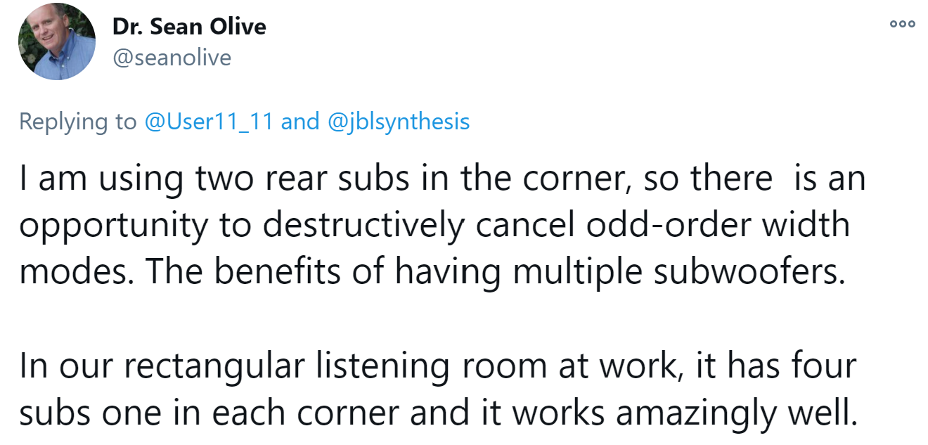

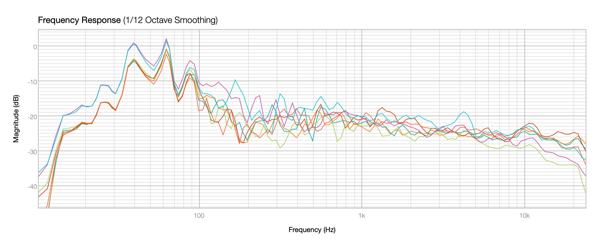

They can't do that without 'activating' (contributing to) those modes. When you say cancel, what happens to those frequencies. They are, after all associated with that mode because they are in the room.
Dr Geddes didn't express a desire to turn the modes into resonances, but you can't just ignore them.
I have no idea, you can ask Sean Olive about it on twitter.

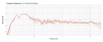

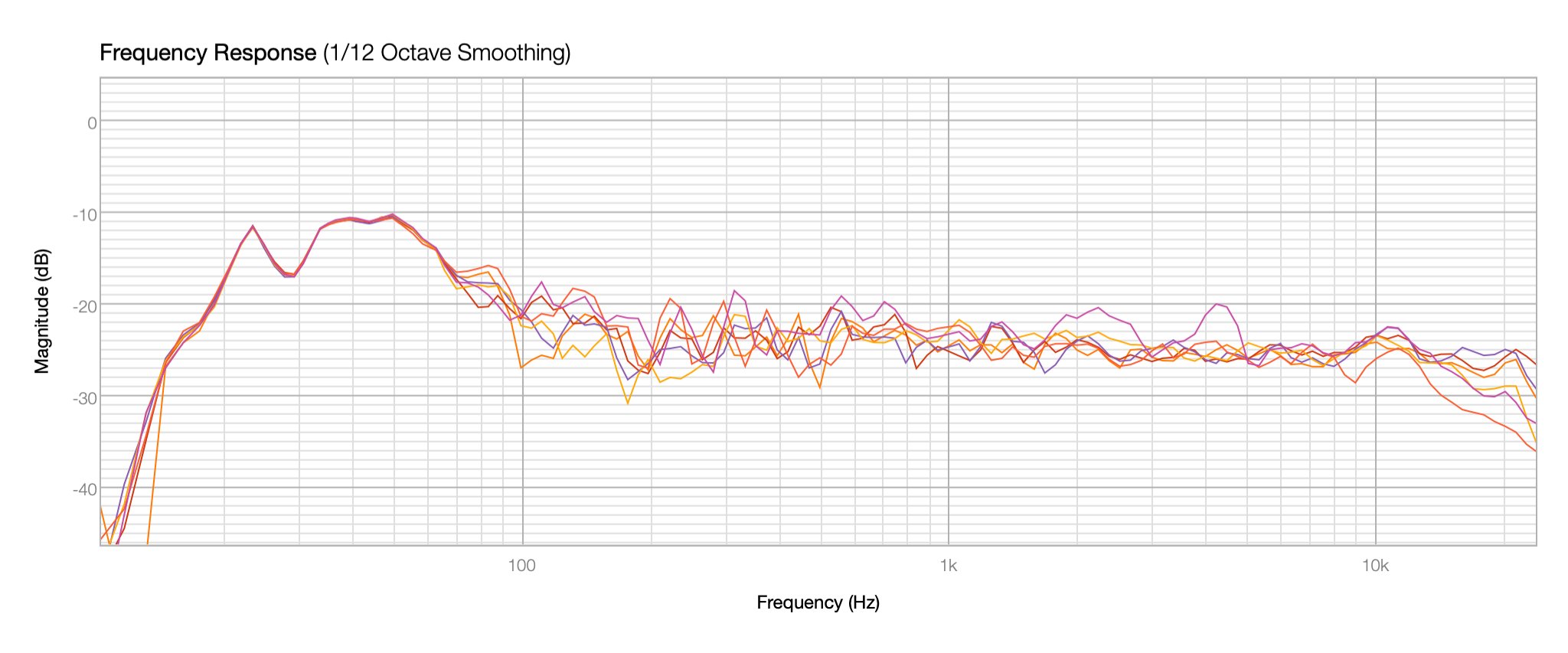

Alternatively, Floyd Toole and Todd Welti intentionally crossed low frequencies out of Toole's Revel Salon 2s. They used Welti's strategy.
On his website for the NS15 it says this:
however, ported designs are possible for extended low end should the use of multiple subs (highly recommended) not be desirable.
Still don't know why you wouldn't want the free bass. I haven't seen any evidence that indicates that you get worse bass response at your listening position unless you ONLY excite the room modes with subs in the corners (??) I have seen the Harman white papers that show different responses with subs at two corners, 4 corners, midpoint of each wall, etc.
