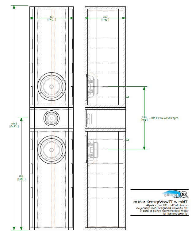

The classic problem of dipole vibration always rears its head when designing new boxes, and this time I'm thinking of building them from the magnet up. So, instead of transferring vibrations from the magnet to the front of the basket and into the box panels, I'm inclined to bulk-up the magnet directly with a granite rectangle or something like that glued to it, and control vibrations at the interface between the granite and the plywood. The legacy plastic basket can float in mid air, with silicone for an airtight seal.
For a 2-way, the MA 5.3 would be playing with something like a 10" Faital 200FE10 or Eminence Beta 12A in 50L+. A waveguide could help raise the 5.3's sensitivity but it would be an experimental process to find out what sounds best.

Typically the range of wAW XOs is about 200-450 Hz, below that it morphs into a sub/satelite system and above that a riobust cone tweeter (the MA SOTA that used something akin to A5x was XOed at 2KHz). Given the overlap one can move from “mostly the FR” up to “plays louder”. Ideally the C-C distance is greater than the quarter-wave at the XO. But sometimes one has to compromise. These for instance (but with A10p instead of A7x. meant to play fairly loud with little or no strain) is more like a third at the lowest part of the potental XO range.
The woofer we use in the MTM is good on-axis to 10k, the XO is chosen to stay within the quarter-wave criteria. The ones in the Ellipsa (apologies to SF) only reach 1.7 kHz.
There is a ton of room to explore with WAWs. Few examples have been done and published (OBs excepted, almost every OB that uses a FR top is a WAW). A growing number of nice FRs that get to a 100, and reach up high quite well… from clean (A5.3) to romantic (FE108e∑) and, and… and a huge number of midBasses done for dome+cone systems where you only have to worry about <500 Hz or so. A huge range of potential capabilities.

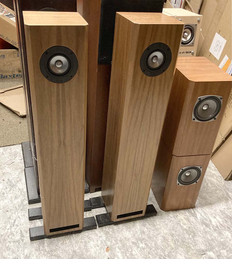

These are the mniOnkens:
Frugel-Horn Lite drags maximum bottom out of them.
Giraffe, a Woden ML-TL
Next to it is the BabyLab for the FE105wk, there is ne for A5.2/3 (Bloodhound).
And they will be the midTweeters in this monstrosity (WAW with 4xPeerless 830870 in an ML-Voigt, midT an aperiodic midTL. Called Facets. A bugger to build.just ask Chris.
