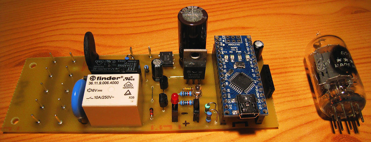

I use an Arduino controller in my GM-70 SE amplifier.
It manages soft start, monitors instant and average cathode current and breaks the HT power transformer primary if it detects any problem.
It also controls LEDs to signal status and power clipping.
This little controller ($10) allows me to use fixed bias without fearing runaway power tubes! 🙂

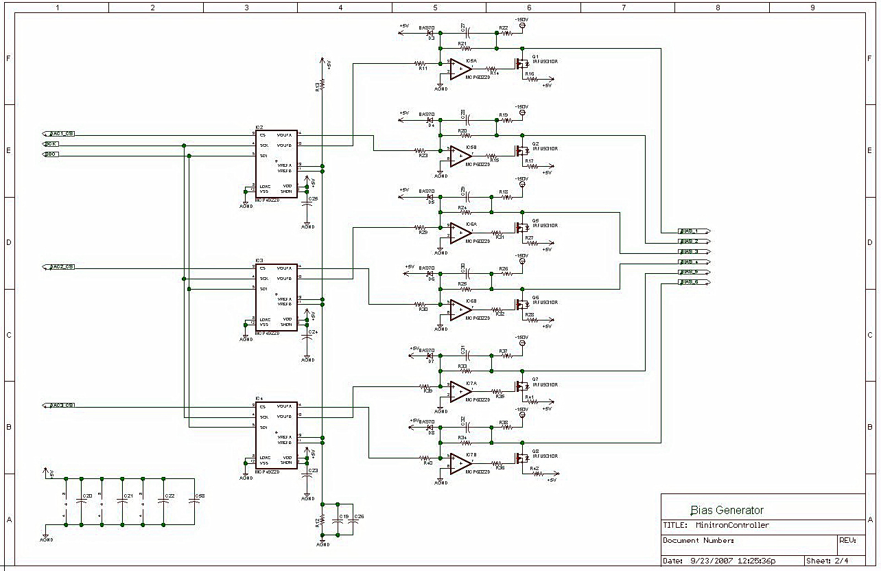

Page 1 is the dsPIC chip and EEPROM for saving settings.
Page 2 is bias controller. SPI commands are sent to the dual DACs which create a voltage from 0 to +5V. The opamps scale that into a 0 to -150 volt bias. There are 6 duplicate circuits. There were 4 output tubes and two drivers under PIC control.

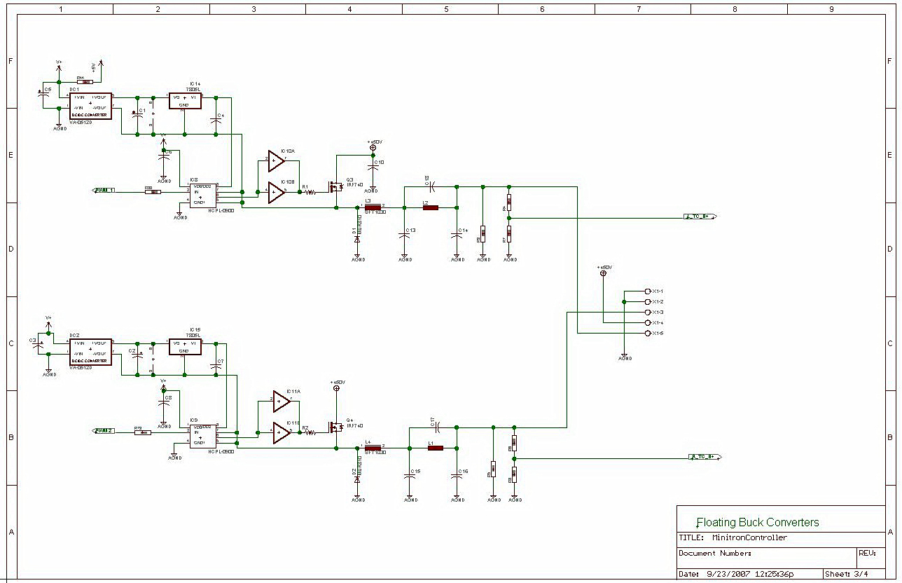

Page 3 is the modulated power supply. The dsPIC samples the two audio inputs and generates a PWM pulse train with a duty cycle equal to the instantaneous audio amp. This circuit uses those pulse trains to control two buck converters that step down the +450 volt supply to the range of +150 to +420 volts in step with the audio. Think of it as a mega SE class D amp. This voltage is the B+ for the aUdio output tubes. The output tubes get only enough B+ to keep from saturating at any given moment. This whole system operates at a 500KHz to 1 MHz rate.

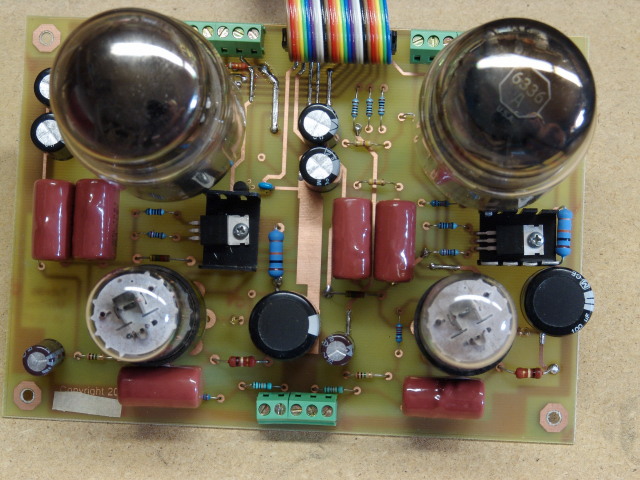

The schematic for the tube amp being controlled is shown. There are two conventional stages, abd a cathode follower output stage. A CF output stage was used since it has a very high PSRR. The ability to reject power supply ripple is needed to remove any DSP artifacts that remained on the modulated power supply.

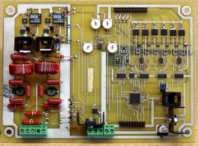

The amp and controller PCB pictures are included.
