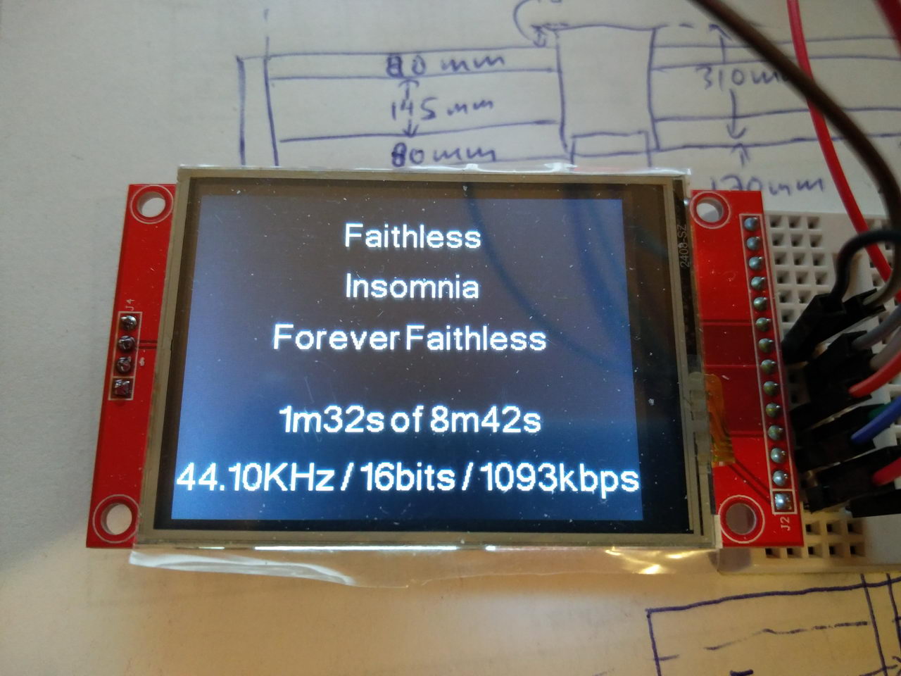

I didn't try with OLED but TFT works fine IR
So you modified the code to work with TFT?
I haven't tried remote functionality yet. I have other remotes that I cannot test, since debugging in OLED code doesn't work due to limited memory (I used up 99%).
Now this is interesting, it's a high res touch panel for as low as 5.2eur:
3 3V 240x320 2 4" SPI TFT LCD Touch Panel Serial Port Module With PBC ILI9341 | eBay
Unfortunatelly, it's dirt cheap for a reason.
Here is one I bought for one of my designs:
The viewing angles are pretty bad.
