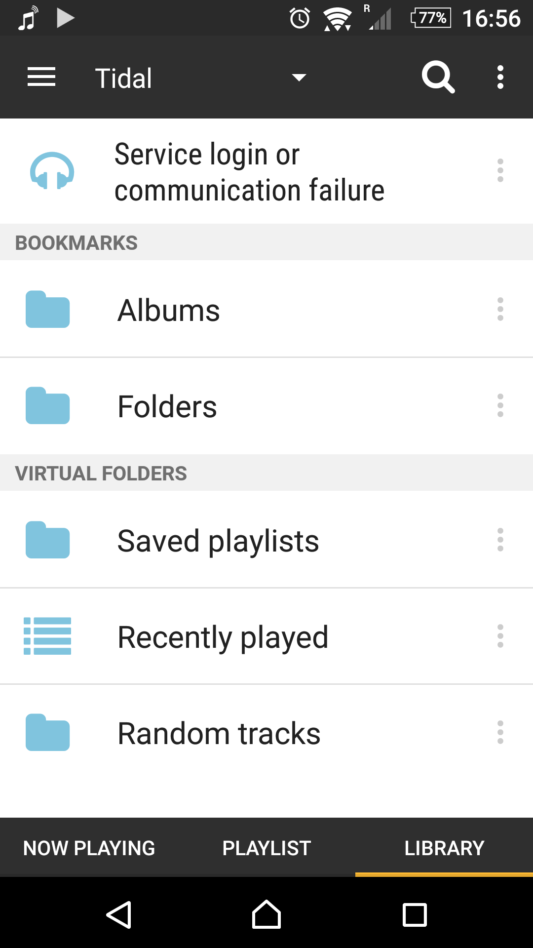

I have such settings but tidal dont works
# <grouptitle>Tidal streaming service parameters</grouptitle>
# <var name="tidaluser" type="string"><brief>Tidal user name.</brief>
# <descr>Your Tidal login name.</descr></var>
tidaluser = xxxxxxxx
# <var name="tidalpass" type="string"><brief>Tidal password.</brief>
# <descr>The password for your Tidal account.</descr></var>
tidalpass = xxxxxxxx
# <var name="tidalquality" type="cstr" "values="low high lossless">
# <brief>Tidal stream quality.</brief> <descr>'low' and 'high' are aac
# streams. 'lossless' is FLAC and will only work if your subscription
# allows it.</descr></var>
tidalquality = lossless

Rucia1, unfortunately I don't use tidal and I haven't tested it.
