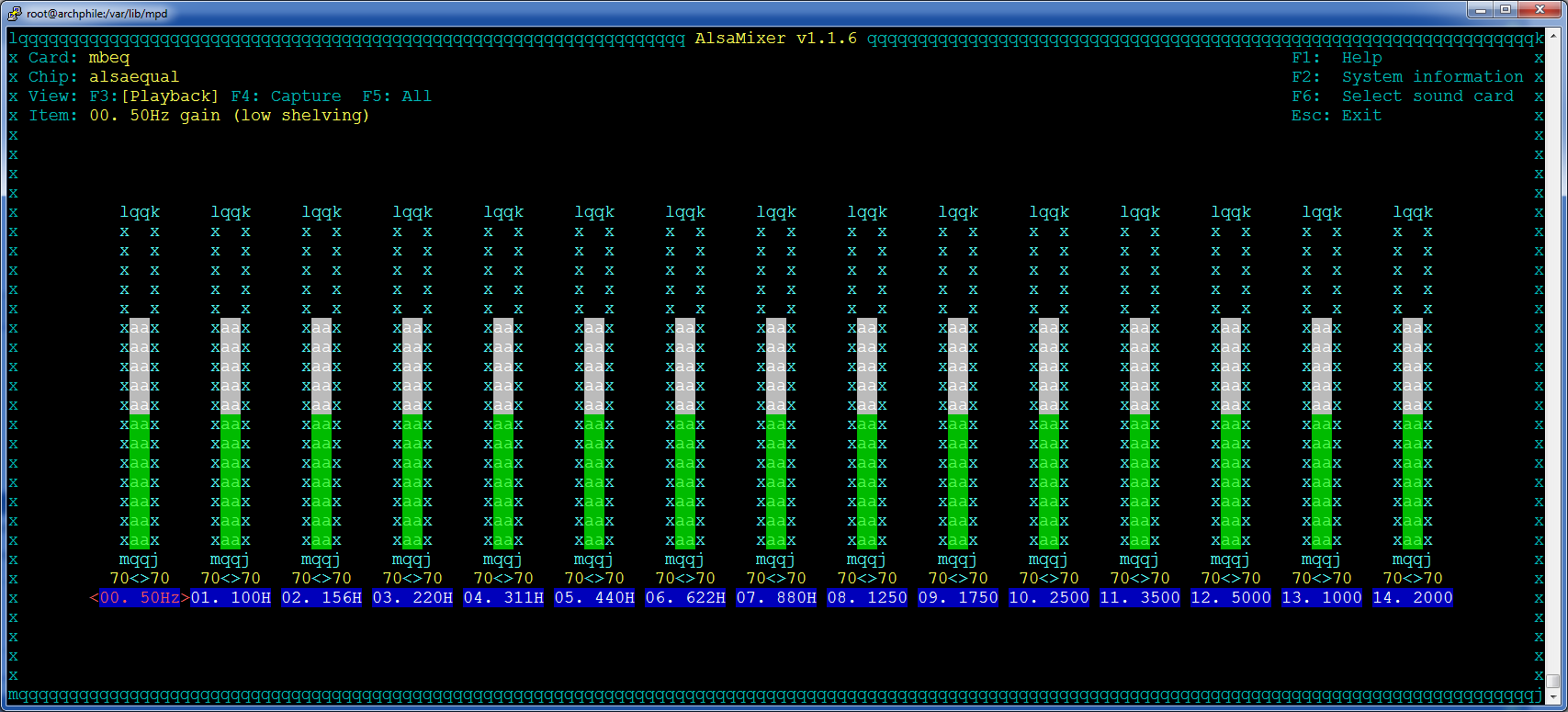

Does anyone know if alsa-equal (Equalizer) works (not necessarily supported) on v0.99.73? Has it been removed from the playground repo?
The short answer is yes. I sorted it myself with enough googling.
The key is to not upgrade any packages, but install packages matching the versions at the time of the ArchlinuxARM build that is used under archphile (v0.99.73 ~ 22/5/18). I found an archive on line.
With all of that installed, I was able to download the OLD playground package source and make and install alsa-equal.
I then added swh-plugins - which gives a 15 band equalizer.
Then made and installed the alsaequal-mgr - a bash script driven utility to allow saving and loading of equalizer settings on the fly.
Now I am going to write a script to monitor MPD track (actually folder level) changes and load an appropriate equalizer for those harshly engineered tracks I like 😉
I'll post up the process to get the above working and also the script if anyone else is interested.
Note: With all the above - you are not using hardware therefore losing bit-perfect playback. This is noted in the manual.
Below is a screenshot of alsamixer with ALSA configured to use the swh-plugins mbeq equalizer.
