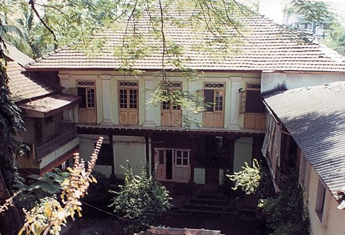

Yes, clay tiles almost never leaks and protects homes. Keeps the inside cool in summer too.<snip> It is just not logical to design a roof that does not naturally shed rain. Water is the most destructive natural element for houses. Sloped roofs with clay tile or slate shingles will last 100 years or more, with virtually no maintenance.

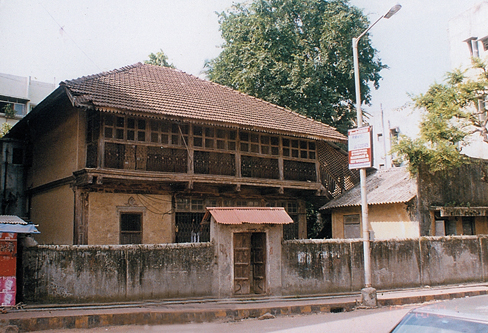

First building is 139 years old, second one is approximately 60 years old. Due to surge in real estate prices only these two homes have survived in my hometown.
Regards.
They've been replacing the roof on the Empress and its about a 100 years +.Sloped roofs with clay tile or slate shingles will last 100 years or more, with virtually no maintenance.
