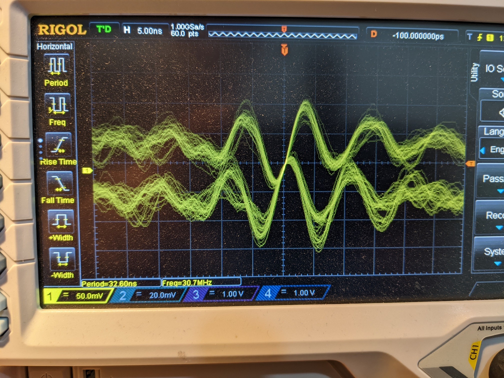

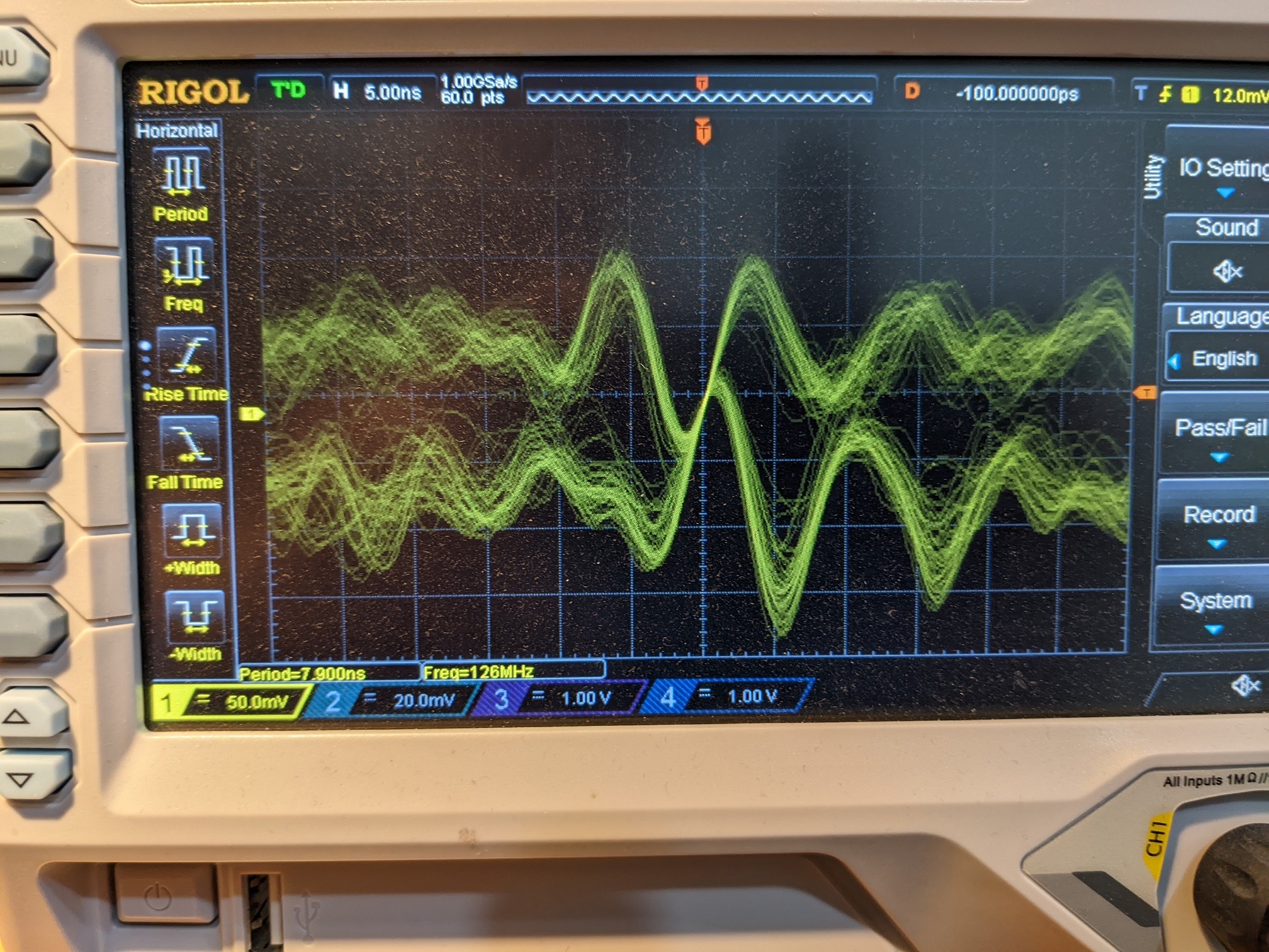

OK I made this video. When relay clicks it jumps and then slowly comes down. And as it gets warm some changes can be seen. Then I put my finger on the left channel test point TP16and you can see the "noise" gets smaller and bigger when I take my finger on and off the TP16.
I connected the probe to left channel output and Analogue ground. I have no idea what the reading are!
https://www.dropbox.com/s/t18ihezrg84e8s4/PXL_20220405_195122107.mp4?dl=0

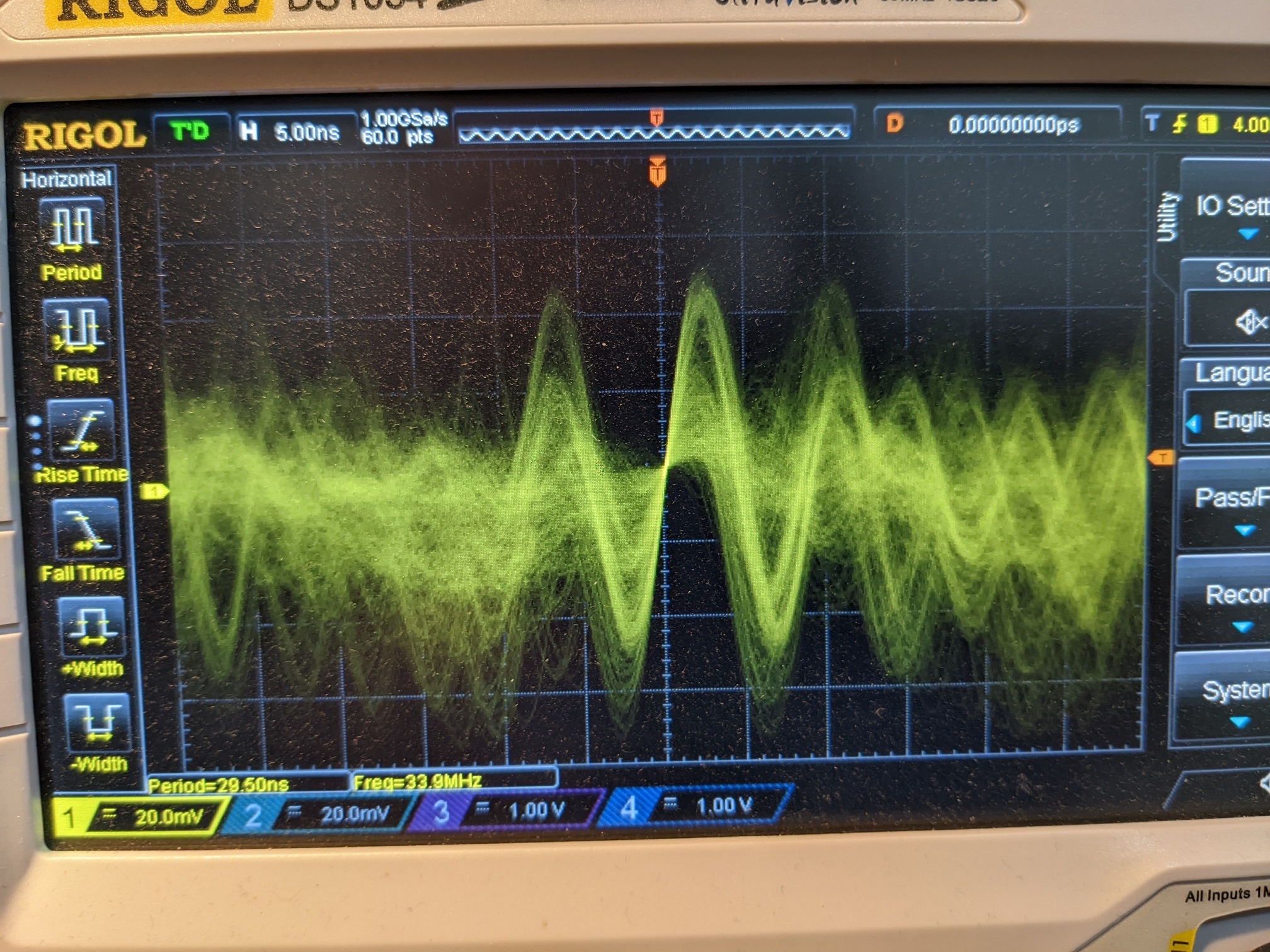

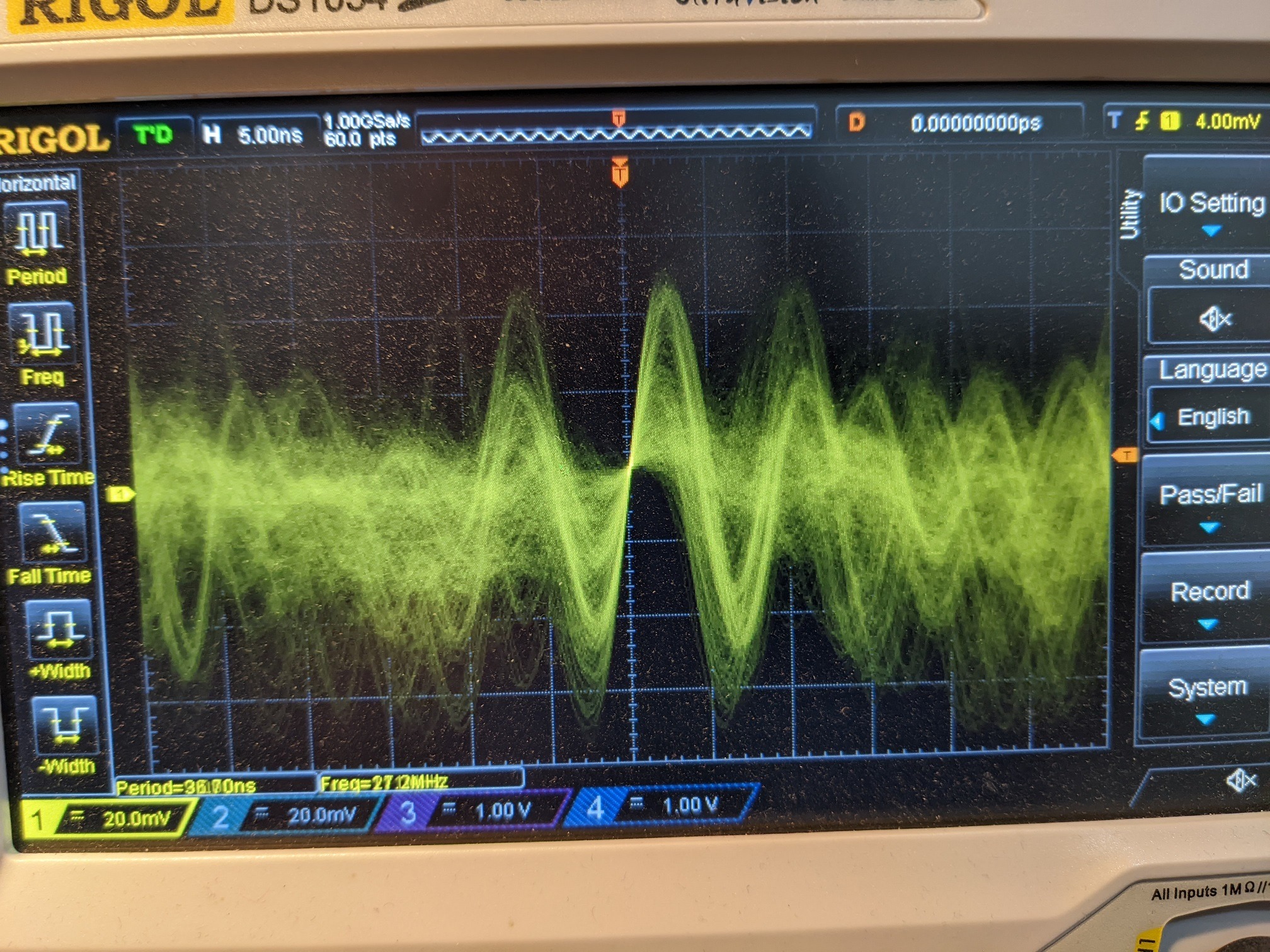

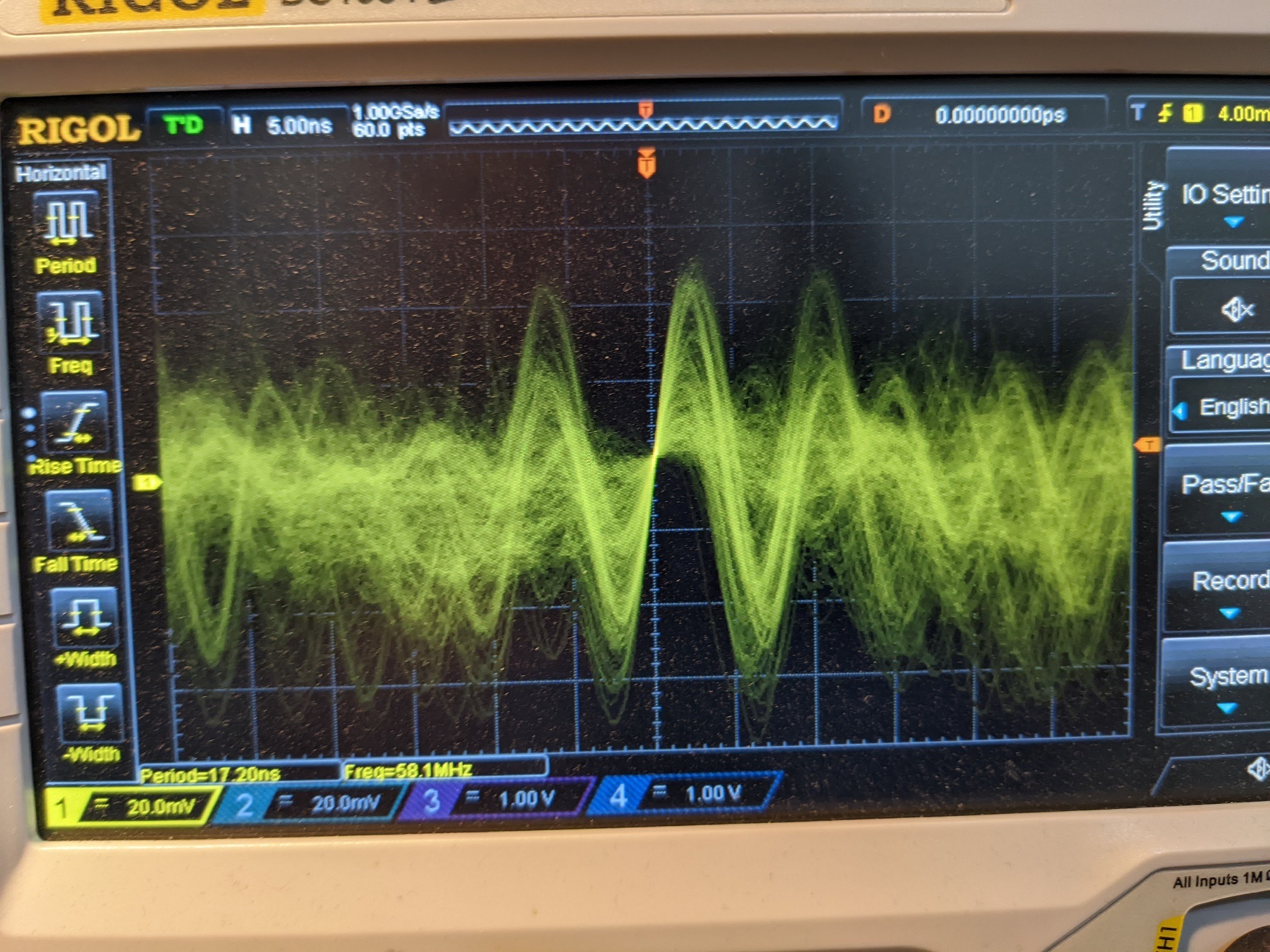

I have attempted what you have instructed. The frequency alters a lot as seen in pic. Please note the signal does change after being on even after a few seconds.
