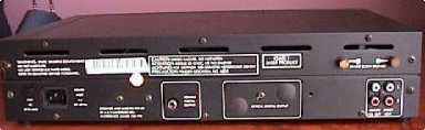

Re: Re: Transport screws
When the CD player was supplied new - it would have had two transit screws fitted underneath. They are screwed through two threaded holes in the bottom plate and make contact with the top plate of the CDM. They prevent the CDM from moving around too much on its suspension during transit.
Before use, these two screws are removed and should be stored in the storeage holes on the back plate. When you plan to transport the machine again, you should then re-insert these screws into the threaded holes in the base plate.
It is always better to use the transit screws if available - however, if they are misplaced, it should be okay to transport the machine without them if reasonable care is taken. I have received about 20 CD players with CDM2 and CDM4 in the post - without transit screws fitted - and all of them survived the journey.
Below is a picture of the rear of a Delta 70.2 with the transit screws in the storeage holes just above the RCA outputs on the right hand side. They look just like two knurled knobs. If they are there......unscrew them and find the appropriate holes for them underneath. They should be directly below the CDM.

Hi Fin
Thanks for the quick response. CDP is now being posted to me with the appropriate screws in place.
