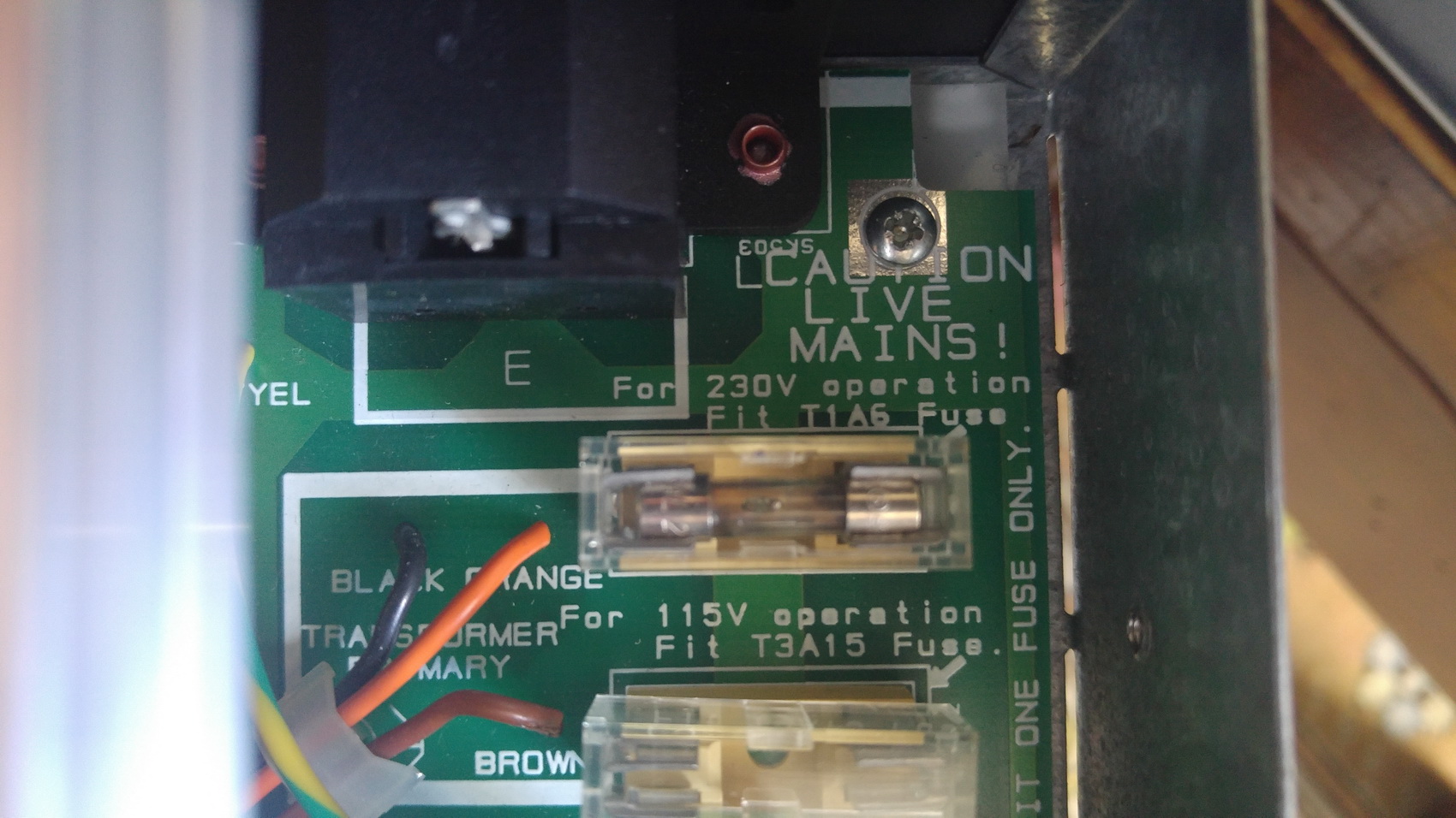

Are you sure you are using a Time Lag fuse? when you say blows when power is connected, I presume you mean at switch on....

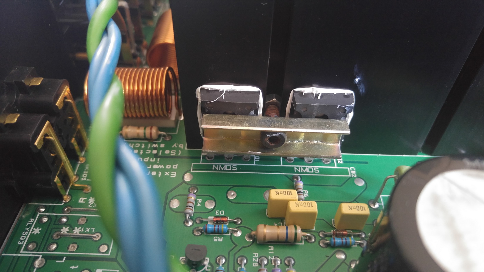

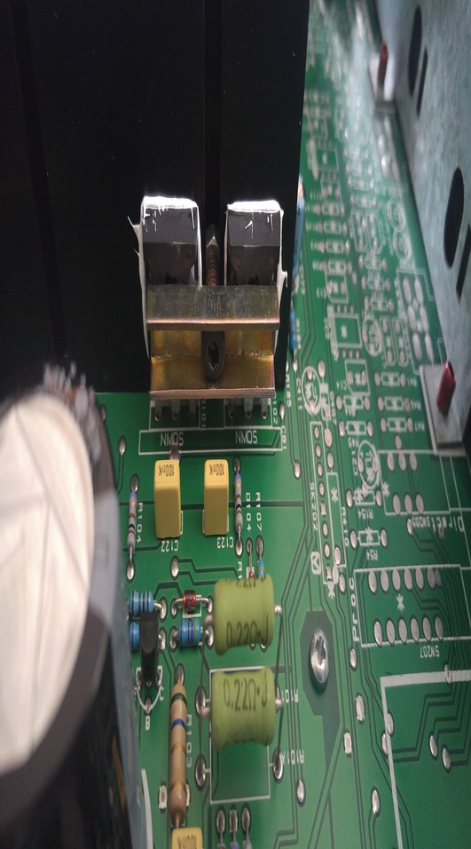

I measured them before removing. Set multimetre ohm check to 2000 and got following readings from each transistor, front to back;
[in this order, 1-2/3-2/1-3 (1 being towards back)]
813/245/569
1320/7k+/570
815/246/569
1323/7k+/570

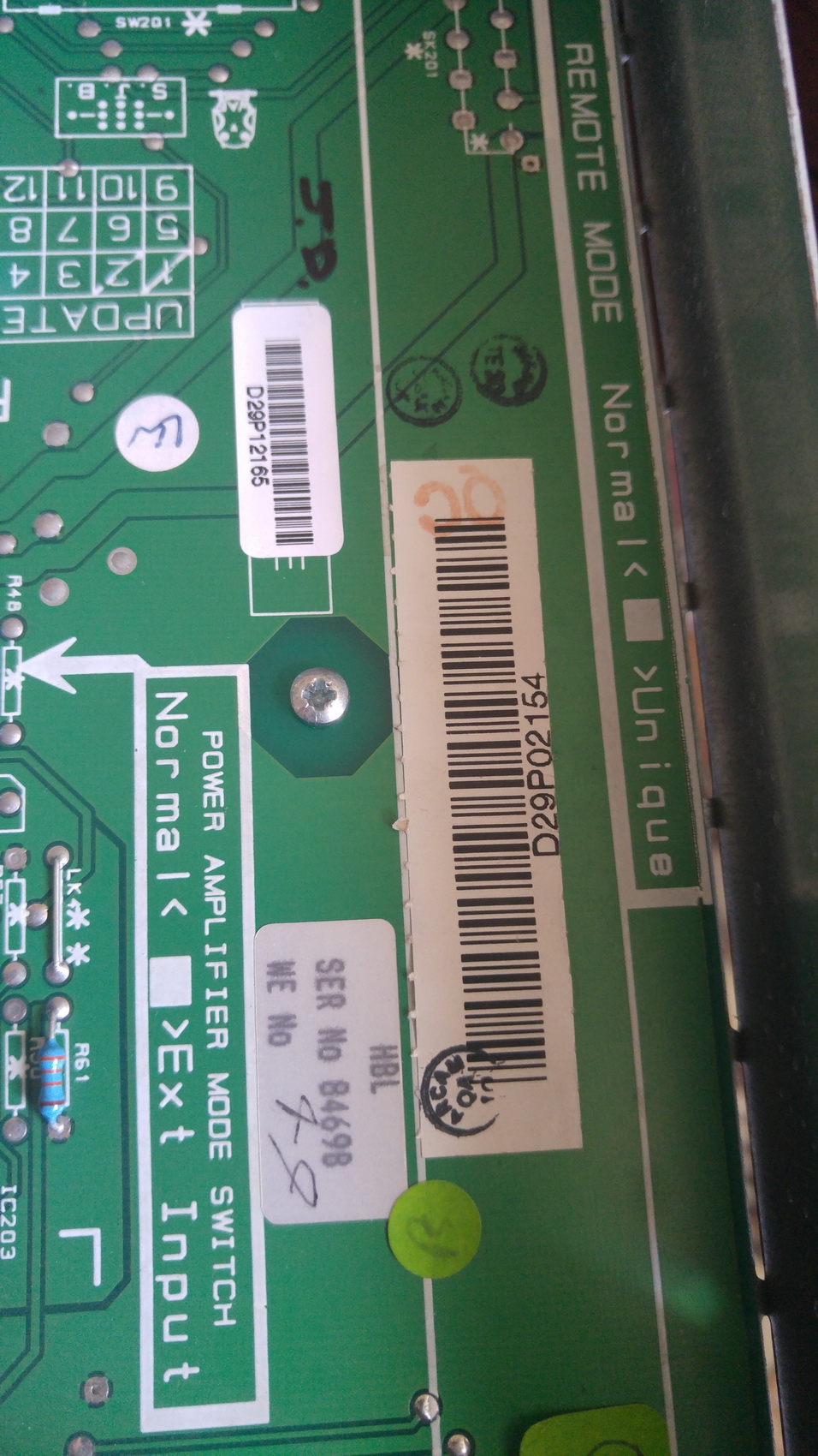

1. It is a power amp, 290P, number D29P02154; it never had SM042's;
2. I am pretty sure this amp has not been tampered with;

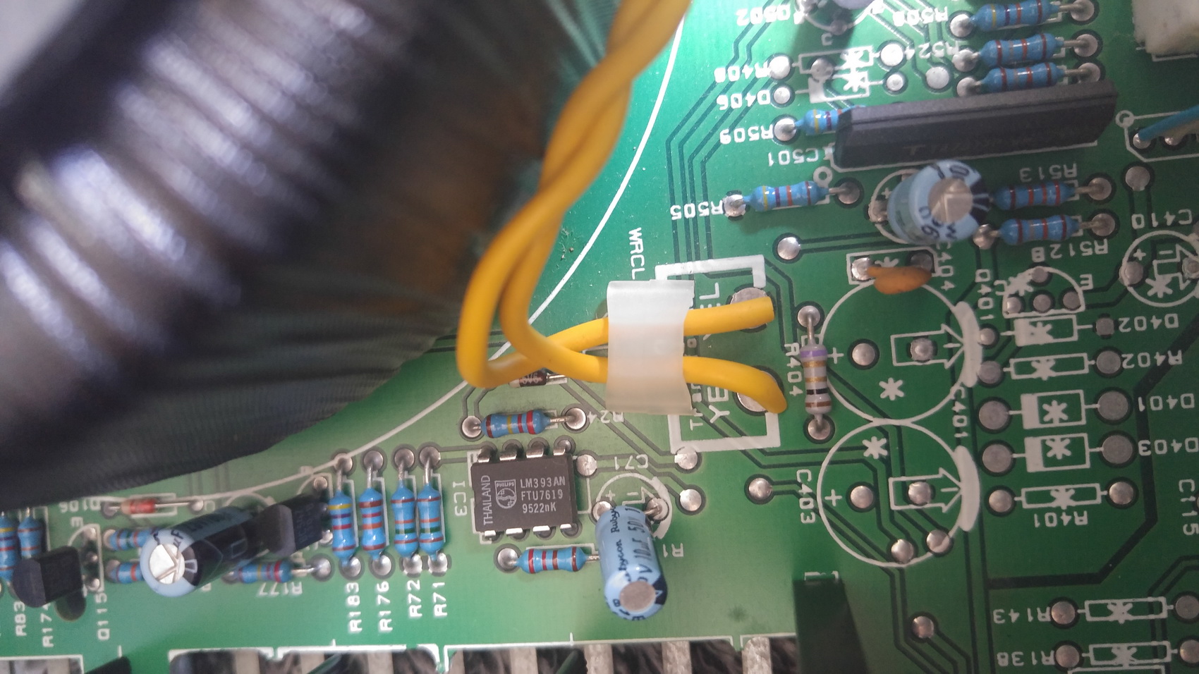

3. There is an LM393 between toroid and heatsink;
4. I am not sure if the transistors were faulty, they just gave dodgy readings when measured in place. They all measure consistently on removal, 701 to 711 between middle and right (no other combinations give readings when they are out of the circuit)
5. The T1A6 fuse is closest to the power input socket on the rear, orange and black wires;

LM 393 probably a modification/addition to the loudspeaker protection circuit. It would be useful to know for sure. Is it in your 290 as well?

If the LM393 is a known (stock) fault then these cost buttons but its much better to prove by measurement than replace in hope. We would need to see the correct circuit diagram though.
I guess this is where the LM393 mention was:
http://www.diyaudio.com/forums/solid-state/68635-arcam-delta-290-fuse-keeps-blowing.html#post827086

Mooly has linked to a 393 controlling the output bias current.
This seems to be an update that is not shown on the .pdf from HiFiengine.
I wonder if it's on an Alpha9 amp .pdf?

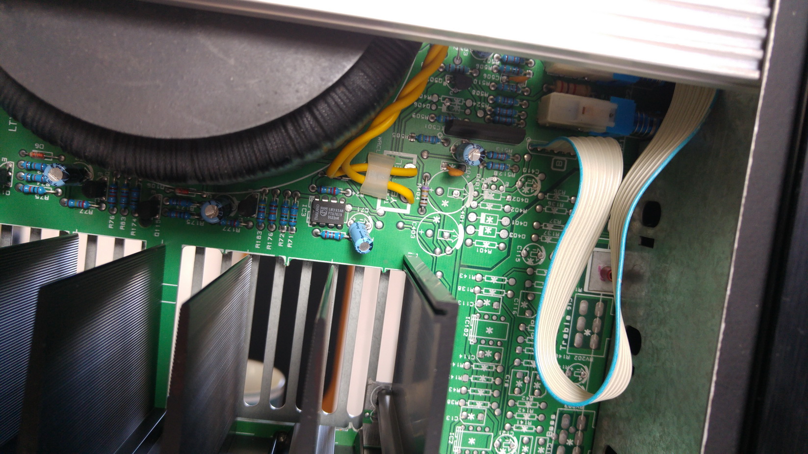

More images and update
Its a pity that there was no separate service manual for the 290P but it shares the same pcb and layout as the 290 so they didn't bother.
I am very rusty at my circuit diagram reading plus the seven diagrams at the back of the manual are not helping much. I think I need to look at the fourth one, "Power Amp & Amp PSU" 11-May-1993

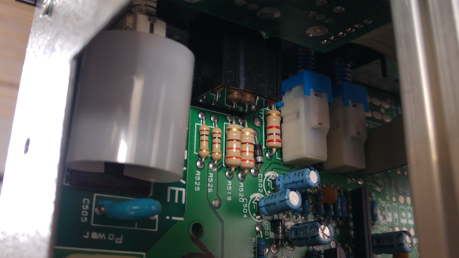

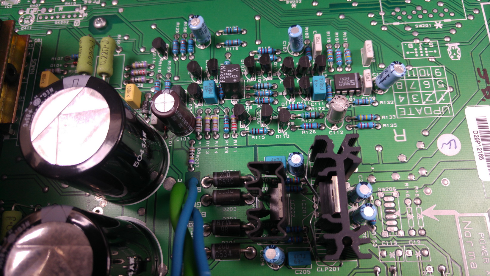

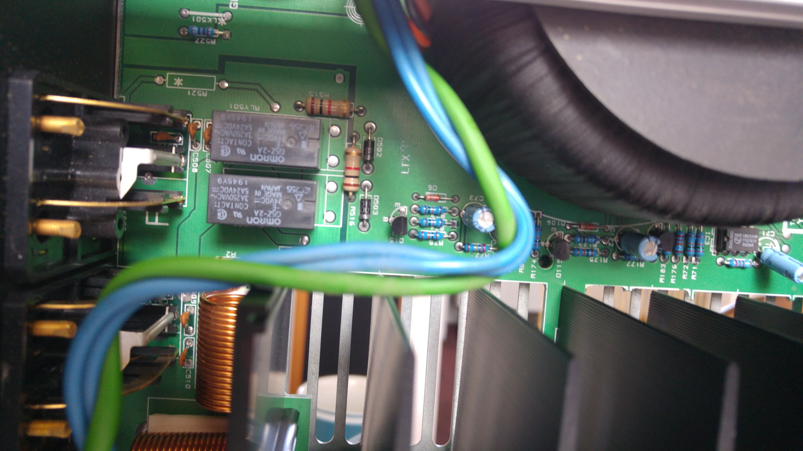

Here are some images of the board, first being the right channel circuitry.
I only have a M830-B Sinometer multimetre from Maplin, no other measuring/testing device.
