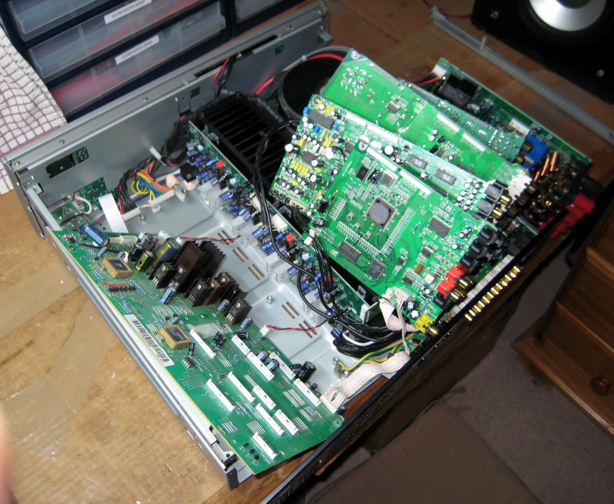

Normally any kind of hum is power supply related. Perhaps you didn't get all the faulty caps or there are still faults on the main PCB? I've never had one where the transformer is mechanically buzzing or humming.
I tried disconnecting the ribbon cables between the preamp riser cards and the amp boards, and the hum coming out of the speakers went away completely. I could tell the amp boards were still on-line because if I really cranked the volume I could hear just the faintest bit of amplifier hiss from the tweeter.
So I guess essentially the hum issue lies just in the preamp section, which means yes I think I missed some bad caps. Oh well, I'm gonna shelf this thing for a while and work on some other projects. Next time I'm going to make a digikey order, I'll scour the preamp boards for bad caps and try again.

Normally, even though the DSP appears to be faulty, it's just fine.
The DSP doesn't function, simply because the defective PSU is delivering unstable current to the DSP.
Therefore, in the vast majority of cases, you do NOT need to replace the DSP IC, or the blue relays, or anything else.
The DSP is the SYMPTOM - as in all technology, fixing the symptom NEVER solves the problem.
You need the fix the CAUSE, and here, the CAUSE is the PSU (the Main horizontal Motherboard).
