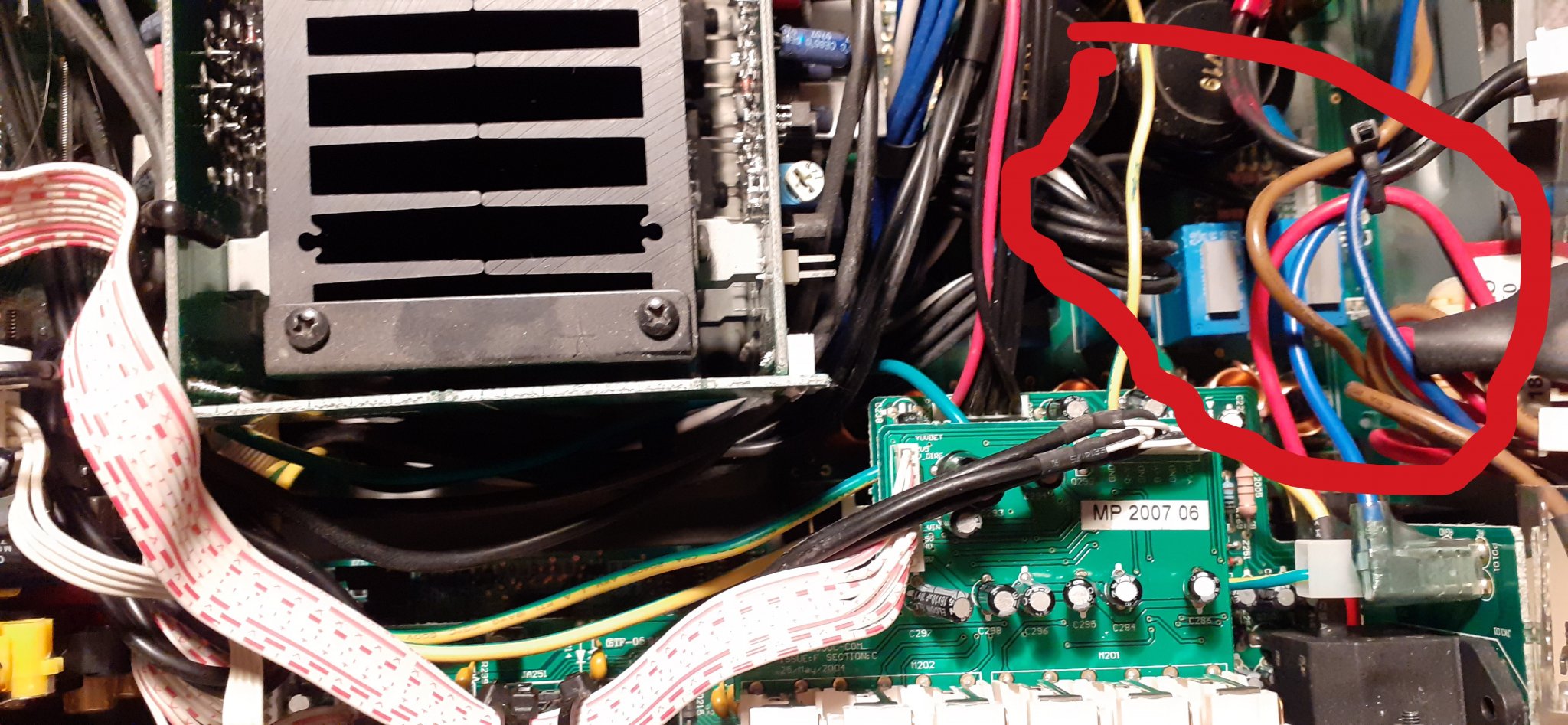

Yes, the click is loud and it's normal for them. They have a "smart" standby implemented by the EU regulations and if you turned them off with a remote you should also use the remote to turn them on ( I hope I got that right🙂 Later serial # of AVR350 had better implemented main board with properly spaced and soldered rectifier diodes and somewhat better caps (not by much). Those receivers suffer from early leadfree solder process. On couple of those old units I was able to pull the capacitors by hand. The solder joints were giving up so easily.

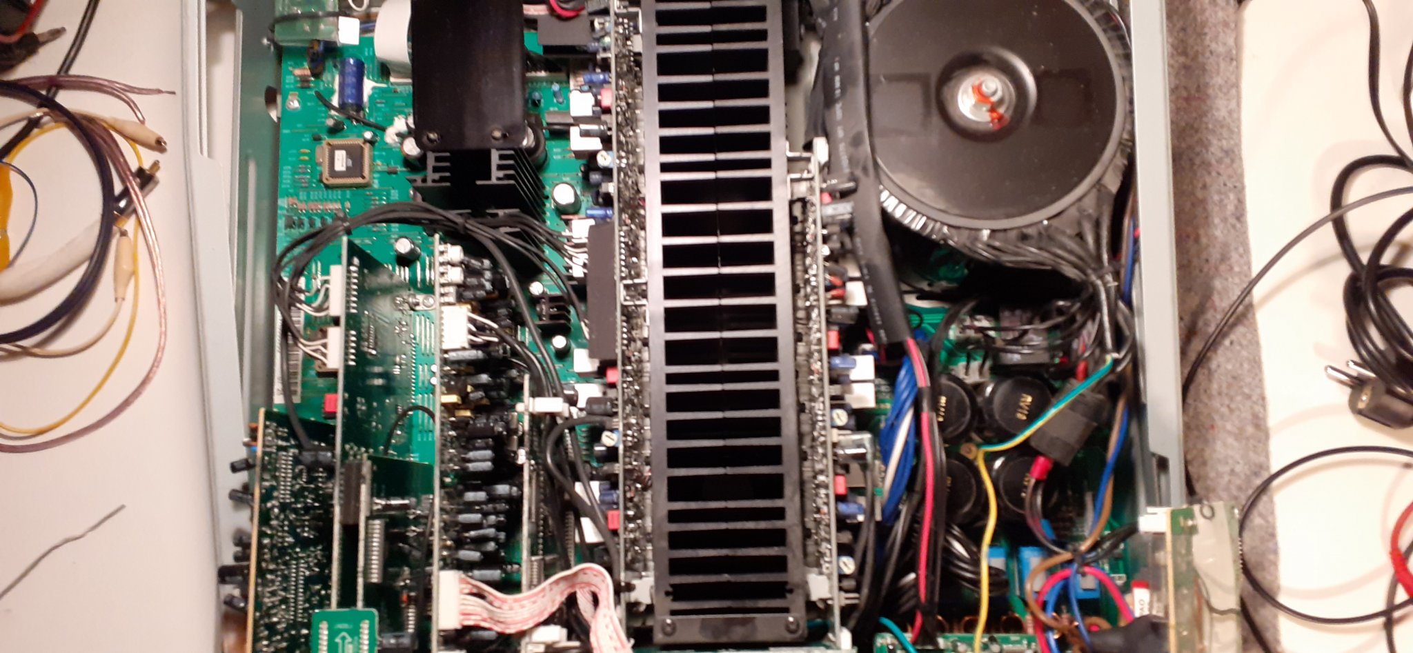

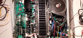

I tried disconnecting the ribbon cables between the preamp riser cards and the amp boards, and the hum coming out of the speakers went away completely. I could tell the amp boards were still on-line because if I really cranked the volume I could hear just the faintest bit of amplifier hiss from the tweeter.Normally any kind of hum is power supply related. Perhaps you didn't get all the faulty caps or there are still faults on the main PCB? I've never had one where the transformer is mechanically buzzing or humming.
So I guess essentially the hum issue lies just in the preamp section, which means yes I think I missed some bad caps. Oh well, I'm gonna shelf this thing for a while and work on some other projects. Next time I'm going to make a digikey order, I'll scour the preamp boards for bad caps and try again.

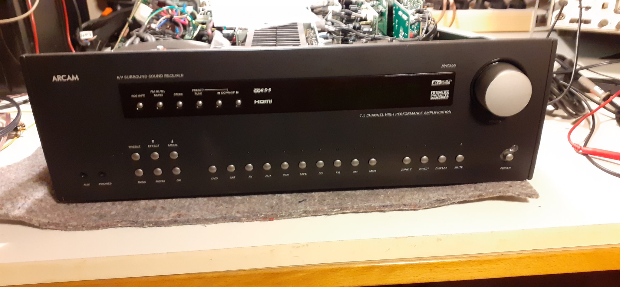

And now my AVR 350 started dropping one channel . It comes back after I turn it off and on, stays for a while and goes away. It does that in direct and DSP mode so its not a DSP board issue. Meh , 🙂)
I swear to god it's cursedAnd now my AVR 350 started dropping one channel . It comes back after I turn it off and on, stays for a while and goes away. It does that in direct and DSP mode so its not a DSP board issue. Meh , 🙂)
Check the audio sheilded audio cable sockets/connections to/from the main amp/preamp PCB. There are sometimes dry joints on these sockets that can cause channels to cut in and out.And now my AVR 350 started dropping one channel . It comes back after I turn it off and on, stays for a while and goes away. It does that in direct and DSP mode so its not a DSP board issue. Meh , 🙂)

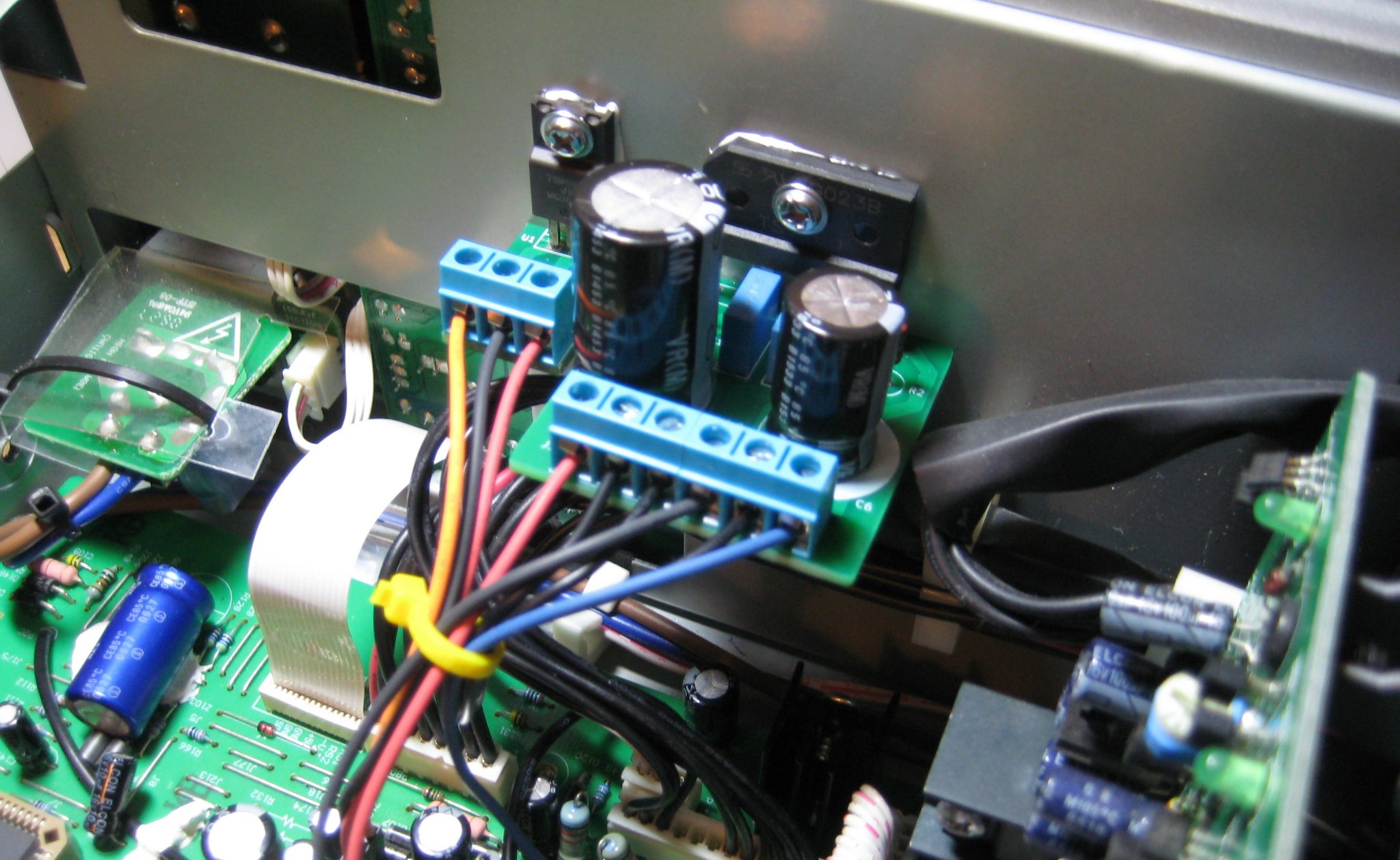

http://www.condoraudio.com/wp-conte...350-AV-Receiver-Audiophile-Upgrade-Repair.pdfThey do sound pretty nice when working actually. Google the problem . There is a guy in Israel who had a nice write up on this series of Arcam receivers and the bugs. I've got a mint AVR350 with all the factory packing and accessories for free because it was malfunctioning and the owner deemed it obsolete (true) and therefore not worth of the repair cost (also true ) I corrected DSP board PSU supply and its a base of my GF HT system . Works great

Normally, even though the DSP appears to be faulty, it's just fine.
The DSP doesn't function, simply because the defective PSU is delivering unstable current to the DSP.
Therefore, in the vast majority of cases, you do NOT need to replace the DSP IC, or the blue relays, or anything else.
The DSP is the SYMPTOM - as in all technology, fixing the symptom NEVER solves the problem.
You need the fix the CAUSE, and here, the CAUSE is the PSU (the Main horizontal Motherboard).
It's that simple.
