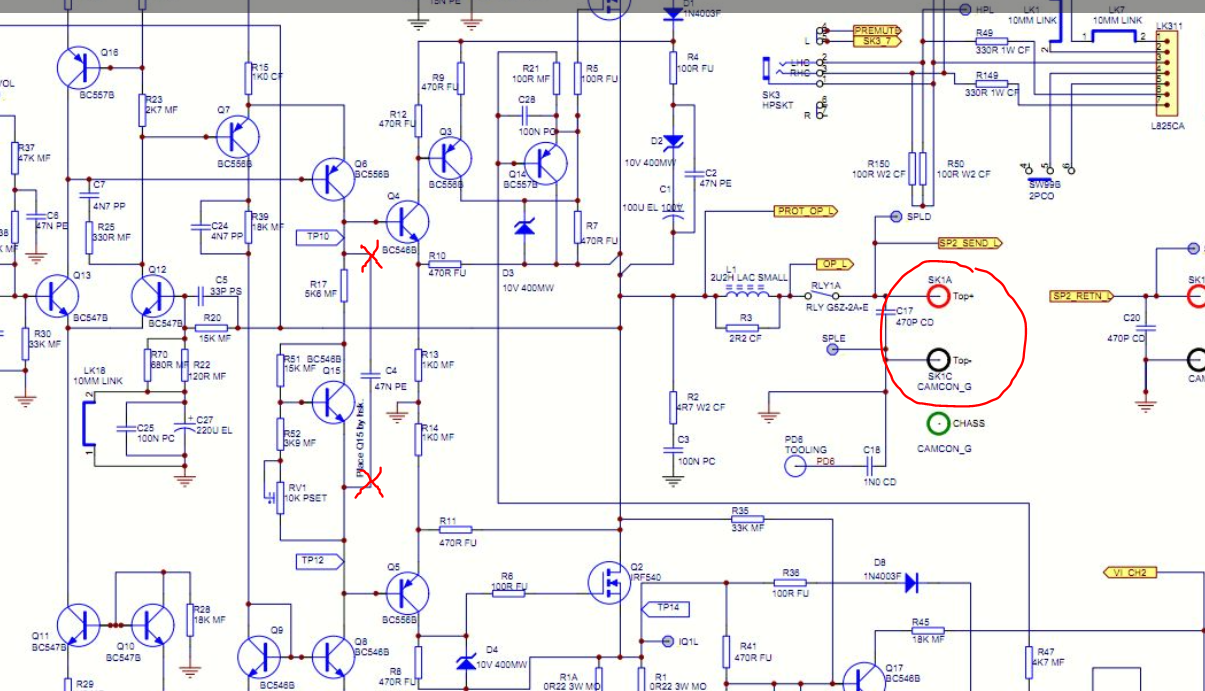

As that did not work decided to remove Q4/5 again to see if I could isolate which is the problem channel. Amp powered up and lamp went out. So it must be an issue with the left hand stage.
I also removed both IRF540 on the left stage to check to see if there is any issue with them now (even though both are new), both appeared to work OK when doing a diode test on the source and drain then applying the positive to gate switching on the device. By touching the drain and the gate the charge is released and the device is off. Thought this might help.
OK, a couple of possibilities here.
Firstly make certain that the transistors you have replaced are in fact all the correct types and fitted correctly.
You've tried one channel and the bulb lights. Try the other channel in the same way and see if that behaves the same. Its unlikely you would have a genuine fault on both channels.
Its possible there isn't actually a problem at all at this stage and that the current draw of the amp is just tipping the bulb over the point at which it lights. We need to be sure though and that means some real test and measurement.
The voltage between TP10 and TP12 (so that's the voltage across R17 at the moment with the transistor shorted) determines how hard the output stage conducts.
I would expect around 1.5 volts between those two points but can you check it.

Thanks for the reply, the bulb is the old style 60W homebase one I found in the spare bulb draw 🙂
Just want to make sure I have explained myself well, I rebuild the circuit with all 4 transitors in, on turning the power on the bulb lite and was on, the relay did not do the big click and the led did not change to green. I triple checked the transitor types before soldering them in. I have also tested them on the Hfe on the DMM and they work showing their gain outputs.
By removing the LH transistors for Q4/5 but leaving in the RH stage ones in the Amp powered up as expected. Nice loud click from the relay and the led went green.
This evening I will resold the Power Transistors Q1/2 and Q4/5 then I will remove Q104/105, with the 60W bulb in place power on and see what happens.

60 watt is a bit on the low side. The bulb allows current to be drawn and up to a certain point stays cool and presents as a low resistance. As the filament heats its resistance increase dramatically thus limiting the current (and lighting the bulb).
I don't know how good your desoldering and soldering skills are but the one thing we need to avoid is damage to the board and print, however... if you are confident in your abilities 'swapping' what are doing between channels is good method.
It sounds like the right channel is basically functional and you could try that one channel with a speaker and music at this point (very low level).
And as I mentioned, its quite possible there isn't a problem now and that its just the bulb tripping things up.
If you have a 100 watt bulb use that, or if you have another 60 watt then tag that in parallel to the 60 you have.

Can you measure and compare the voltage across these two resistors. On my diagram that's between test points 14 and 15. The voltage will be very small, perhaps only 10 millivolts or so.
Both channels should be similar.
Also the voltage across the speaker outputs should be near zero. The relay has to click and engage for that to be measureable.

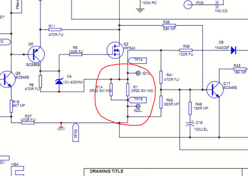

Also checked voltage across R01 and R101, R1 is 0.14v and R101 0v. Also the IRF540's on the LH side are warm and the RH are cool?
The left channel is drawing significant current.

RV1 should have no volts across it because we have the transistor shorted out. If you are seeing voltage across it (across... that means one meter lead on each end of the preset) then something is amiss with the print in that area.
Make sure you have no open print in that area. The voltage between the two crosses should be similar for both channels.
Make sure that with the transistor shorted that you can measure continuity from the top of R17 to the base of Q4, and from the other end of R17 to the base of Q5.
Keep referring to the diagram and it will make sense.

My final post for the night, checked R17 and R117 , they read 4.25v and 4.32v. R1 and R101 are both in the very low mV range. Bulb goes out after initial inrush glow.

When you are happy with the soldering and that all the joints are sound then we move on to adjusting the bias current. The manual should give a procedure and a value but what it comes down to is adjusting for a given voltage across those low value 0.22 ohm resistors R1 and R1a.
A typical current would be around 100 milliamps and that would mean a voltage of around 10 to 11 millivolts across those resistors.
Here's the method.
1/ Be 100% sure you are happy with all your work so far 🙂
2/ Remove the short from the transistor on just one channel.
3/ Set the preset such that it is at maximum (10k) resistance. You can check that by measuring resistance between the base and emitter of Q15. Because of interaction with other parts you wont see full 10k + the 3k9 of R52, but you will be able to gauge which direction gives the highest resistance. Try it with the meter leads both ways around as well.
4/ Switch on and monitor the voltage across those resistors R1/R1a (meter leads directly across them).
5/ Adjust for around 10mV (0.01V). The bulb may start to glow a little.
6/ If that is OK then turn the preset back down again.
Leaving that channel repeat the procedure for the other channel turning the current back down when you have confirmed its going to be OK.
Now we remove the bulb and run on full mains and set the bias to the required value. Monitor the current as the amp warms. Its normal for the bias to wander a bit.
