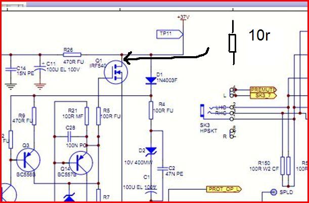

The parts finally arrived. I installed them all. I hooked up a 60watt bulb across the fuse terminals. I turned the trimpots all the way anti-clockwise. I hooked up my meter across R101 as the service manual says. Plugged in the power cord. Press the power button. And the moment of truth...
The bulb glows brightly for a second, then goes out. Was it supposed to glow at all? I don't know. At least it doesn't seem to have blown the outputs again. The power LED on the amp glows orange for a few seconds, then green, exactly as it should, indicating normal operation. The power relay makes a soft clunk. Just as it always does when powered on. Everything looks like it is working as it should. Now I am supposed to adjust the trimpot to read between 2.3 and 2.8 mv across R101 so I very slowly turn it. No response on the meter. Adjust meter setting downward. My meter only goes down to 1 volt! How can I read 2 millivolts with this meter? It only has DC volt settings of 300up, 100, 30, 10, 3 and 1.
I could turn the trimpot back to where it was (I had made a little mark) and take a chance but that's probably foolish.
So here is the situation; The amplifier seems to be working but I can't set the trimpot to the proper voltage. Maybe there is a way to put something else in the circuit between the test probes that will change the scale of the meter? Probably not accurate enough. I don't know. Kinda stumped here...

OK I've ordered a meter. Another 2-3 weeks wait. Unfortunately the lowest range on it will be 0-200 mv so I don't know how accurate it will be down at the bottom end of the range but maybe it's not that critical? I was unable to find a reasonably priced one with a range of 0-20mv or even better 0-5mv. Hopefully high precision is not needed. Thanks for the pic Jaycee, I used it as a guide for ordering.
200mV range will be plenty for setting bias. It doesnt have to be EXACTLY 30mA, just close enough.
tiefbassuebertr, i dont think there is anything really special, but these amps do have pretty small heatsinks so there is not a lot of dissipation for high bias currents. Having said that, they sound pretty good to me with only this "low" bias.
You could probably add a 10 ohm here and adjust for 0.3 volts across it which would equate to 30 milliamps.
Make sure you finally set the bias with the full mains voltage applied, not via a bulb. But try with a bulb first.

Hi again Mooly and jaycee. My meter finally arrived and setting the bias was a piece of cake. I removed the bulb, hooked up speakers and with minor trepidation turned it on. It works perfectly! Thanks very very much to you both for all your help. I really would like to express my appreciation. It was a great learning experience as well. The cost of having an electronics shop do the repair would no doubt have been prohibitive so thanks to you for saving this excellent amplifier.
