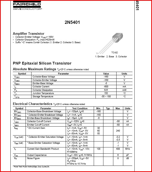

O.K. then, -36 on outputs and -36 on Q7/8 collector points at Q8 and maybe Q7. The reasoning is, if Q8 went O/C then Q7 would be turned on via R24 and pull the outputs hard negative. Similarly if Q7 were becoming very leaky when hot it would also pull the outputs down. The transistors that fail, particularly intermitantly are the ones that run hot 99% of time.
That points at likely Q8, in that case - I'll be checking the voltages, and voltage drops as soon as I can and report back with details. But Q8 and Q108 do run hot when it's running and working as it should (too hot to leave a finger on for a long time). Q7 and Q107, by comparison, are relatively cool.

When you take a step back, and look whats going on I am still sure it's Q8, Q7 Q11 or Q12 thats playing up. If Maplin have in stock the 2N5401 and it's complement 2N5551 it's worth getting a couple of each, they will work as the drivers.
