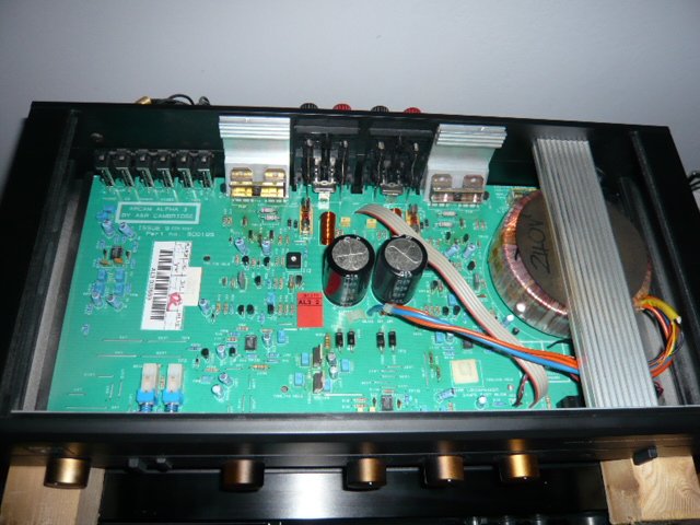

In fact, further to this, the main power transistors for the left channel do appear to be running a lot hotter for the left channel (the dodgy one) than the right channel, so perhaps there's still a problem lurking.
I can leave my fingers on the heatsink for the right channel for several seconds without a huge amount of discomfort, but less than a second for the left heatsink (I think I need a temperature probe rather than my fingers!). This is after the amp has been running for a couple of hours.
I'll check whether it's 9mV across R41/R42...

Worth checking, read my edited post above re LED. The bias setting is going to be "critical" I think on this design. I think it will vary quite a bit so dont get hung up over the fact you set it to 9mv and a few minutes later it's at 12 say, thats just the way it is. Without thermal compensation the output stage can suffer thermal runaway, the outputs heat up vbe drops , it conducts more gets hotter and so on. Keep tweaking the pots on both channels untill it settles at around 9mv, and from cold this may take 30mins or more.
Reread your post, 1 second, thats way to hot. With it being an old amp the preset RV1 may be dickey. With the amp off give it a squirt of wd40 ( not a squirt a drip ) and spin it to and fro a few times, or better still replace. To make sure no disasters happen put the bulb back, and readjust. You must start with the pot at MINIMUM resistance as this give the lowest bias current.
I'm just waiting on the 30 mins to let it really warm up before doing some proper voltage checks.
After 10 minutes, the voltage drop for the right channel (across TP14/TP15) gives 25mV, but for the left channel (TP12/TP13) it's 90mV, so they're both quite a bit out at the moment.

You've found the fault, I'm sure. Ohms law, 9mv across 0.44 ohm is 20ma. Power I*V 20ma @37 volts per transistor is 0.74 watts.
90mv is 0.2 amp or 7.4 watts per transistor. No wonder it's frying.
Clean the pots and see if it all sets up O.K.

Well, so far so good... I've switched it off, given both RV1 and RV101 a good swizzle both ways, to clear them, and reset to just under where they were.
The power transistors are now running pretty cool, and I've tweaked them both to get 9mV as close as I can for now - I'll double-check it later once it's been running for a while.
R40 and Q8 (and R140 and Q108) are both still running warm, however. Too hot to hold a finger on for longer than a few seconds.

Indeed, something more was definately wrong. Was upstairs for half-an-hour, while the hi-fi playing away downstairs.
Left output fuse has blown, and (presumably prior to the fuse blowing), the woofer of the left speaker has blown. In addition, the right channel has started to get the scratchy sounds.

Oh dear, thats a shame, this is what happens when you leave speakers connected to an amp with a DC offset problem. This is what I was hoping to avoid by suggesting the LED to indicate if there was a problem.

FYI, we now have (which you probably have already guessed) -37V on the speaker output terminals after replacing the fuse.

Back to your Arcam, as I hinted at earlier I found it very strange that there was no thermal compensation but there isn't. This makes the setting of RV1 very critical. Its probably easier to solder some wires to TP12/13/14 &15 and connect these to the meter. This way you can keep an eye on the readings while tweaking the pot. Did the pots feel "loose" might be worth replacing. Do all the output transistors share a common heatsink. If so the two channels will interact, as one warms up, it affects the other.

The pot for the left channel did feel loose, compared to the right channel - the right channel is pretty stiff to move.
Each pair of output transistors for a channel shares the same heatsink (i.e. Q13/Q14 are on one heatsink and Q113/Q114 are on another). Each of these heatsinks is on either side of the speaker terminals, and is bolted to the metal casing at the rear. The lid screws into the two heatsinks, so they are kind of joined... but not a lot! Actually... see the picture attached (the blocks of wood are because I'm waiting on some new rubber feet at Maplin - the old ones had turned into a gooey mess - heat related, maybe!)

Grrr... just thought I'd do a quick test - switch the amp on with the probes in the speaker socket (voltage -37V) and twiddle RV1. I figured that if RV1 is a bit dodgy, then a quick twiddle should would make a good contact and 'fix' the problem - indicating that that RV is in need of replacement.
Guess what... voltage at the speakers is now 0V, not -37V without twiddling it.
