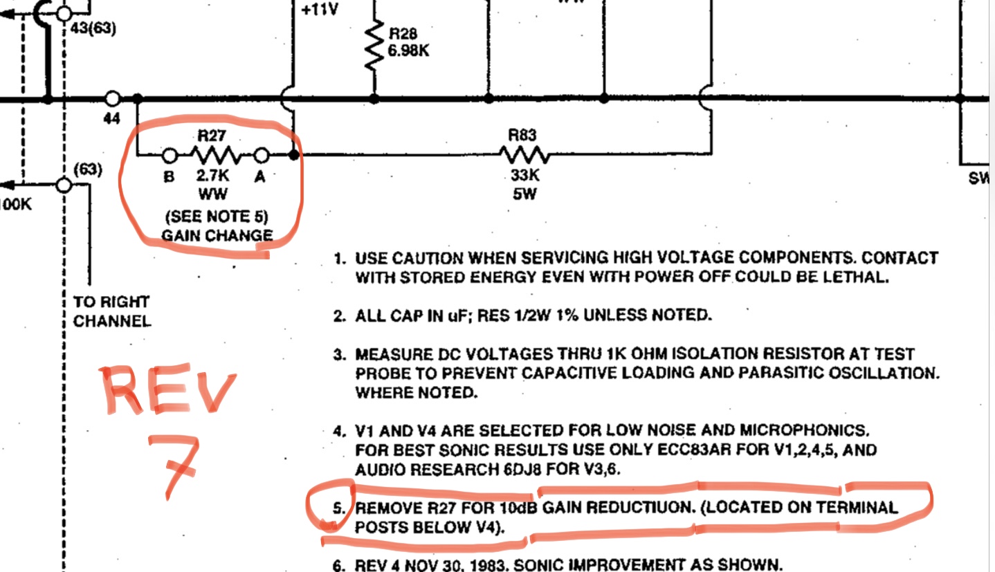

I think the notes on the schematic say to add an additional 39.2K resistor in parallel to the current feedback resistor to reduce gain by 6dB?
That’s an old diagram. Pls see attached picture for revision 7.

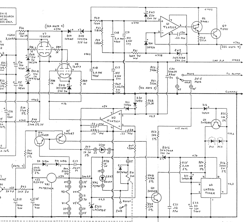

While the preamp now operates, the V8 tube (12AT7) overheats dramatically. The plate glows orange and pulsates, indicating some type of LF oscillation happening. Curiously, the unit arrived with an ECC83 in this socket instead of the 12AT7 called for on the diagram.
The overheating is likely caused by U2's output (supposed to be 16V) being actually 21.6V. Since this is a feedback circuit, it's a troublesome one to troubleshoot. I've already replaced U2, but that's not the cause.
Basic diode check of all the diodes found no other bad diodes. My plan is to start looking at the components around U1 next, but if anyone has any time-saving suggestions along the lines of "I've seen this exact problem and the problem was xxx component" I will thank you for that. Time is money!

V8 in the schematic I have shows a 12AX7. Pop one end of the 1000pF C34 out and see if it measures as a dead short. The SP-8 I fixed had similar problems to yours and this cap had failed and done a lot of damage. This may be starting to happen and pulling up the DC voltage at the non-inverting input of U2.
Thanks. My schematic shows 12AT7, but the unit came with a 12AX7, so it's useful to know that some versions use this.
I'll check C34... only finding 2200 and 750 polystyrene caps on this board and no 1000pF cap connected to pin 3. None of the poly caps show continuity with pin 3 U2.
I have 6.9V on both pin 2 and 3 of U2, but 21.6V on the output which should be 16V.

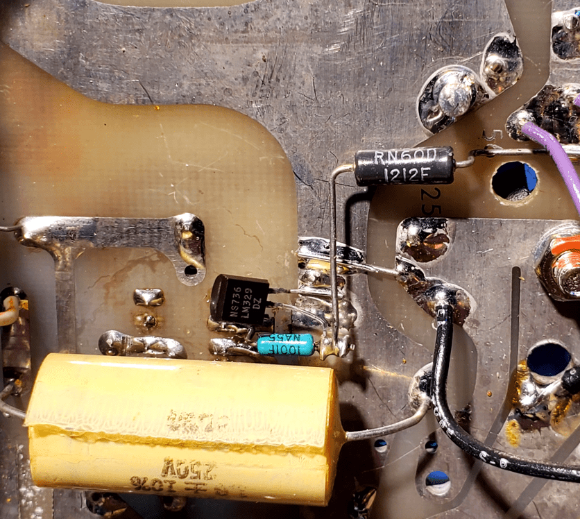

This unit has quite the modifications done to it. No doubt these are related to the problem of U2 output being 20.6V instead of 16V. Two terminals of the LM329 are used, the third is cut off. The 1000 ohm resistor is going to pin 3 of U2. Then the IC to and to ground through IC. The 12.1 K goes to a point that sits 13 ohms off of ground. This is NOT what's on my schematic.
Anyone know what this modification is?

I do feel a desire to "simplify" this monstrocity a bit, but my overarching philosophy is to get it working properly to spec. My latest measurements today indicate that the voltage on pin 3 of U2 is slightly low at 6.5V. Schematic shows 6.9 on both 2 and 3 pins. So now I'm pulling and measuring R51/52. I tried trimming R52 with a 1 meg resistor just to see how it affected the output and it pushed it up toward 23V from the 20.6V it was at. So I'm gong to measure R68 next. Maybe if I trim R68 until the output of U2 is at 16V required, that may be good enough, I don't want to run up the hours if I can avoid it.
