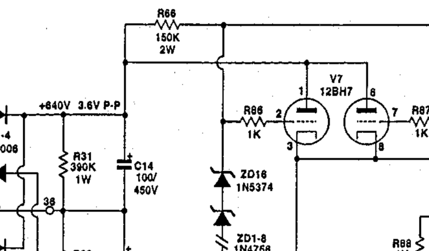

Replacing parts comes only after a tentative diagnosis. First, check each section of the supply
in turn, starting with the voltage on the Zener string, which should be 394VDC.
Next, check the output of the 12BH7A cathode follower, which should be 402VDC.
The symptoms that you observe are caused by the failure of the power supply to properly regulate.
The audio circuit is oscillating at a subsonic frequency (motorboating) because of this.

“Zener string” - is that the zd 1 through 8?

Right, measure the voltage at either pin 2 or 7 of the 12BH7A grids.
The meter ground lead connects to the chassis.
This is the reference voltage for the regulator, and must be correct for it to work.
If the problem was intermittent at some point, this indicates a bad connection as most likely.
Look over all the power supply board connections carefully, especially ones that get hot,
like on the Zeners, tubes, etc. Could even be an oxidized tube socket pin connection, clean them.

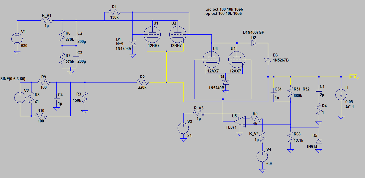

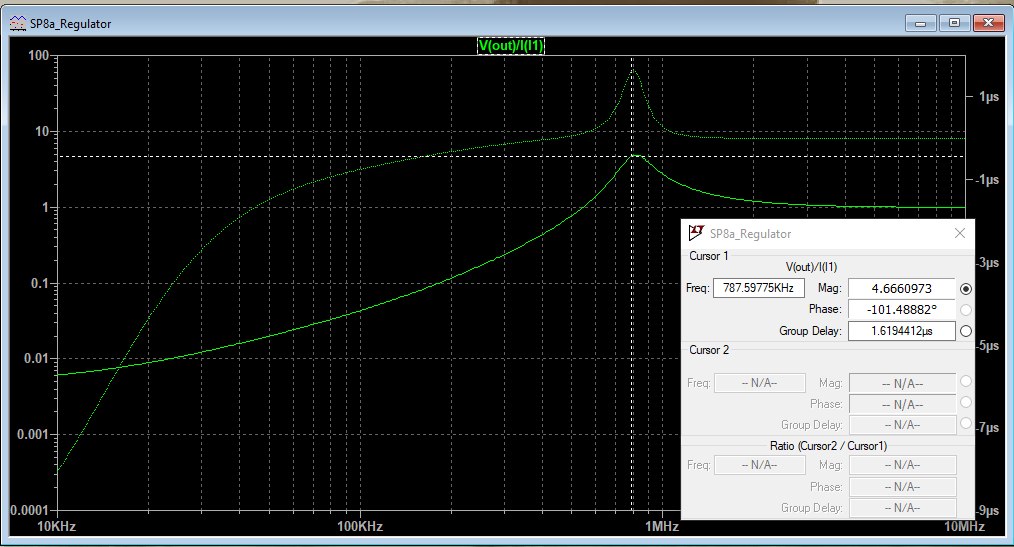

I have a later model SP Preamplifier -- the HV transformer windings burned out, I took the schematic from posted #1 and ran an impedance analysis. "Q" is equal to Group Delay * Frequency * PI = 1.62u * 788kHz * PI = 4.0, and Phase Margin is approximately 14.3 degrees.
Just a simulation, haven't done it on the bench:
Hi. Thx. So what does it mean? I’m afraid my knowledge doesn’t go as far as you gurus possess here 🙂). SP-8 has only one transformer for everything; I think if the HV winding has burned out, I wouldn’t get any HV voltage at all. But what I see is that it’s trying to get there, but at about 120 c it drops down to 20. As Rayma pointed out, this is a classic “motorboating” behavior. Problem with regulation rather than transformer supply, I tend to agree. I don’t have time right now to dig into it, but in a few days…

It means that there's a design flaw. I don't know if anyone was testing phono preamps out to 10MHz in 1982...you could have strong signal from an AM station excite the control loop...
Playing around with some numbers new new C1 (C18 on SP schematic) = 22uF 450V alum electrolytic with some ESR, C34 100pF polypro, certainly not polystyrene. R68 (R4) 0.47 Ohm.

The schematic posted #1 is a later version. Another schematic from 1981 uses an LM741 driving the shunt regulator (instead of TL071) AND, importantly, C17 is not omitted and referenced as 200uF.
I have a schematic revision 7, which was supposed to be the latest one. I’m trying to figure out how to post it. Large caps are 100uf/450v on it rather than 200uf/450v
