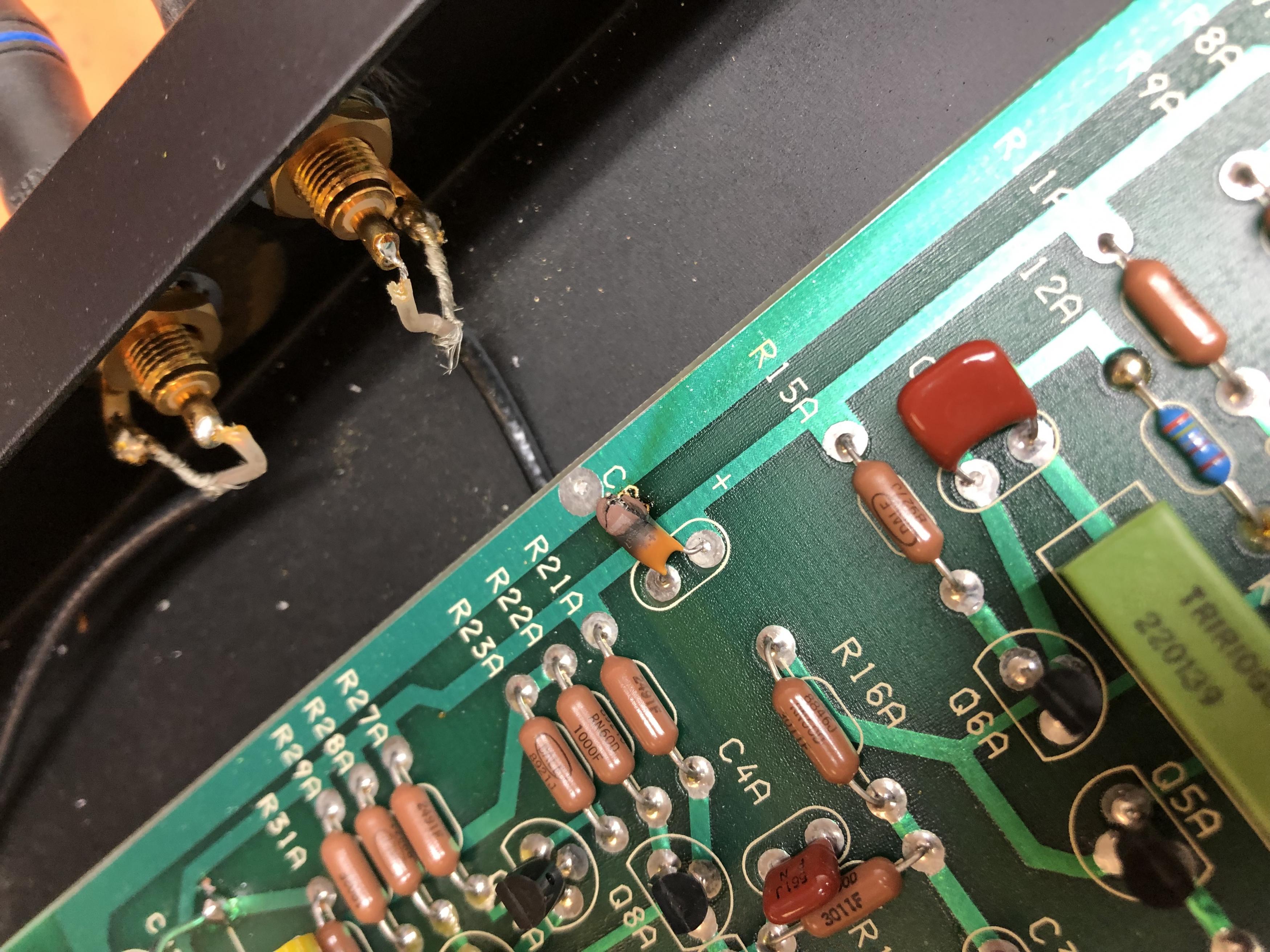

Hello everyone, I'm back!
I replaced a few caps on my d2a and now it's DOA. But, it wasn't my fault!
I replaced the two big coupling caps on the analogue board with tighter tolerance film caps and the one electrolytic on the digital board with a higher voltage replacement. I have the replacements for the rest of the orange Sprague caps, but the board is such a mess to work with I deciede to hold off on those.
Anyway, the smoke has been released- it came from C6 on the schematic (identical to C5) I think it (was) a Tantalum cap, and I am reaching out to see what a suitable replacement might be. I will replace all four at the same time, so I'm not tied to the idea of a Tantalum cap, but if that's the best choice to use in the location, I have no problem with that either.
I have attached the analogue board schematic as well as the photo of the offending cap. I have a Mouser order going for other stuff so it would be great if I could tag these on that order.

caps look to be psu rail bypasses, you could try some polymer caps (i.e. os-con, FP-cap) or some low-z electrolytics (panasonic fm series, nichicon kz, etc..) you might need to try several types to see what sounds best (give each type a few days of break-in with power applied before serious listening)

I found the exact replacements for these, but I’m going tighter on tolerance and up on voltage. I thought electrolytics would be okay but they used tantalum when they could have used electrolytics in the first place, so I’m sticking with that. They are significantly more expensive so there must have been a compelling reason to use them.
I’ll now probably change the 12 other caps too, since I’ll have it all apart.
This DAC also uses PCM58 chips but only have one trim pot (for the first bit). The Sony used all four trim pots, and I wanted to add them to this but it’s more trouble than it’s worth. Too bad because they left money on the table so to speak not going to full potential of the chip.
