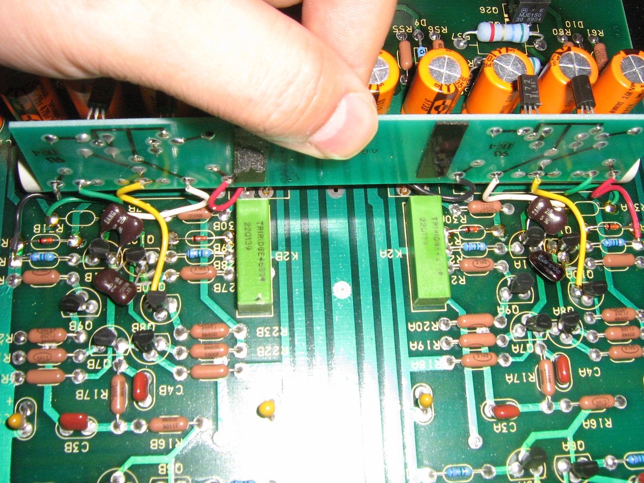

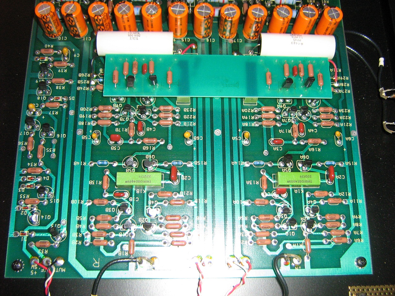

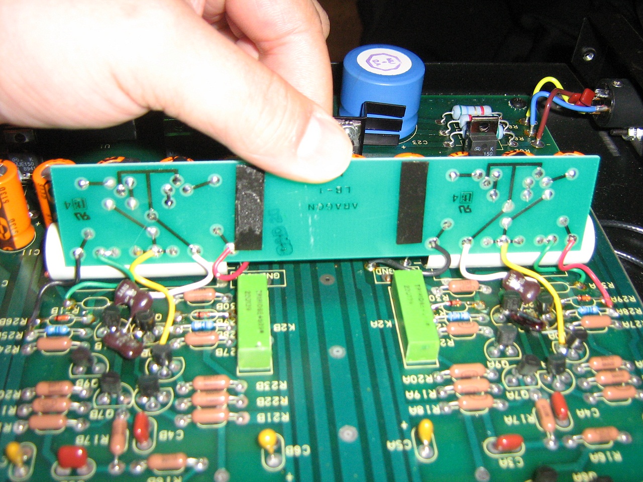

Dr. Dyna, YOu are my last resort! Info on the upgrade path to convert mkI to MKII is missing even with Indy Audio Labs. Could you please (i) post pictures of the board (near the 10uf caps)? there is a little board added in the MK2 version. Can you tell on this? what is it exactly for? (ii) can you tell me the brand of the 10uf caps?

Here you are!

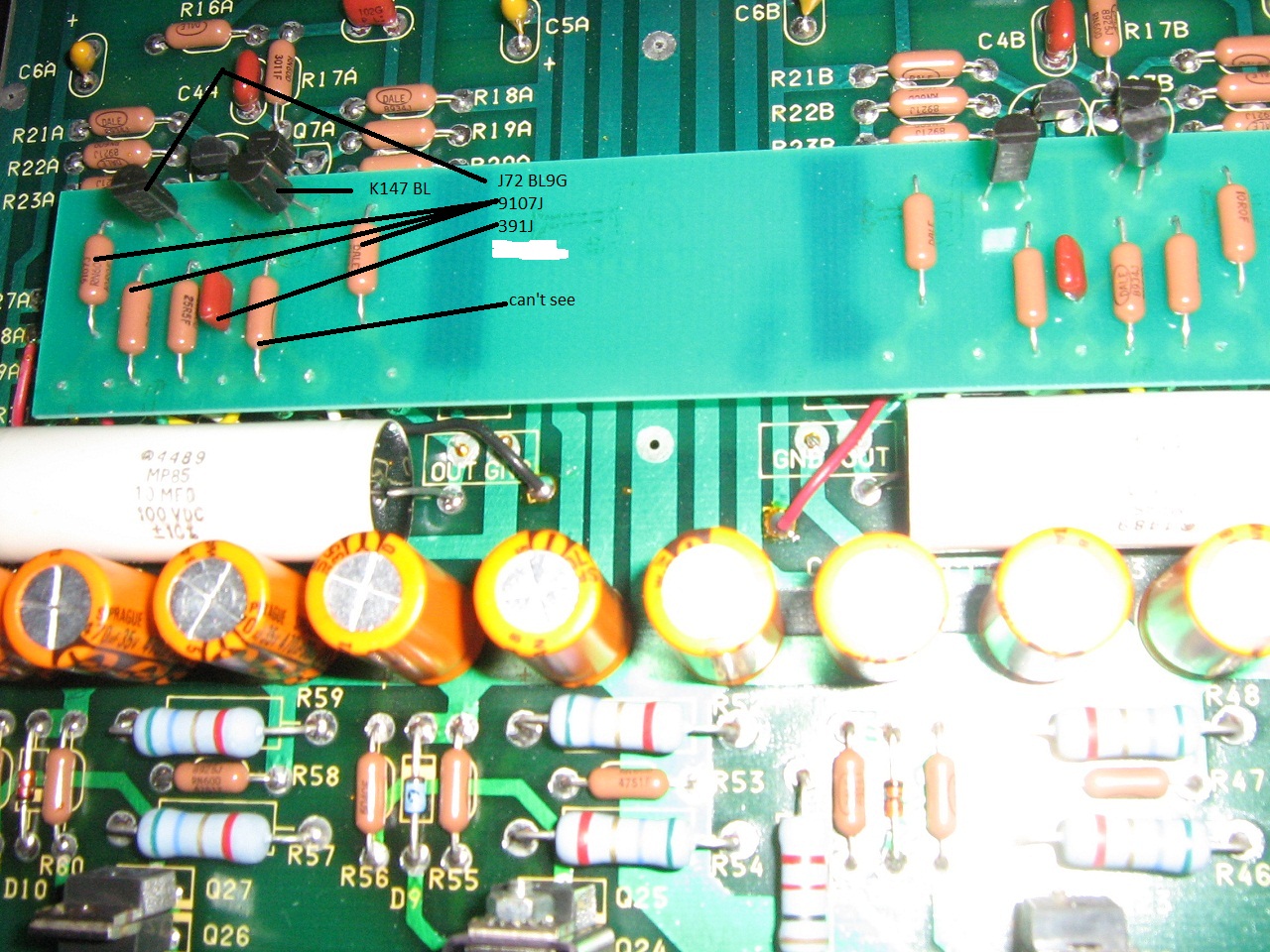

It's a little difficult to see the values on some of the resistors due to the way that they soldered some of them on the board with the values facing down 🙁
The board itself is labelled "Aragon LB-1" if that helps.
It also appears that they've added some parts to the main board as well, but it's difficult to tell which parts. Perhaps you can compare photo 2 with your mainboard.
Hope this helps!

Dr Dyna, I am speechless!! Thank you very much for the pictures. This is the ONLY information on the MK2 modification available in the entire web! I noticed that your DAC has the yellow 10k caps that I also have in my mk1 and in my acurus ls-11. In other pictures, I saw Mk2 with a thicker ones (probably of the same value). Aso liked V. Wooten. Jim, I like "somewhere down that crazy river" form the same album. K Jarret (STandards) is very smooth in the d2a. I just bought for digital signal (i) Mit and (ii) Van del Hul 310 (silver) and both are great, with a larger stage with the VDL. ...FOr sure I am going to keep this dac for a while. YOu may not believe this but I made for inteconnection a CAT5 cable that is very nice and detailed....Best regards.Sebastian.
So, to clarify, which caps in the photo are the ones 'in question' with regards to being in the signal path?

The big white one, I suspect is the output coupling cap, it's in series with the output. It doesn't "look" like a bad quality cap, but 10uF caps are easy to come by so it wouldn't hurt anything to swap it out.
Using a different output stage altogether would probably be fairly easy to implement, they were nice enough to put the output stage and DAC section on different boards with their own marked L and R leads. Actually, both of the boards are labeled at all their I/O points. It would probably be easy as pie to lampizate or hit it with a Welborne DTO.
