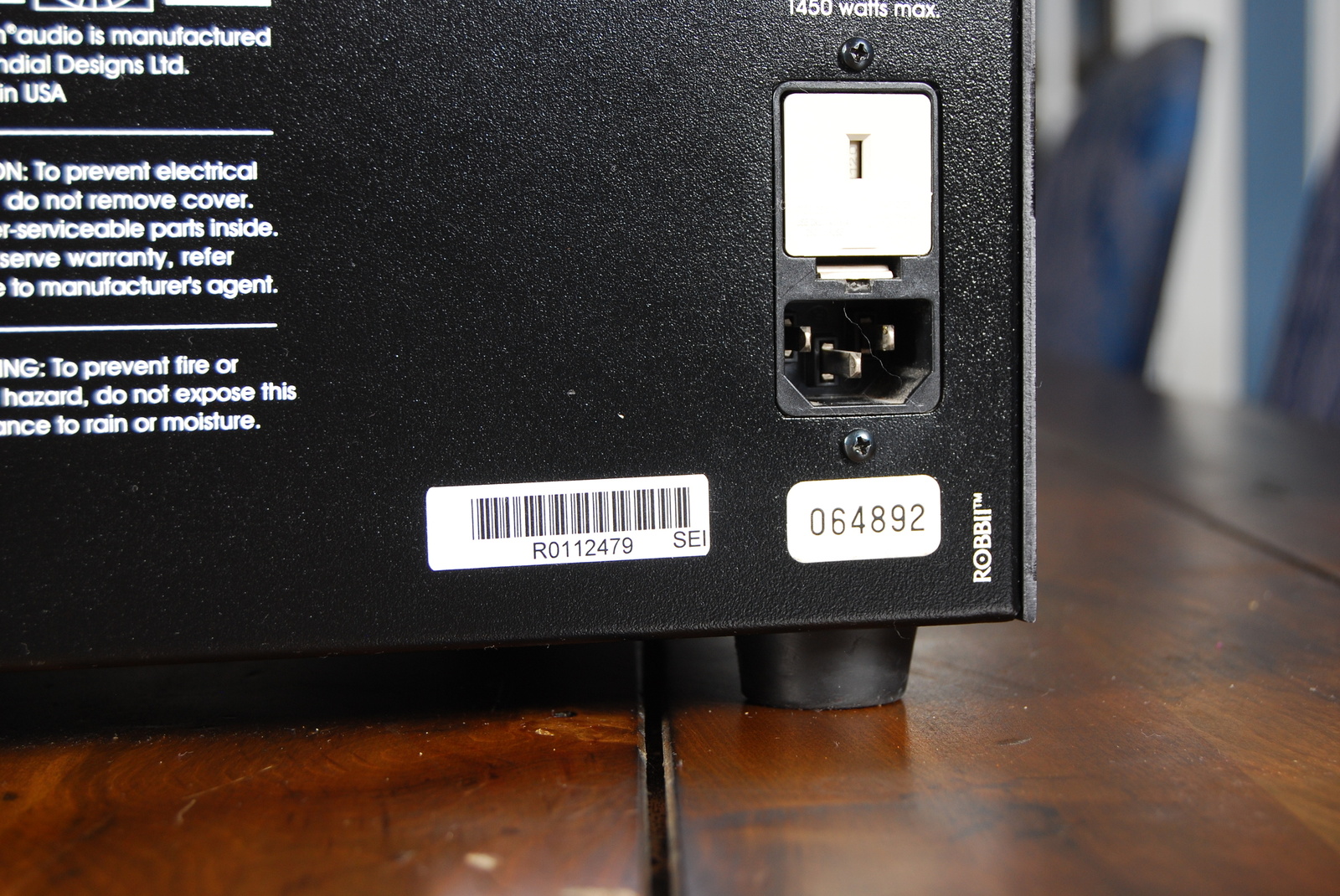

Is any one familiar with the Aragon 8008BB? On the back of the amp it lists a different fuse is necessary for 230 volts. The amplifier is currently 120 volts and will need to be converted to 230V.
The fuse holder is one that I have never seen before. You use a screw driver to pop it out on the back of the amp. Once it is out you see the fuse on one side and what appears to be a piece of metal that takes the place of where another fuse should go on the other side. The piece of metal is removable and the same size as a fuse.
It appears factory and I am assuming that it most likely has something to do with the voltage conversion process. I did not test the piece to make sure it had continuity....it is possible that for 230 volts you simply throw two fuses in instead of just the one on the right hand side if the removable piece that is not a fuse is not actually metal. The amplifier manufacturers web site does not mention voltage conversion in the manual and could not find a schematic online. I will try to attach a picture of the back of that amplifier that shows the type of fuse holder it is. I would suppose this not just a Aragon setup and it is more common then I think it is.

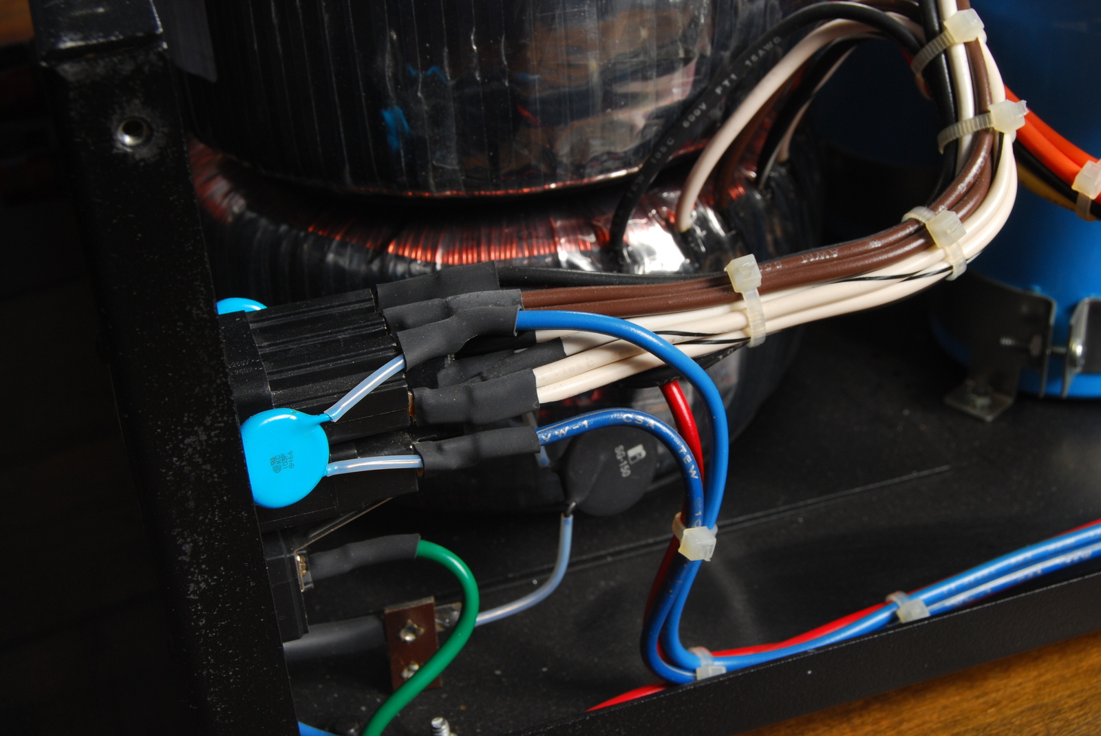

I used to have one, and have repaired some of these. I do not know the factory procedure, it may be real simple, but MUST be right..
They do have two transformers, so if all else fails, wiring the primaries in series instead of parallel would do the trick.
This would be an advanced solution, but you do have the option.

If the backplate says 115Vac and 230Vac, then the transformer must be a type that converts easily between 115Vac & 230Vac.
It's usual to use a universal mains transformer for all export models.
These have dual primaries. Each primary is rated @ 115Vac and is suitable for any voltage from 110Vac to 120Vac ±mains tolerances.
Wiring these in parallel gives you full VA rating for 110/120Vac.
Wiring these in series gives you full VA rating for 220/240Vac.
But use a Mains Bulb Tester.
It is very easy to get the phasing of dual primaries wrong. The Mains Bulb Tester will prevent damage if you get one winding out of phase.

Ok, I will check that later today. I see what you are saying. I finally talked to Aragon and they were saying it would require some rewiring...but I see what you are saying. So the insert should be re-positioned to read 230 or possibly it needs a different insert?
Ok so what I discovered was that you pull that inset out and it is 4 sided. Each side is labeled with a different voltage 100V 120V 230V 240V. On the opposite side of the labeling side where the metal contacts are that make contacts with different leads of the transformer they are all different. So they all touch some of the same but never all of the same leads. I would assume this would mean it is user changeable. Still cant figure out why Indy Audio Labs simply couldn't just explain this to me over the phone instead of saying a tech needed to do it. Thanks for all the help...if the amp blows up on voltage change I will let you know.

O.K., got to done. Use a small screwdriver to push tab next to fuse holder/voltage display. Pull out the fuse holder and replace with a 250 V 6 amp slow blow fuse. Take a needle nose pliers and pull the voltage display straight out. Turn it to the desired voltage and re-insert. Job done.
