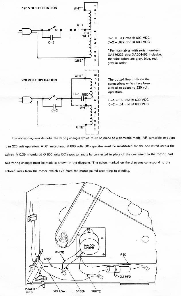

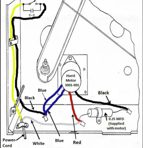

I bought a new Hurst motor for my AR XA turntable and started to replace it, but have a question.
If C-2 is added between the yellow and black wires per the attached drawing, won't there be power on the motor at all times, even when the switch is "off"?

The capacitance of C-2 is not large enough to get the motor running. It´s purpose is to supress/short the spark that occurs, when the switch is turned on/off. But in principle you´re right. Just that the current is negligible 🙂
A typical value for turn off pop capacitor c2 is .01 uf, 1000 v. Transients on a 120 vac line can be 1300 v from the turn off of a air conditioner/refrigerator motor.
1000 v caps are difficult to buy these days. Highest I could get from newark was 500 v. In that case you can parallel the cap with a mov supressor rated 300 vac or so. Metal oxide voltage suppressor. Not invented when AR turntable came out.
You could use a x2 cap which is rated by the normal line voltage used, but they aren't typically stocked in .01 uf.

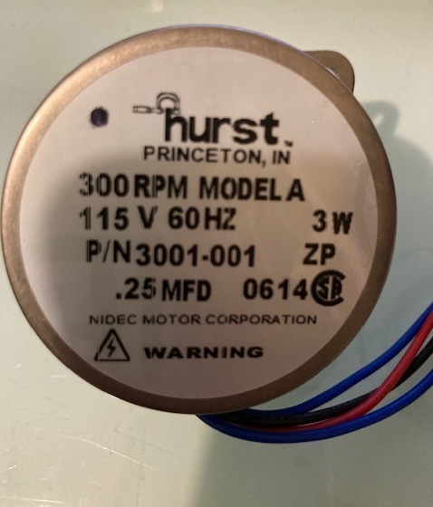

I recently got AR XB turntable without original Haydon motor and got brand new Hurst 3001-001 motor to install which I was told that good replacement motor.
The question is that I reside in 230v 50Hz AC main environment and I read somewhere that Hurst motor uses different value of capacitors against Haydon motor.
Does anyone know what value of capacitors to use for 230v AC main? The pulley is designed for 50Hz so just need to figure out how to wire the motor with correct value of capacitors to use.
The existing capacitors currently installed is 0.39MFD 600VDC and 0.01MFD 600VDC which are old so may need to be replaced.

Does the voltage at your house measure 220 volts? Here in the USA, it varies. At my home, it measures 122.3 Vac. It can vary by +/- a few volts depending on time of year. With turntables, that's why speed controllers are made. I can only tell the difference in sound if I accidentally put the speed on 45 rpm when playing a 33 1/3 rpm LP.
We have a lot of equipment at my former workplace that ran fine on 220Vac when the actual voltage was measured at 230 Vac. Those are motors for machine tools and I couldn't hear any difference with those motors as well. 🙂

The voltage is not critical within +/-20%. We are not sawing knotty oak.
This type motor goes by frequency. You need the right pulley and you say you have a 50.
The cap is moderately critical, and those instructions tell exactly what you need.
The 4-lead motor can be connected parallel for 110V or series for 220V. Basic electricity.
Your colors are different from the instructions. Did the motor vendor give you a clue? An ohm-meter will tell you which pair is a winding. I "suspect" that a 3-watt motor this large can stand 1 or 2 seconds of wrong-connection: if it doesn't spin right away, shut down and figure some more.

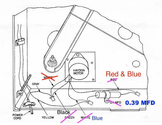

I put remarks on the wiring diagram and listed the change below. Have I understood correctly for 220v operation?
  • 0.1MFD cap to change to 0.39MFD
  • Put Red & Blue wire from motor together (in series) and connect them on one end of 0.39mfd cap
  • Connect the other blue wire from motor and one of AC main wire from switch (Yellow) on the other end of 0.39 mfd cap
  • Connect Black wire from motor to the other AC main wire

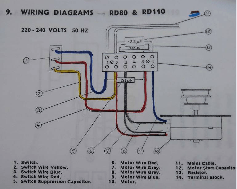

I am thinking to use Ariston RD80 turntable approach which uses 10K ohm resistor to reduce the voltage down.
Ordered 10K, 12K and 15K resistors to test with (will arrive in 2~3 weeks) and hopefully it works.
