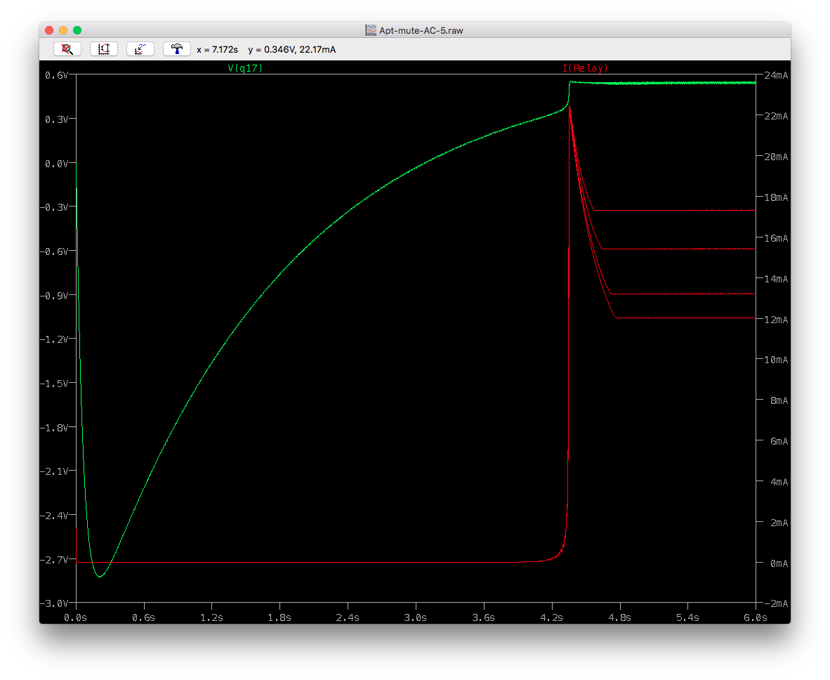

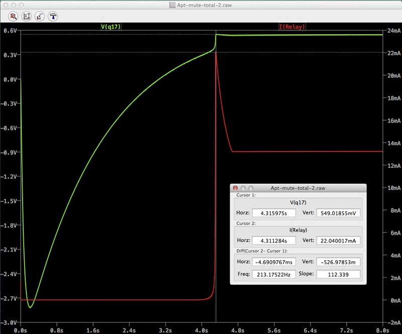

A spice graph (from a year or so ago while trouble shooting another users mute circuit):
Green trace is the delay drive voltage to Q17. Red is current thru coil: peaks at 22mA, then drops (as C67 charges) until Q19 turns off, stabilizing at 13mA+ thru R90.

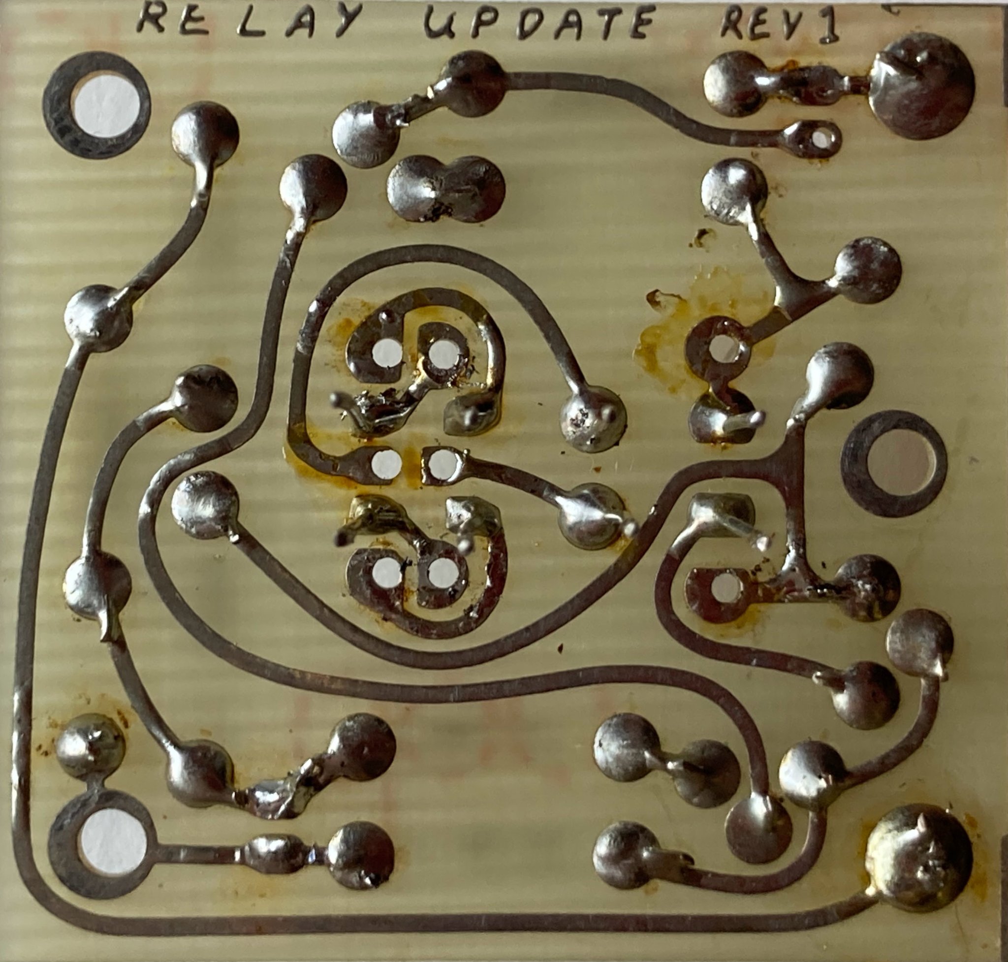

Booja30, Please let me know if you got the original circuit working. Thanks.Thanks for the reply. I am planning to revert to the original mute circuit to see if it operates correctly, and if so I will probably do the dead bug style mod to get a signal relay working. I'll probably preserve the existing design (signal going through relay) just to keep it simple for now.
Before I disassembled the 'factory upgrade' circuit I did some measurements of coil voltages to see if I could find out why it wasn't operating with the J2 jumper ribbon connected. With J2 disconnected, the coil voltage was 27.7V unmuted and 17.2 muted. With J2 connected, the coil voltage was 23.3V unmuted and 14.6V muted. I believe this had to do with the slight voltage drop (200mV) on the +16V rail when J2 is connected and is powering devices on the switch assembly board. But even so, the circuit wasn't performing well if it was only able to change the coil voltage slightly between mute/unmute states. I would have expected something closer to the ideal +24V/0V for the unmuted/muted coil voltages.
Anyway, I'm going to order the parts today to repopulate the original muting circuit, as well as a small signal relay.

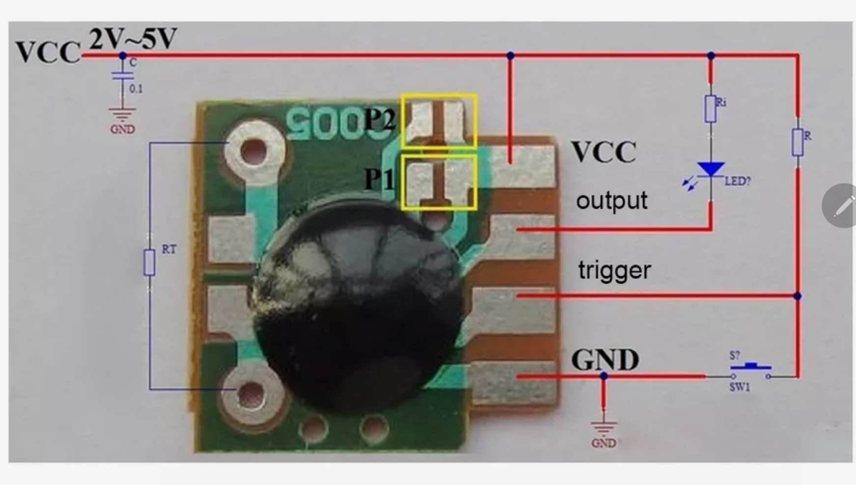

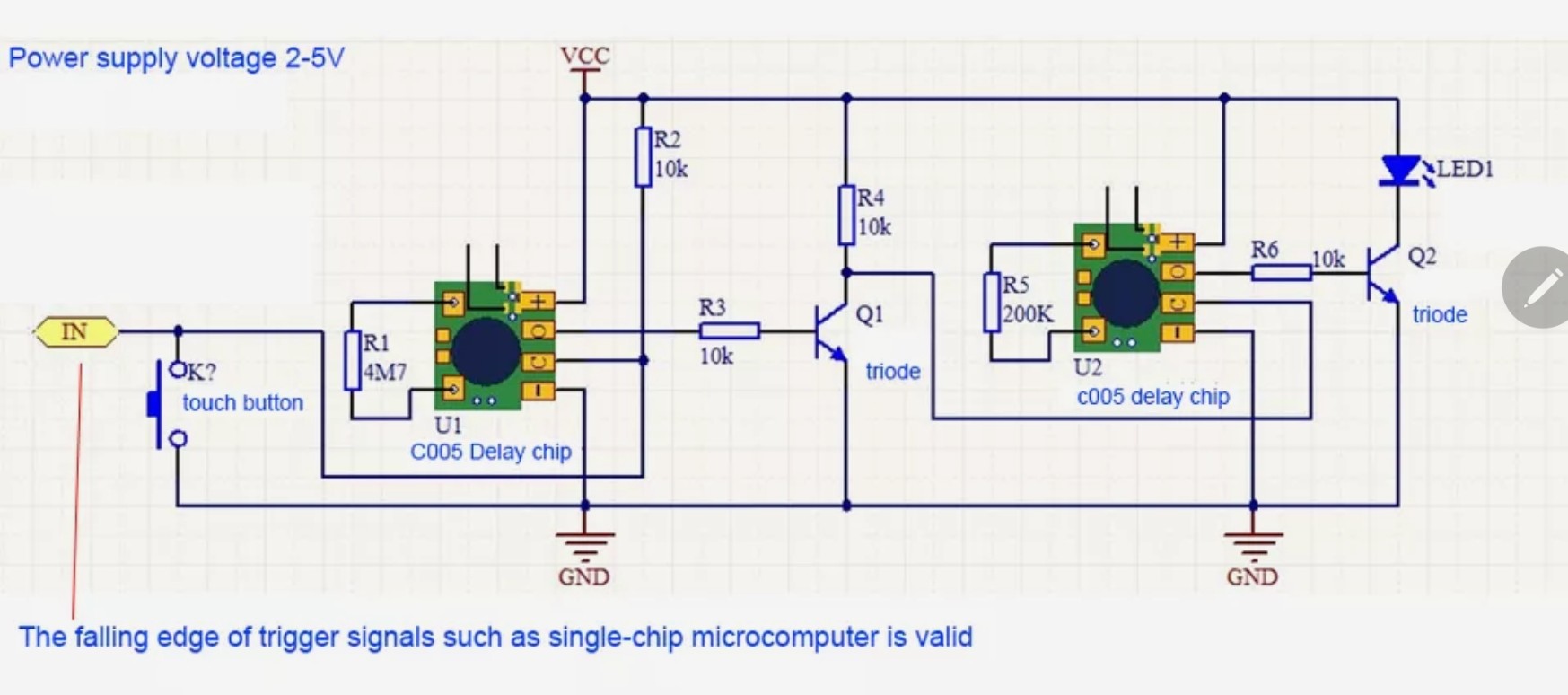

This came up on my front page recommendations on aliexpress. Could they assist with our muting circuit, possibly bypassing it? I don't quite follow what they're saying, except that it is triggered on the falling edge of an input (approx 5v to 0v)
And the price, $0.57 TOTAL for 10 pieces, plus $2.18 shipping. insane
US $0.06 54%OFF | 10Pcs multi-function delay trigger timing chip module timer IC timing 2s - 1000h

As (I think) I mentioned before, the 'upgraded' mute circuit had 24V connected directly to one end of the relay coil. The other end of the coil was connected to the new muting circuit on the floating PCB, which then continued to the mute switch and finally to 0V. The strange part was that this PCB also had its own jumpers connecting to +18V and +16V. These lower voltage rails were the ones I noticed sagging (down 200mV) when the switch assembly board was connected.
The interesting detail was that the +24V didn't sag when the switch assembly was connected. What happened was that the low side of the coil connected to the mute circuit wasn't able to as effectively pull down the voltage. So, as an example, when the mute circuit was working (switch assy. disconnected), the relay coil leads would measure +24V and +11V (relative to GND). When the mute switch wasn't working (switch assy. connected and +16/+18 rails sagging), the coil leads would measure +24V and +14V (again, relative to GND). So the voltage across the coil dropped even though it was fed +24V in both cases. So it seems like the sag on the +16/+18 rails kept the transistors in the mute circuit from opening fully.
The original mute circuit (if I'm reading it correctly) doesn't rely on the +16V or +18V rails, and just connects +24V to one end of the coil, and uses +24V to power the timer circuit. We'll see!

For grins, here's a sim of R90 at 4 values: 1k, 820, 560 and 390. Coil "hold" current increases as R90 value decreases.

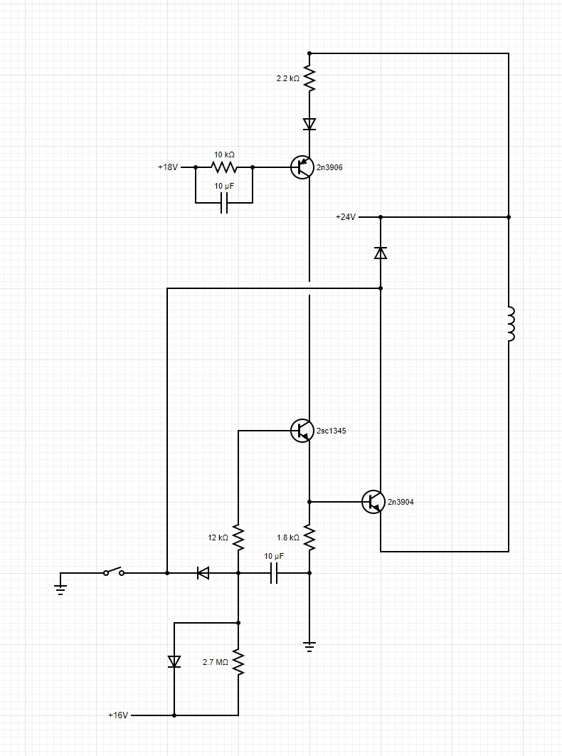

When you get the "upgrade" coil board swapped out, please try to draw a schematic of how it's wired.
I gave it a shot this evening with a free online drawing tool. I'm sure I screwed something up, but maybe not...Correct. The original circuit does not draw from the regulated supplies, so doesn't take away from the opamp power. The coil draws from the rectified but unregulated +24v. The delay circuit draws directly from the transformer secondary thru a single diode, for 1/2 wave rectification.

Thanks for trying, but yeah, it doesn't quite "compute". Sim results show no delay, and coil current remains 0.I gave it a shot this evening with a free online drawing tool. I'm sure I screwed something up, but maybe not...

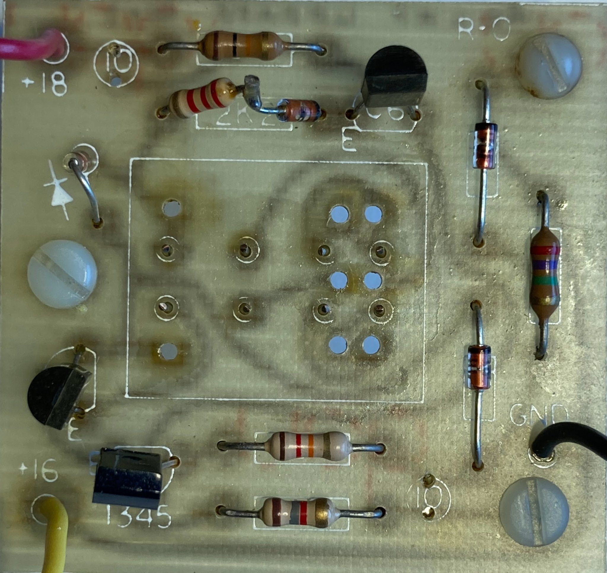

Have you removed the board already? If you can get a photo square on from the top, and another from the bottom, I can superimpose them to figure out the paths.
@seanc: here you go:
The transistor at the top is 2N3906. The one on the lower left side is 2N3904. The one on the bottom left is unmarked but the PCB says (2SC)1345.
Note that some of the jumpers to the main PCB are visible and are pointing toward the camera. Perspective makes these jumpers look like connections that don't actually exist.

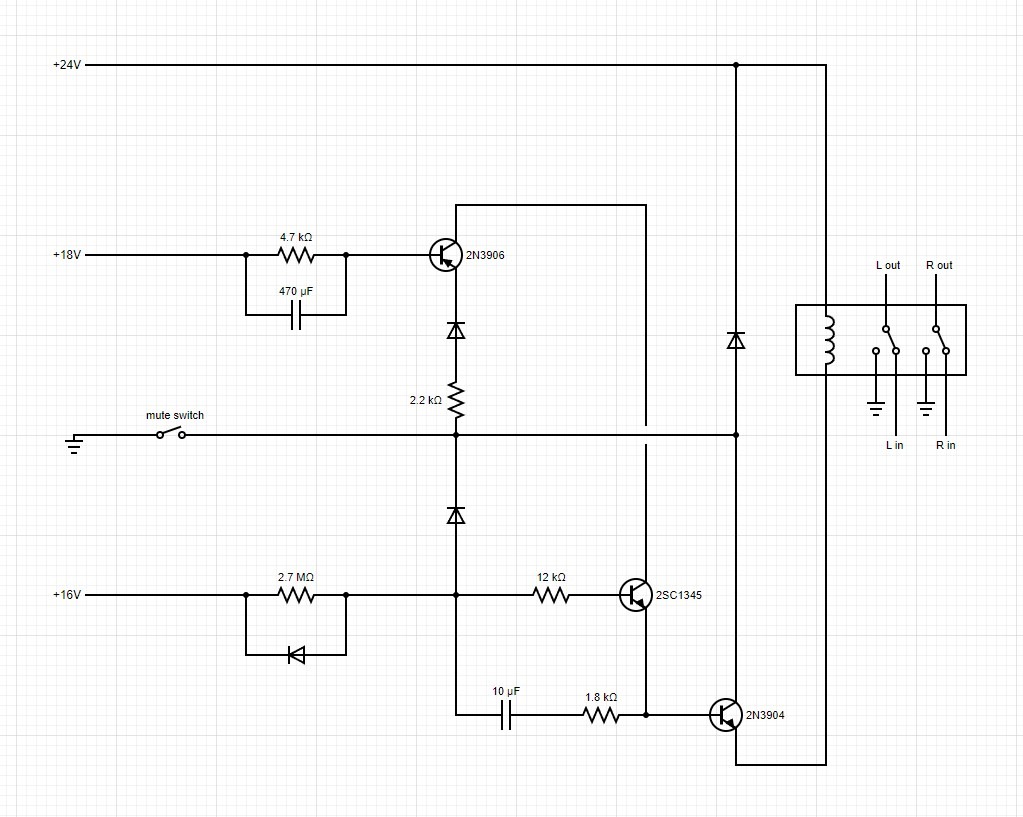

I tried again with the drawing tool and saw mistakes in my earlier drawing. Also, I think when I refreshed the page at one point it reset some of the component values.
You're better off going off of the photos, but here's my second attempt. Looks way different.
