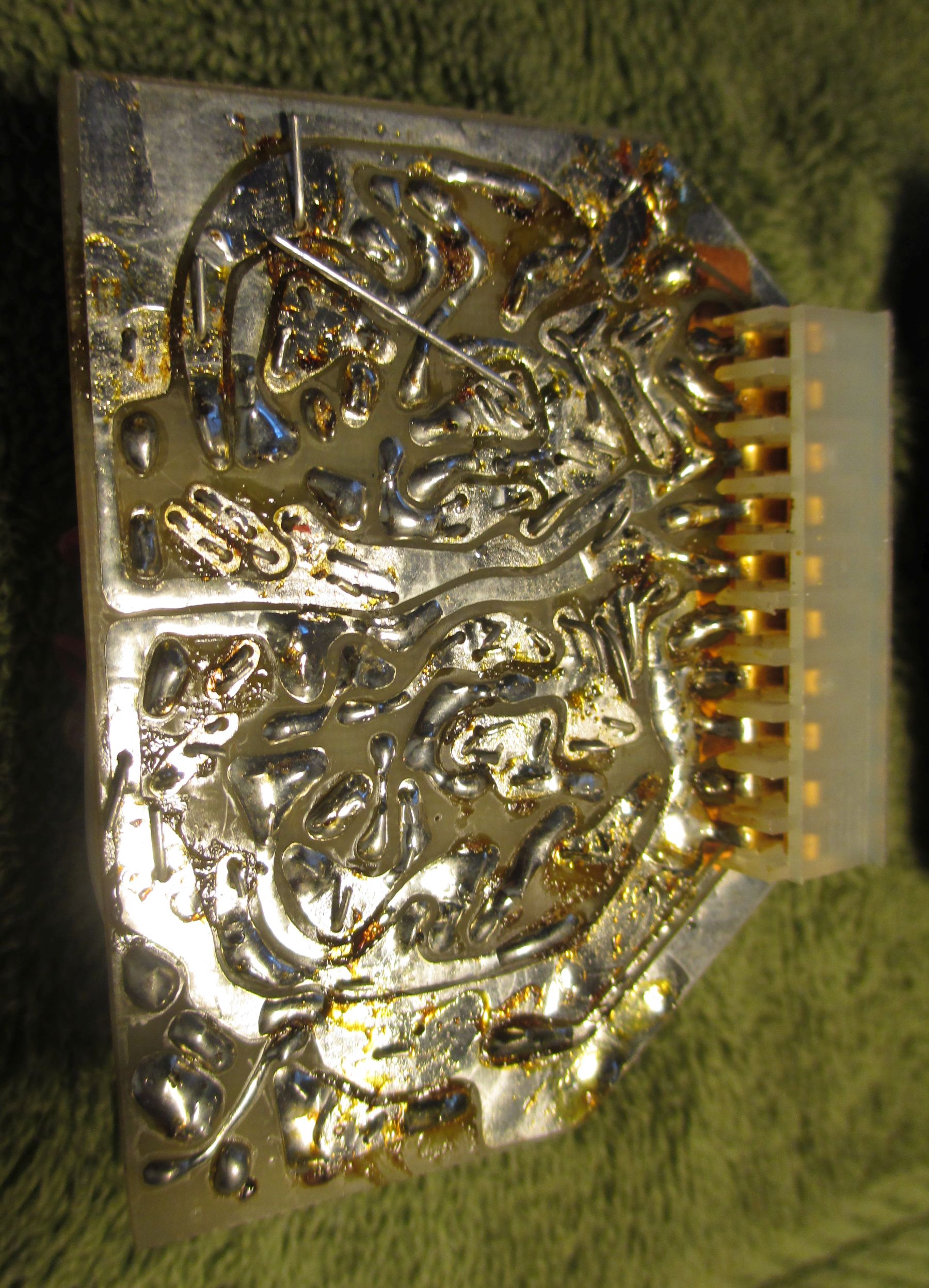

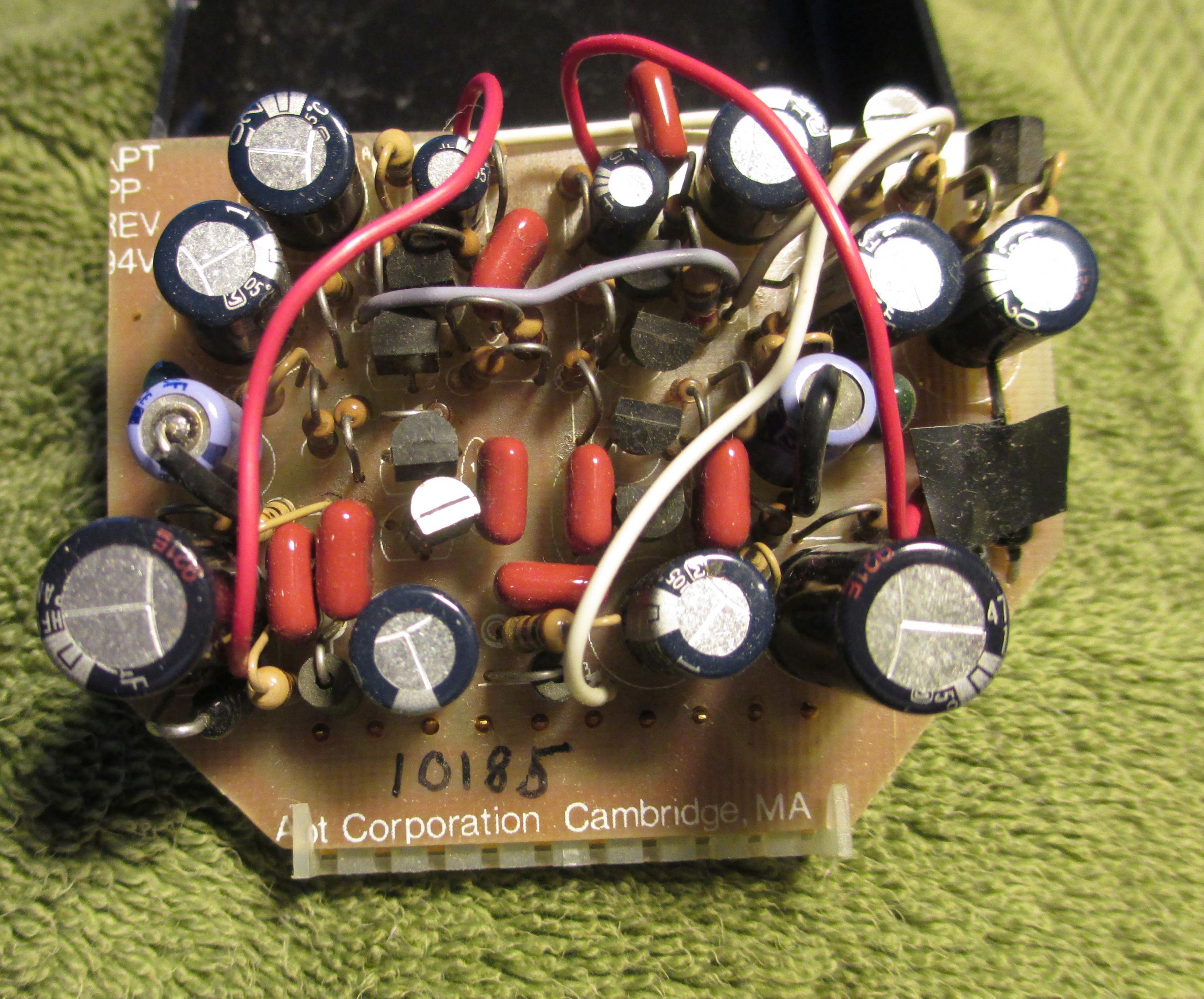

nice build on the MC board!
Originally there were at least 2 maybe 3 MC board options from Apt. Each one varied slightly depending on the amount of gain needed. I may have an original board if anyone is interested; can post a pic.
I bought this years ago from a former APT dealer, who had it on the shelf.
There were 3 versions made, not sure if the gain was different or the loading was different. The model I have is 1-A, for 68-70 db of gain with 0.3mv output carts.
Was never able to find a schematic, but all discrete components. Transistors are all Motorola. MPS 4355, 2N 3906, and cant quite make out the other 1.
here are a few pics.
There is a guy on the US east coast that repairs the preamps, he advertises on ebay. He used to work at Apt so may have access to a schematic.
