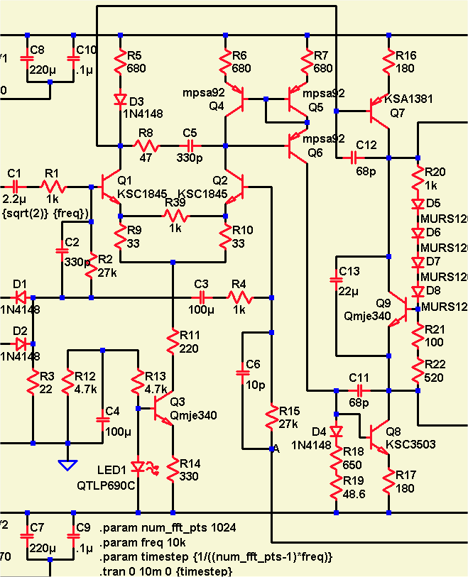

ALL hail the APT, I 've got this baby Smokin' (.0005 -.001% 20k)
wilson mirror level splitter.. Strange "self balancing" LPT ,(you can
put a "deliberate mismatch" for LTP and all is well).
It doesn't seem to have any of the drawbacks of the "blameless"
and sounds like a symasym.
Attached is the latest "bastardization" of the APT. (I'm making
the boards for a triple EF AND a Krill varient).

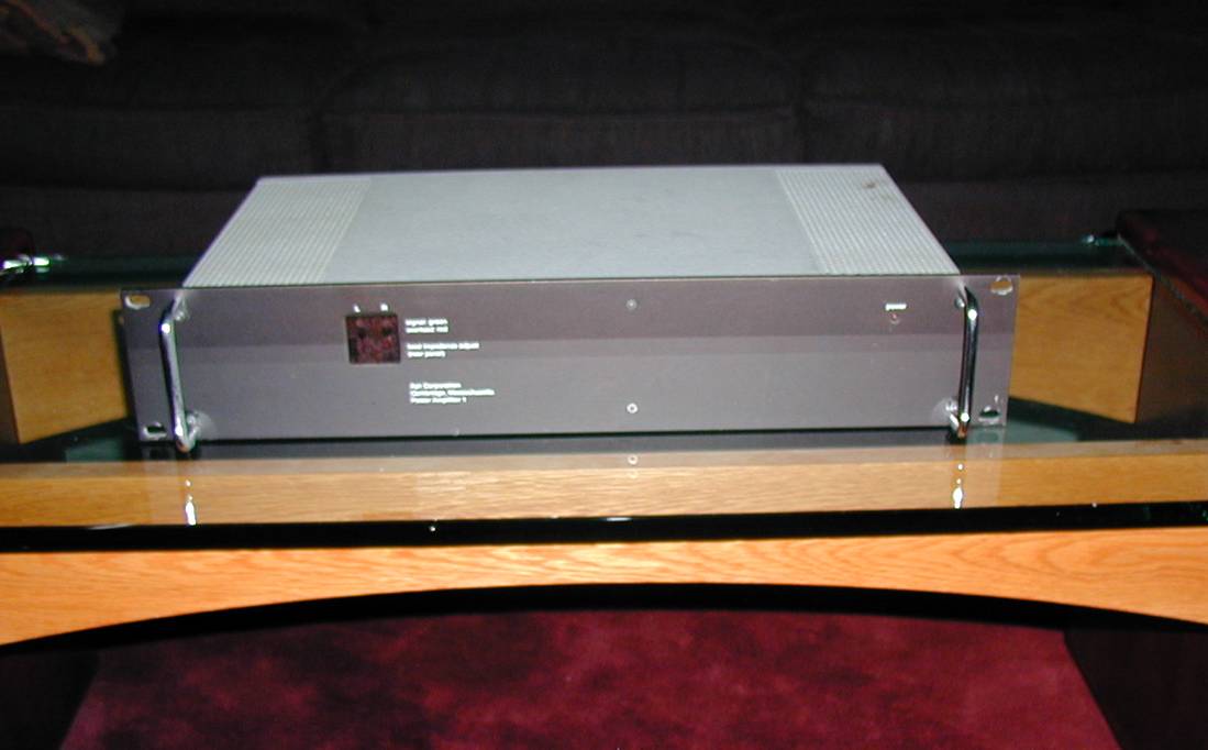

I have an Apt 1 power amp in good condition. I bought it from a local shop here in Tucson about 30 years ago. Has intermittent on one channel. Little green "signal" light (and output from that channel) goes away every now and then. Will often recover with a light knuckle tap to the cover. Probably a solder joint. I just haven't had time to dig into it.
Would be willing to sell to good home. Too many projects in the queue. Contact dave dot milne at honeywell dot com

the intermitant is probably one of the StakeOn pins which are the terminals all of the 22ga wires are attached to the boards with. , or one of the pins of the 3 color LED (if it's just the LED that's intermittent, and not the audio)
