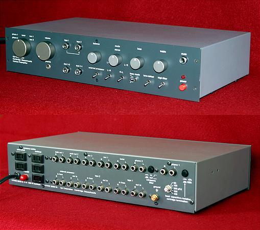

The APT preamp had a bass tone control to address the problem of equal intensity loudnesses, still today refered to Fletcher and Munson, names which should be forgotten in favour of many more recent works on the same subject. Holman based the conception of the APT tone control on Stevens's works. Simulation shows that when its bass control button is turned fulyl clockwise, the boost is :
+1 dB at 400 Hz, 220 Hz + 3 dB, +14 dB at 32 Hz, +16 dB at 16 Hz, +17 dB (flat) at 3 Hz.
This should be a good start to reintroduce one of the most lacking feature of so-called hi-end equipment : tone controls.

Burnedfingers,
To be pleasant on this Christmas day:
1. Tone controls are not there to compensate for poor amplifiers, they are there to compensate (at least to a degree) for room acoustics, loudspeaker inefficiencies, ears, and taste. Also read "compensate", i.e. to correct that has already gone deficient somewhere else.
2. The statement is often heard that tone controls degrade. Kindly define in technical terms! I agree that some over-simple lousy circuits exist, but a good design set for flat, has NO detectable phase or amplitude difference compared to a straight wire. A loudspeaker has much more.
3. I am afraid blind tests have consistently indicated that "hearing the degradation" by (well-designed) tone controls is a fallacy. I myself have on occasion been naughty here. I believe I have a well designed amplifier (others say so), and I have often heard folks mention that they can hear the difference when actuating the tone control cancel switch during a demonstration. Fact is, that switch was not wired in.... :)
As said on another thread, may all have a very memorable festive season and 2006. It has been a great advantage for me to have joined this site.

HI Johan Potgieter
"The statement is often heard that tone controls degrade. Kindly define in technical terms! I agree that some over-simple lousy circuits exist, but a good design set for flat, has NO detectable phase or amplitude difference compared to a straight wire."
Tone controls based on Baxandall circuit use virtual earth at standard line levels so they introduce almost no distorsion. However I think their bad press is coming from the pots which genarally are of very poor quality. This is a place where real audiophile exigence should be, using first class grade for these electro-mechanical parts. twelve positions switchs commutating resistors can reliably replace pots at low cost in tone controls.
