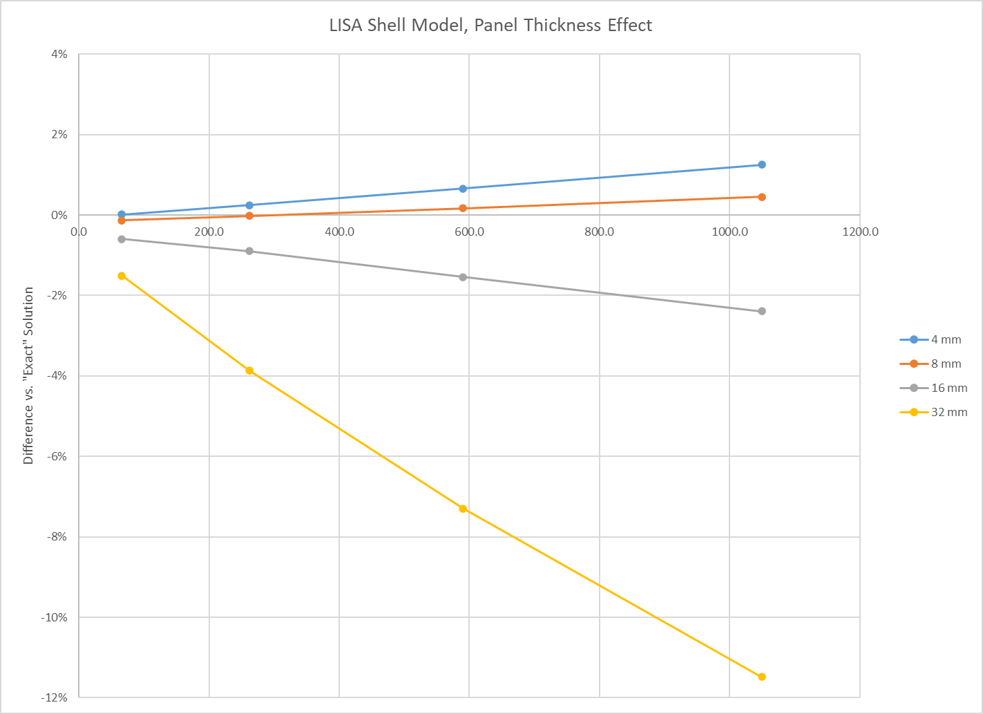

When comparing plates for assessment of thick or thin, I think you should calculate the ratio of wavelength to thickness at the frequency of interest. Plywood is thinner, but its also stiffer, so will have a smaller wavelength than EPS at any given frequency. If the thickness is ~0.1 lambda, you could get away with a thin model I suppose.Here are the modeling results I mentioned in my previous post. Otherwise same dimensions and properties as previous results.
I used these parameters:
thickness, E
4 mm , 8e9 Pa
8 mm, 2e9 Pa
16 mm, 5e8 Pa
32 mm, 1.25e8 Pa
I believe that the results for the 4 and 8 mm thickness panels land slightly above the "Exact" solution only because my mesh isn't quite fine enough. I expect if it was fine enough, the 4 mm results would land ever so slightly below the Exact solution, and the 8 mm result just below the 4 mm (as it is now). But other than that, the results look like I would expect. As the plate gets thicker, the farther the result lands below the exact solution.
Plywood plates are typically around 4 mm thick or less, so it looks like that pretty much qualifies as a "thin" plate, at least up to 1000 Hz. But PS foam plates tend to be thicker, closer to the 16 mm lines, and hence are probably best considered "thick-ish" plates for which the Exact solution isn't so good, especially at high frequencies.
Oh yeah, I only plotted four frequencies this time. One reason is that fewer points were easier to plot! But the other is that I noticed that increasing thickness had stronger effect on some types of modes than others, so the "order" of the modes changed. In this case I plotted the 1,1 2,2 3,3 and 4,4 modes only.

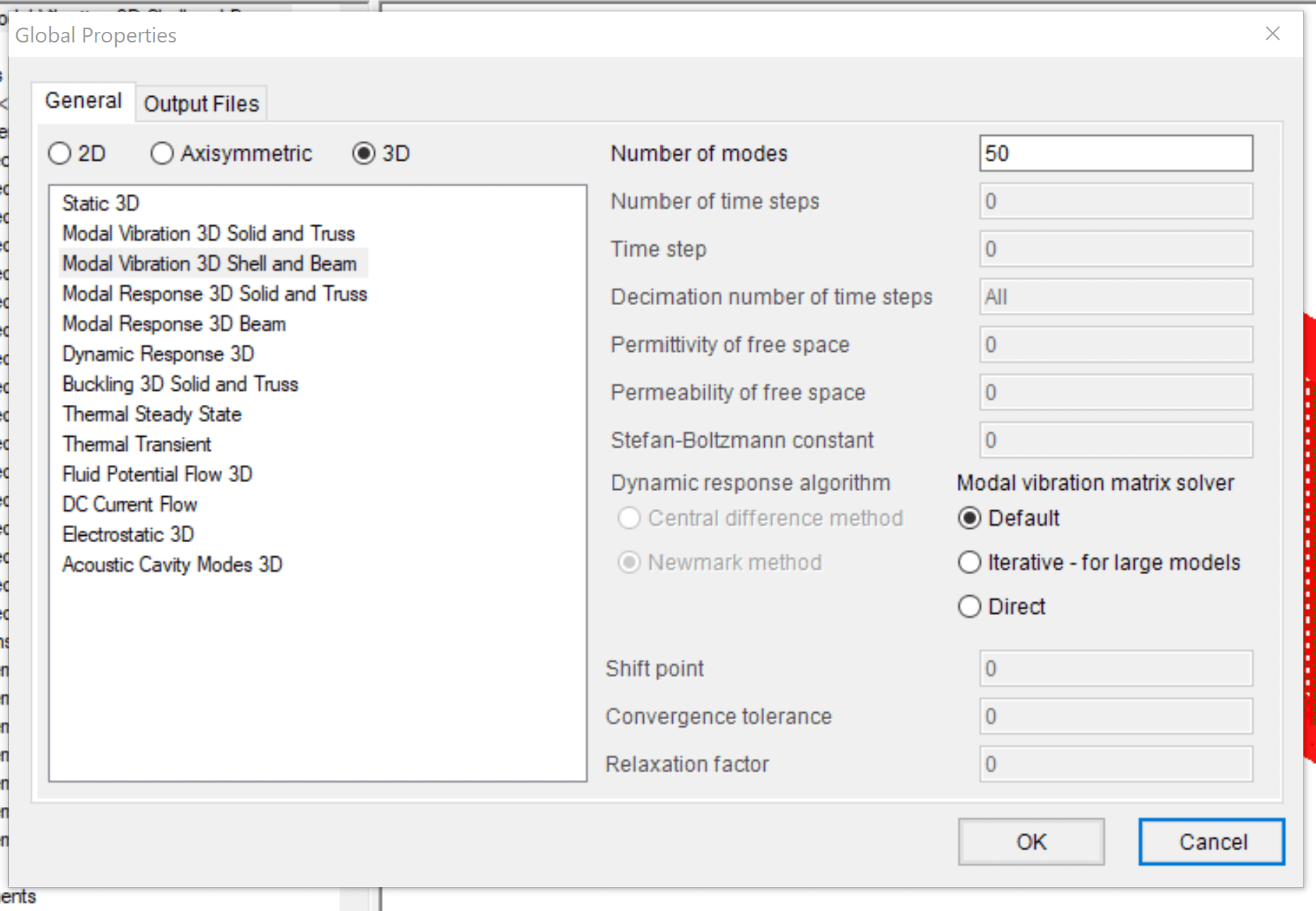

Eric, can you continue on to an harmonic analysis with Lisa? If so, does it output the velocity field over the surface?

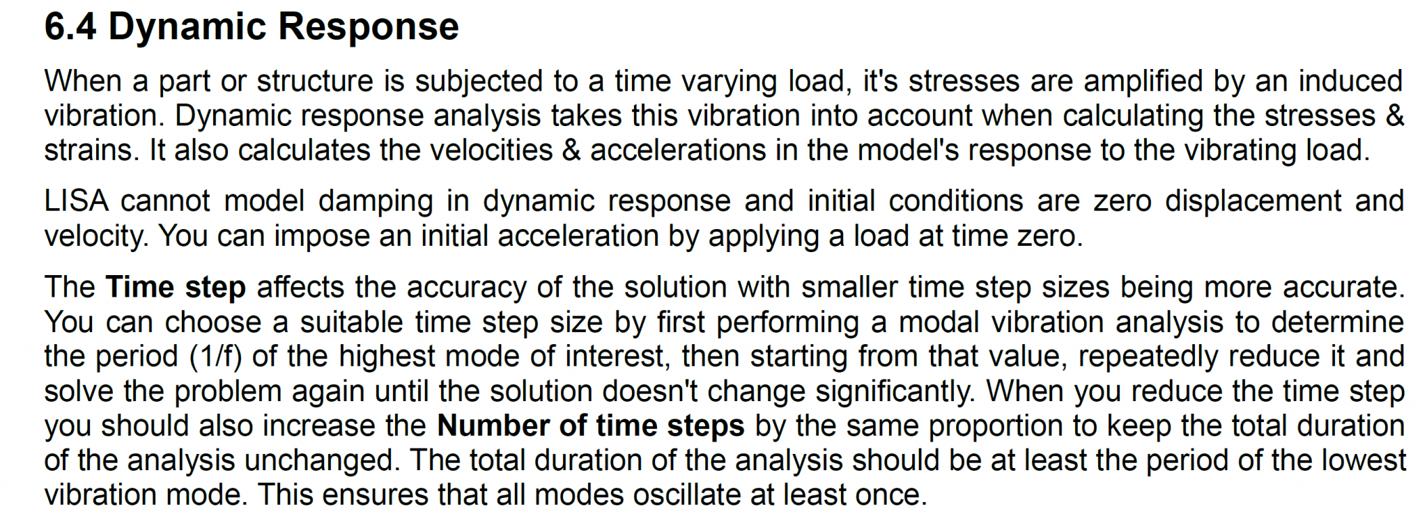

Anyway, I'm not sure what you mean by "continue on to a harmonic analysis". The only other relevant analysis method is Dynamic Response, which sounds interesting but I have not tried it yet.

Yes I think dynamic response is the same thing as harmonic analysis, or frequency response analysis. A sinusoidal force is applied at a particular frequency.
To get this in Elmer I think I have to build a 3d mesh using the more general elastic model. I suspect that the dynamic response is doing something similar to the formulas, adding contributions from modes near to the frequency. I might ask on the forum.

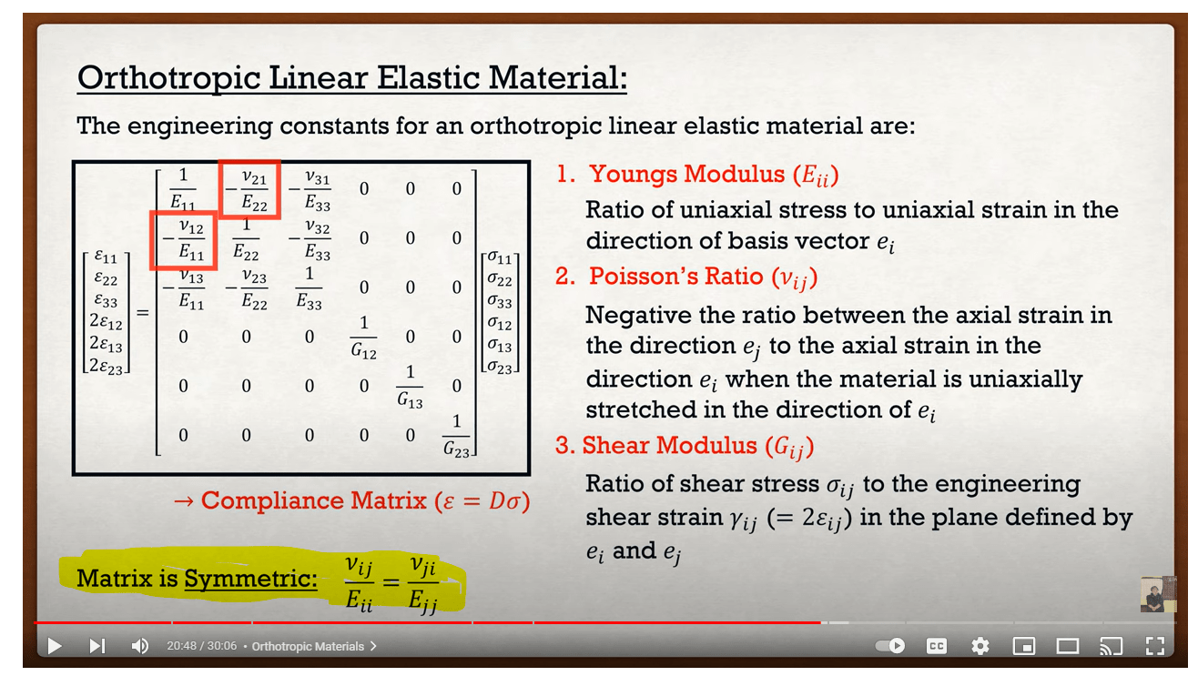

I found some info on how Elmer handles anisotropic materials. You have to input a matrix (or rather, a tensor) of values, either 3x3 or 6x6. You can also rotate the material axes relative to the coordinate frame. Successful use of it by a someone using it for the first time is described here https://www.elmerfem.org/forum/viewtopic.php?p=20232&hilit=orthotropic#p20232
I dont know whether the plate solver works with the full tensor (I know the general elastic model does), but I think its worth a try. I know you have done quite a bit on orthotropic materials, so if you can formulate a 3x3 tensor, I can try to plug it in and see if it works at all, and if the results are the same.

PS, as the post I linked above says, apparently for orthtropic input the youngs modulus value is specified as the inverse of the stiffness tensor:
I dont know if the plate solver will accept this 6x6 value, I would guess that being a 2D model its a simpler 3x3 tensor as described here: https://engineering.stackexchange.com/questions/17099/stiffness-tensor-in-two-dimensions
Anyhow, I have some hope now that the plate solver does accept orthotropic input, because the manual describes how perforated plates can be modelled by formulating an equivalent orthotropic plate.

Paul,
I'm glad you found out that Elmer can handle orthotropic materials.
One thing that's good to realize also is that the complicance matrix is symmetrical.
So that means there are fewer independant properties than it appears.
For the 2d case (3x3) there are only 4 independant constants, not 5. if you know E11, E22 and nu12, then nu21=E22*nu12/E11.
For the 3d case (9x9) there are only 9, not 12 for the same reason.
