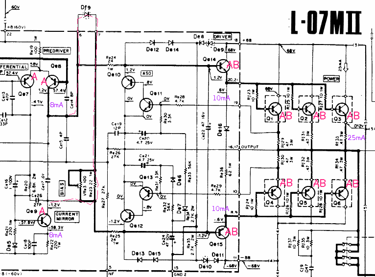

The L-07M seems to be a dead-classic "Class AB" power amplifier. See image.
As always, the input stages are run in Class A. They do not get hot enough to fool with class AB. There are 3 stages of voltage-gain which can be applied to reduce distortion.
The output stage delivers 150 Watts, which would be costly in a class A design, and class AB stages can be exceptionally clean, even avoiding some troubles of class A. The L-07 output stage is quite conventional. It is NOT "class B". Df9 and R23 apply about 2.4V of forward bias to push-pull Darlington connected power devices paralleled 3-wide. This gives an ample 25mA idle current per device (75ma per trio), enough to make crossover distortion very tiny.

Kenwood is a big place and they have sold some less-than-great products. But this is a fine amp and surely has no added distortion.

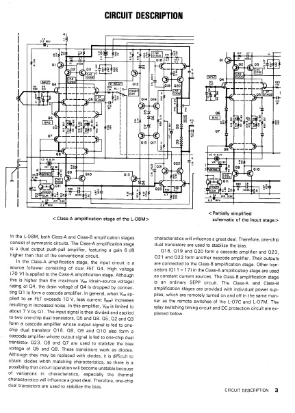

Hi my electronic is not that great so pardon my ignorance, I am trying to improve it beside my work. I read in audiokarama people saying L-08m is base off L-07mII. And L-08m service manual have better circuit description, so the information was based on L-08m. see attached images below.

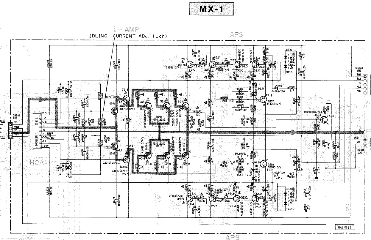

The final amp stage, class B, SEPP output seem to used by a lot of good amplifier including the mx-1. The thing I am confused is why kenwood say it is class B but yamaha say it is class A operation. Your teaching is appreciated. :up:

As DF96 says, A and B can look identical.
You are correct. The manual text does say "Class-B".

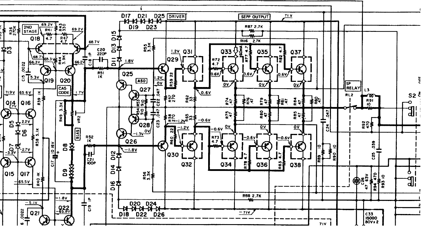

For more confusion, the circuit shows the output emitter voltages as "0V", which implies zero voltage across the emitter resistors, and zero current in the output devices (at idle in test).
But see the arrow at Q33. There is 60mA flowing. Not zero.

For any amplifier with some pretense of "quality" we apply some bias. For the usual emitter-follower design, we want the internal emitter impedance to be "small" compared to the load impedance.
Take just the Q33 Q34 pair and omit resistors. The transistors flow 60mA. Focus first on Q33. By Shockley's Law the emitter impedance is near 26r/60 or half an Ohm. The load is 4 Ohms or higher. 0.5 ohms is "small" compared to 4 Ohms. Even near idle, the stage has gain of 0.88, rising to no-more-than 0.9999 at high current. Gain changes 12%, which is greatly reduced by overall NFB.
But we really have six transistors acting like half-Ohm sources. But they have half-Ohm (0.47r) series resistors. So something like 0.17 Ohms driving 4 Ohms. And at high current (low emitter impedance one side, high on the other) it is still near 0.17 Ohms. Gain hardly changes at all. (This just touches the surface. R76 is there for a reason I do not care to puzzle out today. R72 and friends, Q31 Q29 and kin, reflect through the output devices as additional impedance. Not a trivial design.)
Note also that the total idle current is 180mA (0.18A) and the peak output current is around 16 Amps (64V/4r). The idle is about 1% of the peak. Far away from class A. "Practically class B." But that small current is enough to stay plenty away from true cut-off. The amplifier gain through zero output hardly changes.
Maybe the Japanese engineers use their terms differently, and the translator was not familiar with western technical language customs. It is possible that inside the Japanese *audio* community, transistor "class B" is "understood" to include enough idle current to say out of strict class B.
