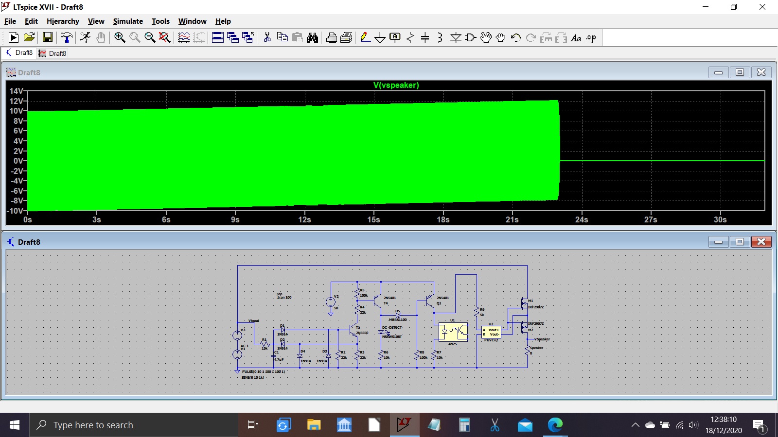

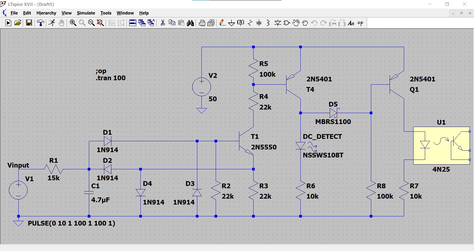

Is that low enough for dc protection?Trip occurs at around -/+2.5 volts DC.
This one does trip at +/-0.2V:
DC & Temp protection with limited resources
Its a pretty standard type of circuit so the amp designers must have thought it OK.
2.5v only gives 800mw dissipation in an 8 ohm load and so any speaker that such an amp would be used with should be safe.
