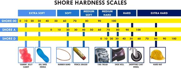

I messured resonance frequency before and after siliconing; it barely shifted after the procedure.
In my opinion, the key is the softness (shore factor). Silicone as the only ingredient is not sufficient. It's important to mix it with silicone oil, to archive a very low shore factor.
In the attached pic, it would be between the jelly bear and the shoe inlay 🙄
Removing the stages backplates is not so complicated. Open, pour the mixture in, wait for it to dry and put the magnet plate back on it. Repeat for the front side of course.
I don't agree 'bout killing micro dynamics with this procedure. To me it's a working method.
I also have zero doubt about the longevity of this stuff. It will last forever (my claim, do your own consideration).
One point; why doesn't Graz use silicone as a damper? Of course, it's ease of work and saving costs, if one uses foam. Imo both methods work fine.

This is not a foam-versus-silicone issue/discussion anyway. Only one of those options is suitable for a system repair without incurring the large cost of tearing apart your existing system to replace the woofer transducers. 🙂
I can speak for many Apogee owners in rolling my eyes at the thought destroying a perfectly good set of woofer transducers just because the edge damping foam is deteriorated.
