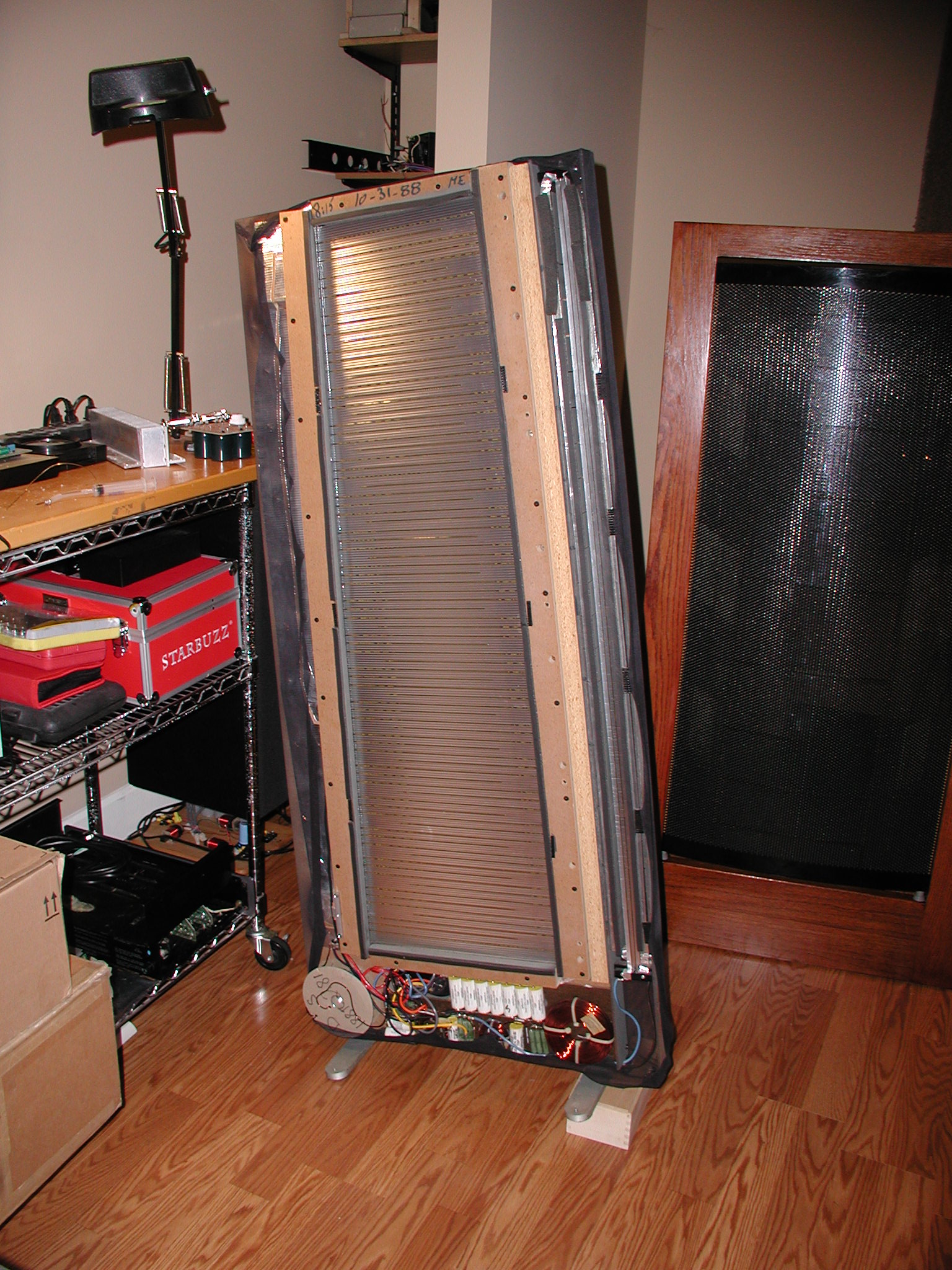

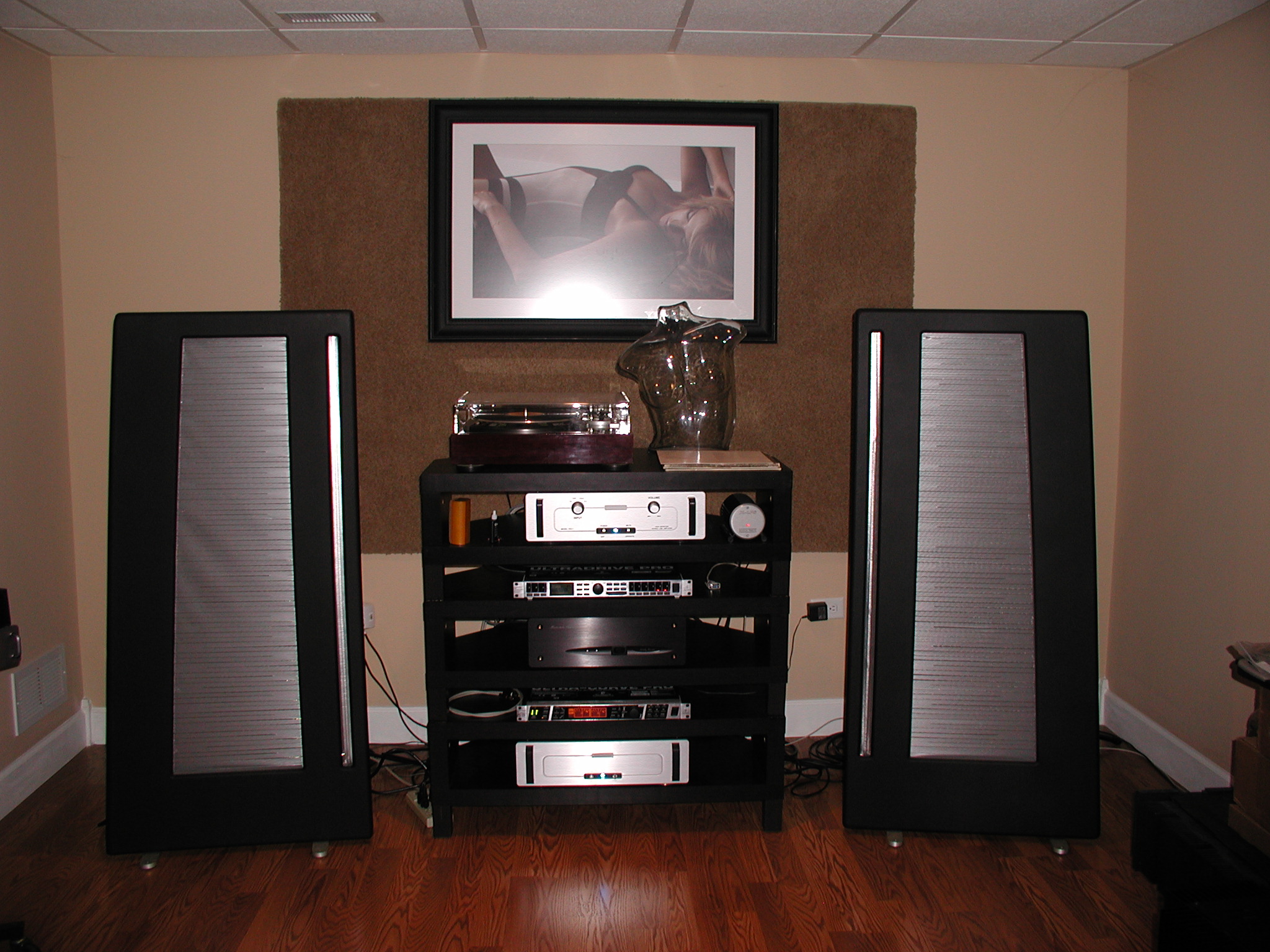

Hello all, OK, so I got myself a pair of Duetta Signatures the other day - always wanted a pair. Never could get my grubby hands on 'em, tho, until a few months ago. Drove four hours to pick them up. Had a whole 5 minutes to hear them. They sounded nice. Didn't really them play loud, or on anything crazy. No buzzes anywhere that I read about...so brought them home. Set them up, and took the covers off. One cover had a little crack from previous shipping damage from prior owner. Simple fix with a little sandpaper and Gorilla Glue and some gritty flat black spray paint and I was in business again. I also realigned the screen so I wouldn't see any annoying screen waves (Apogee owners kow what I am talking about). Did the other speaker and they looked 1000 times better.

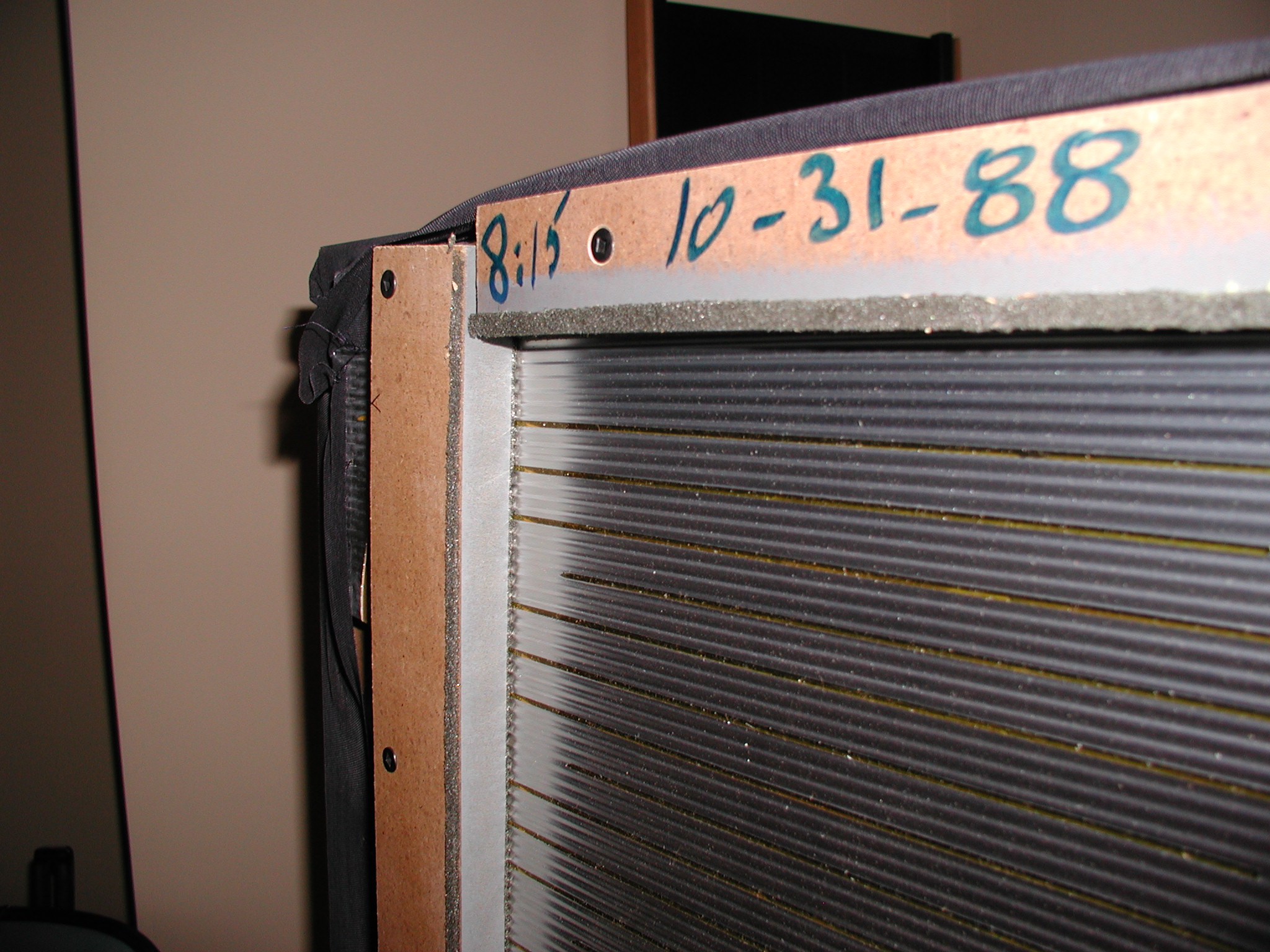

The loose Tweeter/Midrange ribbon was next - it was loose and dancing around, and it concerned me a bit. The top 9" is tilted back (to give the tweets a little vertical dispersion) and runs over a piece of foam as it make the tilt back. Well foam was gone, so I went to Menards and got some Air Conditioning foam and glued a piece in and it took all the slack. No more loose Tweeter/Midrange. Yeah. All done.
So I sat and marveled at my purchase. Put on some Jennifer Warnes (Famous Blue Raincoat - man I love this cd)...It sounded great...until I raised the volume - her voice sounded like Rod Stewart. What the hell was going on? It was buzzing right on on her voice only. No where else. I was pissed. How can I miss this?

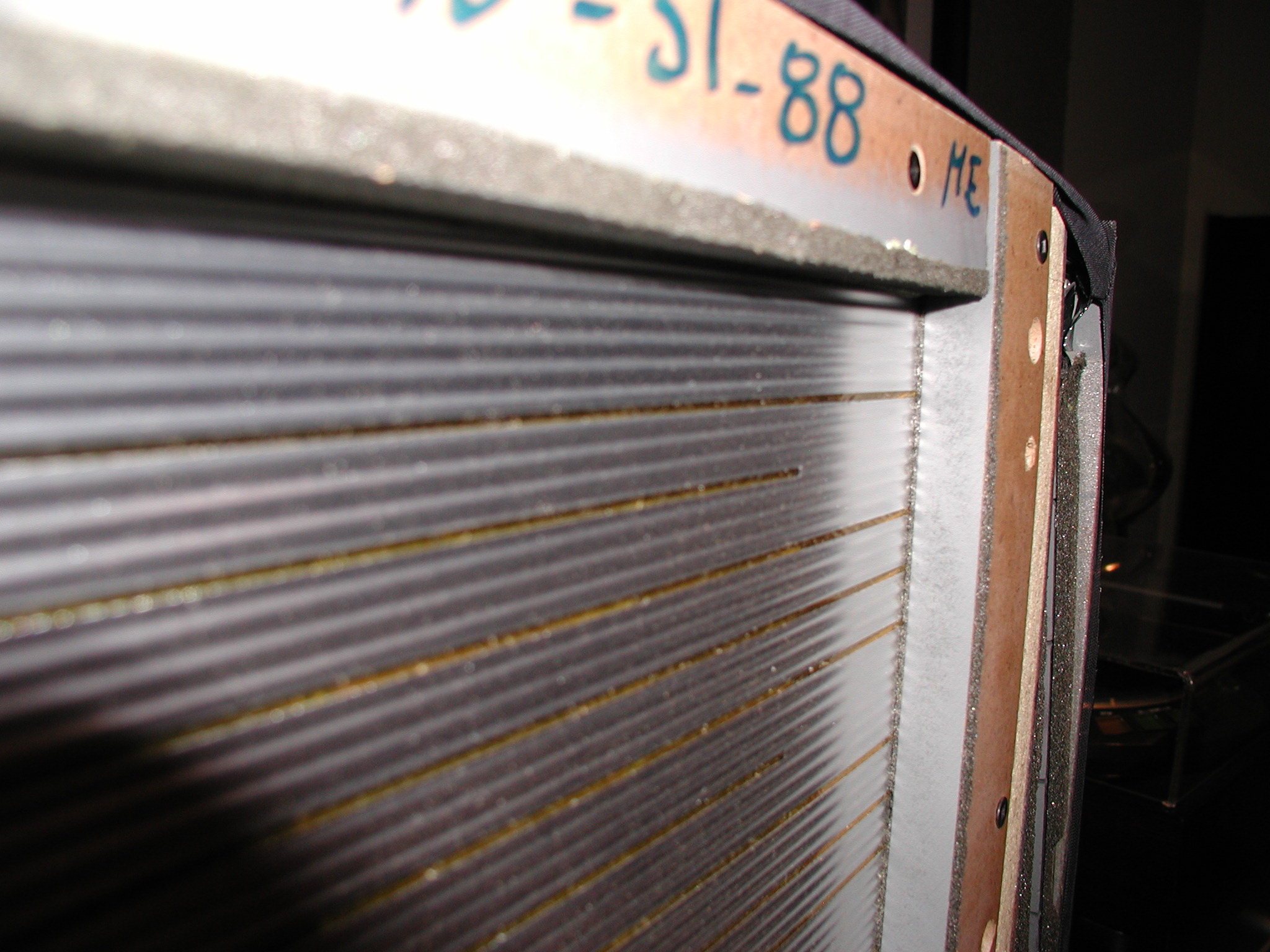

Anyway, started looking around and could really find any fix that I wanted to try, until I came across a crazy fix that was taken down from an Apogee forum I was reading. It supposedly was lost, and nowhere to be found....Finally, from some good detective work I tracked down the lost thread poster on DIYAudio (what are the chances?) A German gentleman that goes by taotao.

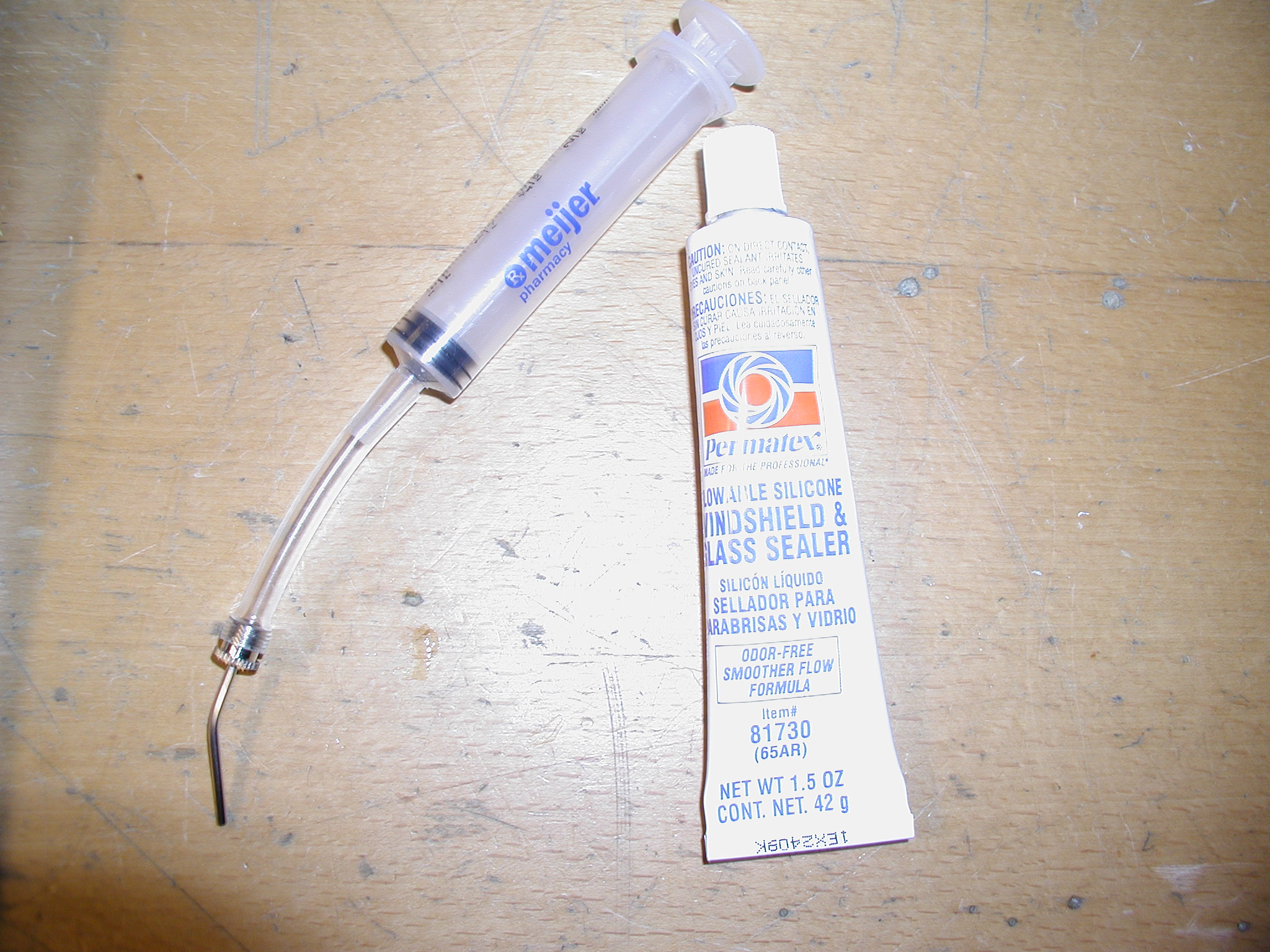

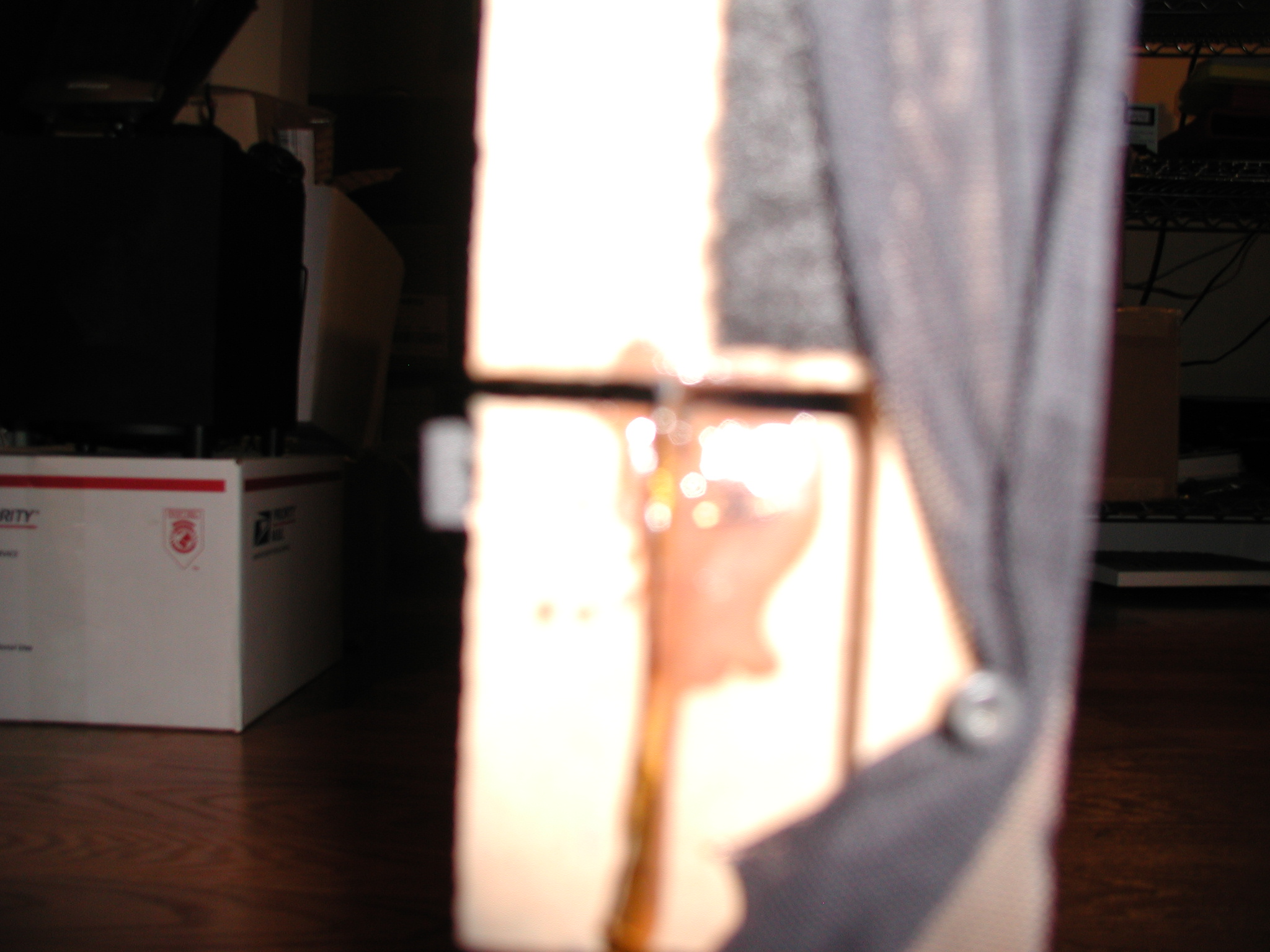

Ok, enough of the history, what the fix? Taotao had an idea to inject a flowable silicon into the deteriorating foam between the wooden clamps. He used some two part mixture, but one of the guys here suggested maybe a silicon that he used for windshield crack repair. I went to Autozone and purchased all they have - four tubes. Called Permatex Flowable Silicone Windshield and Glass Sealer - about $5 a tube. It actually flows ok, but needed to be thinned. Now taotao said he mixed his silicone mixture with 1/3 part silicone oil. I found some 1000ml of Silicone oil on fleabay for $5 shipped - it is from Canon (Fuser Oil S-400) and used for copiers and printers. Anyway, I put together a test batch of this mixture and noticed it flowed real well...let it dry overnight. In the morning, it was very soft, and I thought it would work perfectly.

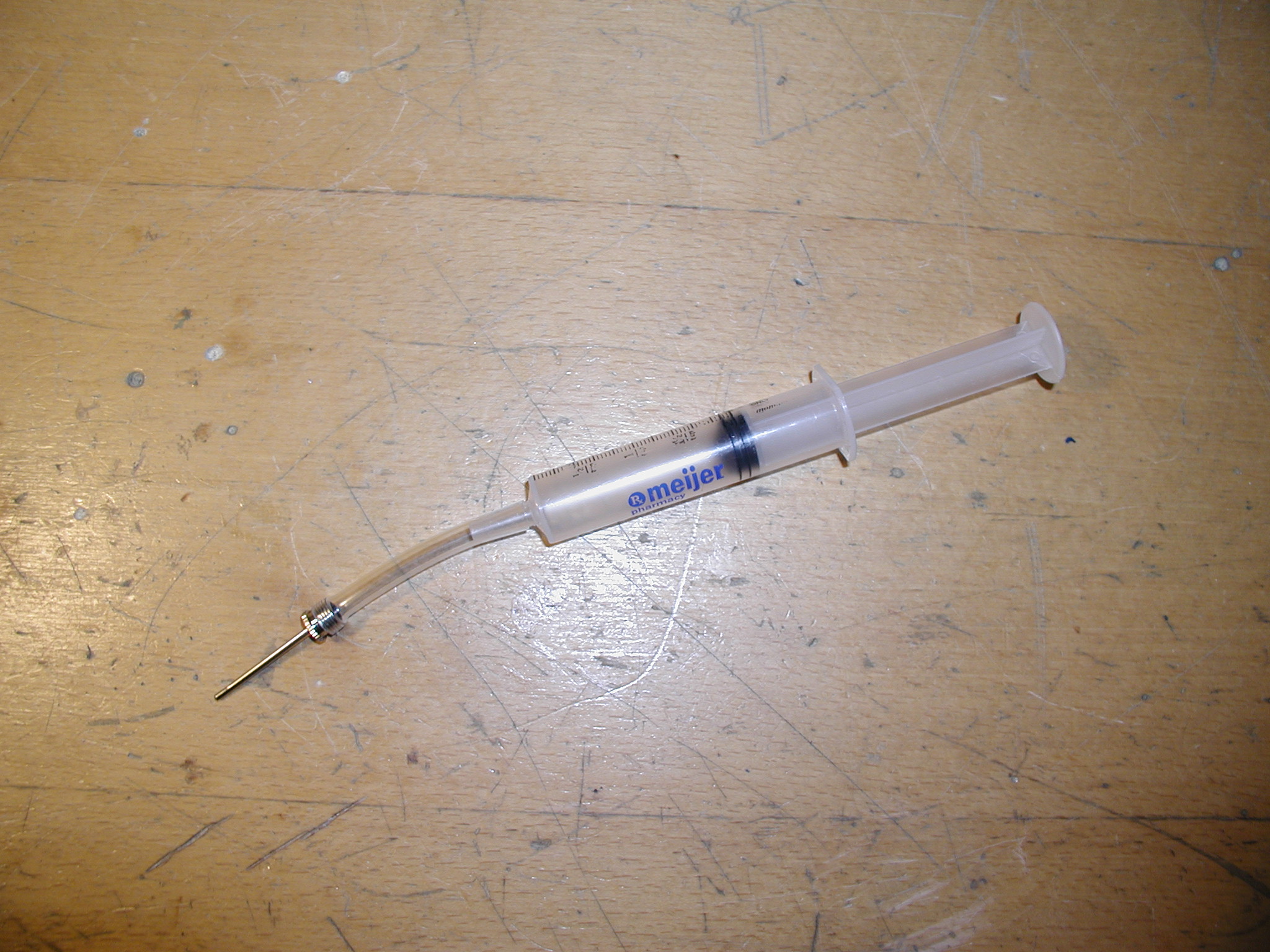

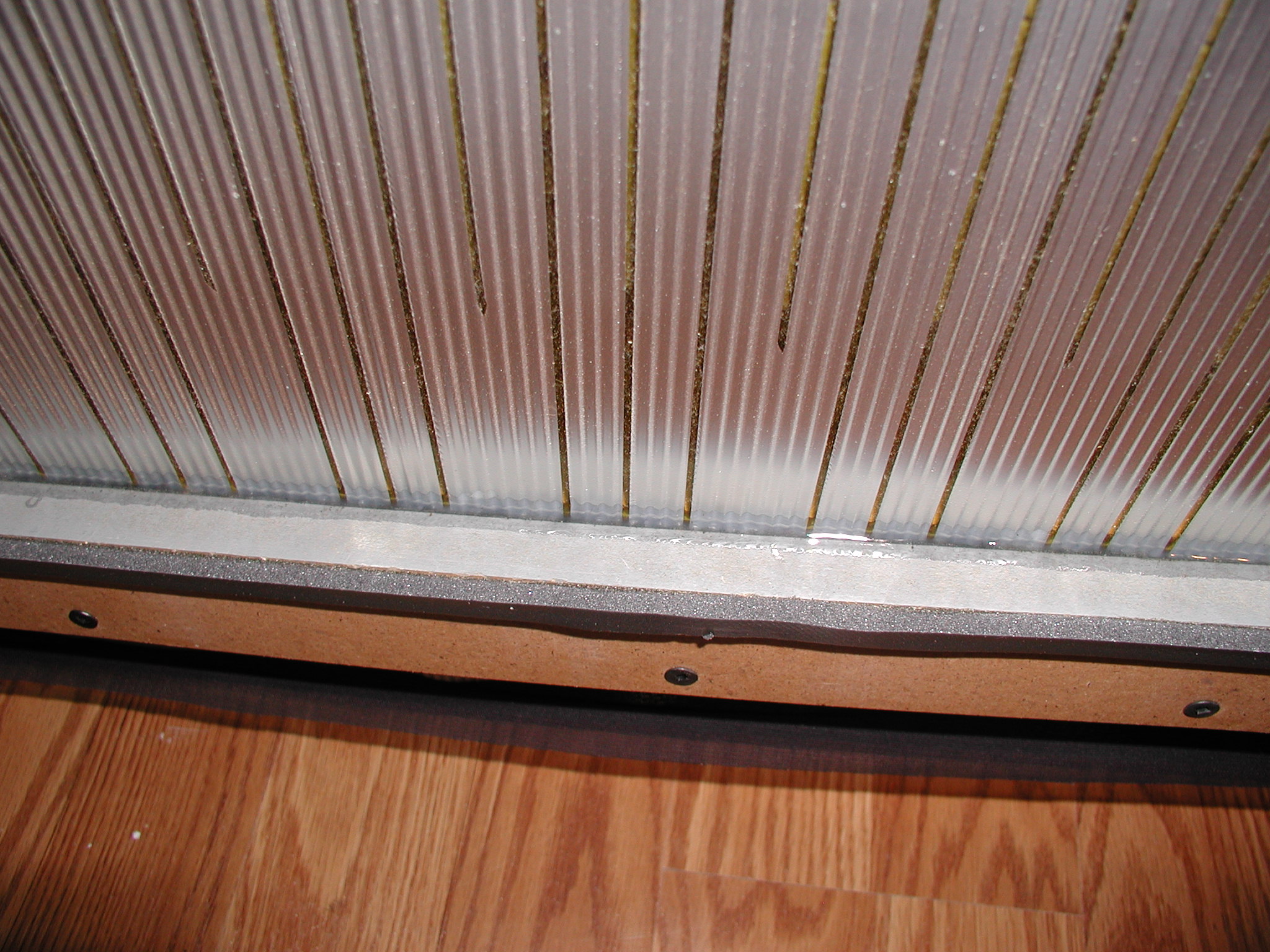

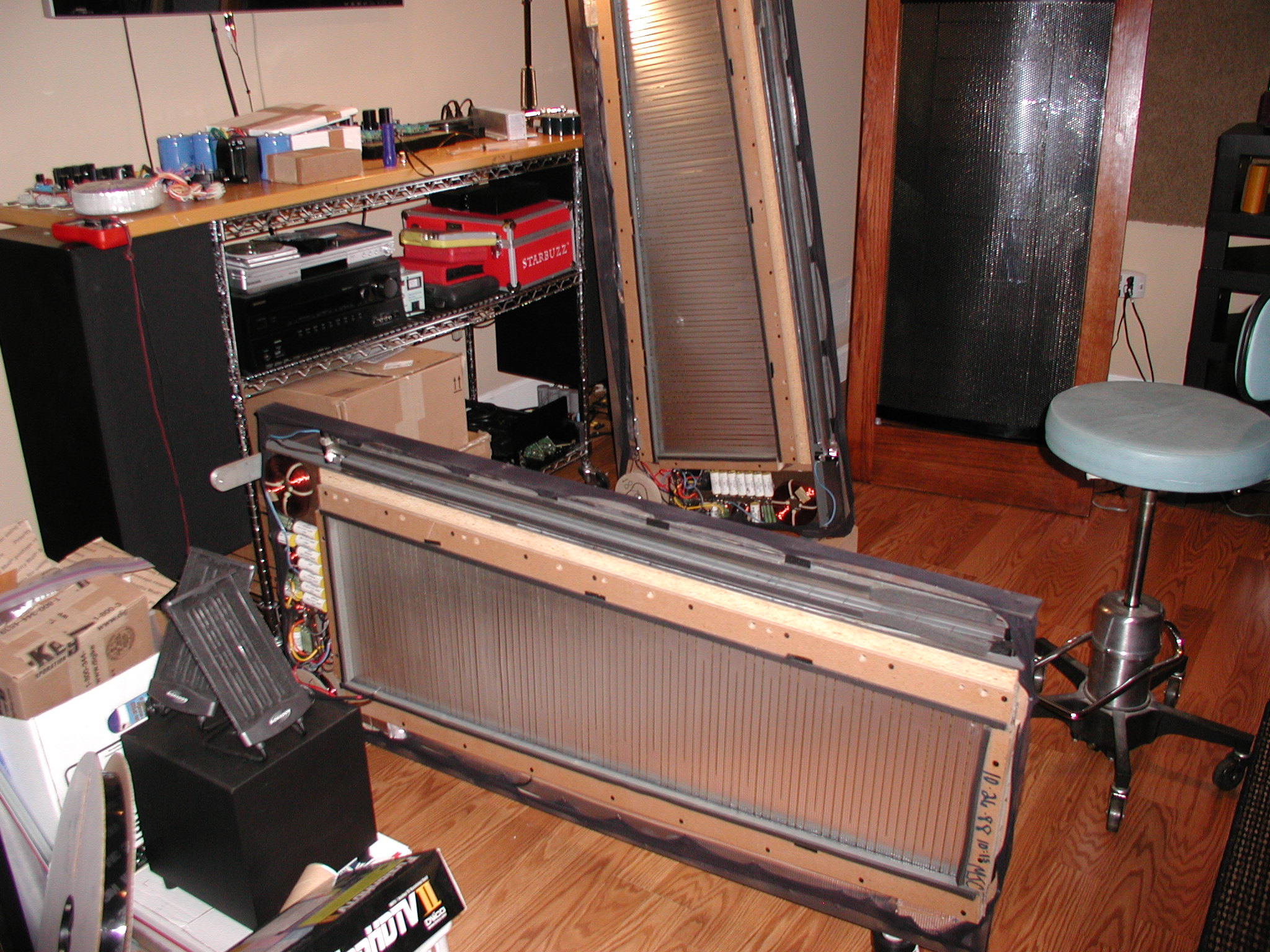

Went to Meijer and picked up one of those kiddie medicine styringe, some 1/4 clear tubing, and a basket ball inflator needle. Pic attached. Laid teh speaker on its side and supported it so it would not tip.Sucked up some silicone goop and laid a nice bead over the front foam, right on top. The foam sucked up the silicone. I just kept laying more beads until the foam cavity was filled. Then did the other speaker, and let it dry for 6 hours. Then I turned it over and did the other front side... Didn't bother with the top or bottom foam...
That took care of the front, but what about the back? Since this mixture is a bit less viscous than honey, I let it drip down the backside foam. I stood the speaker up and injected the silicone along the back clamp corner where the foam seam is, and let it run all the way down the speaker. This took a long time as I couldn't see the silicone when it got to the bottom. Just gave it ample time (an hour). Again, the silicone drip was done through the top of the backside foam corner. I used a lot of silicone on the back clamp drips. All the excess just oozed out onto the clamp face, so no big deal. After enough drip time, I set the speaker back onto its side and allowed the silicone to drain into the foam seam. Then I did the other side and the other speaker, and let them dry a good 6 hours before trying them out. Took me all day today and a few hours last night.
Anyway, no more buzzes...A shout out to taotao - you ROCK... some pics are attached... This worked for me - and a few others - again, your mileage may vary...

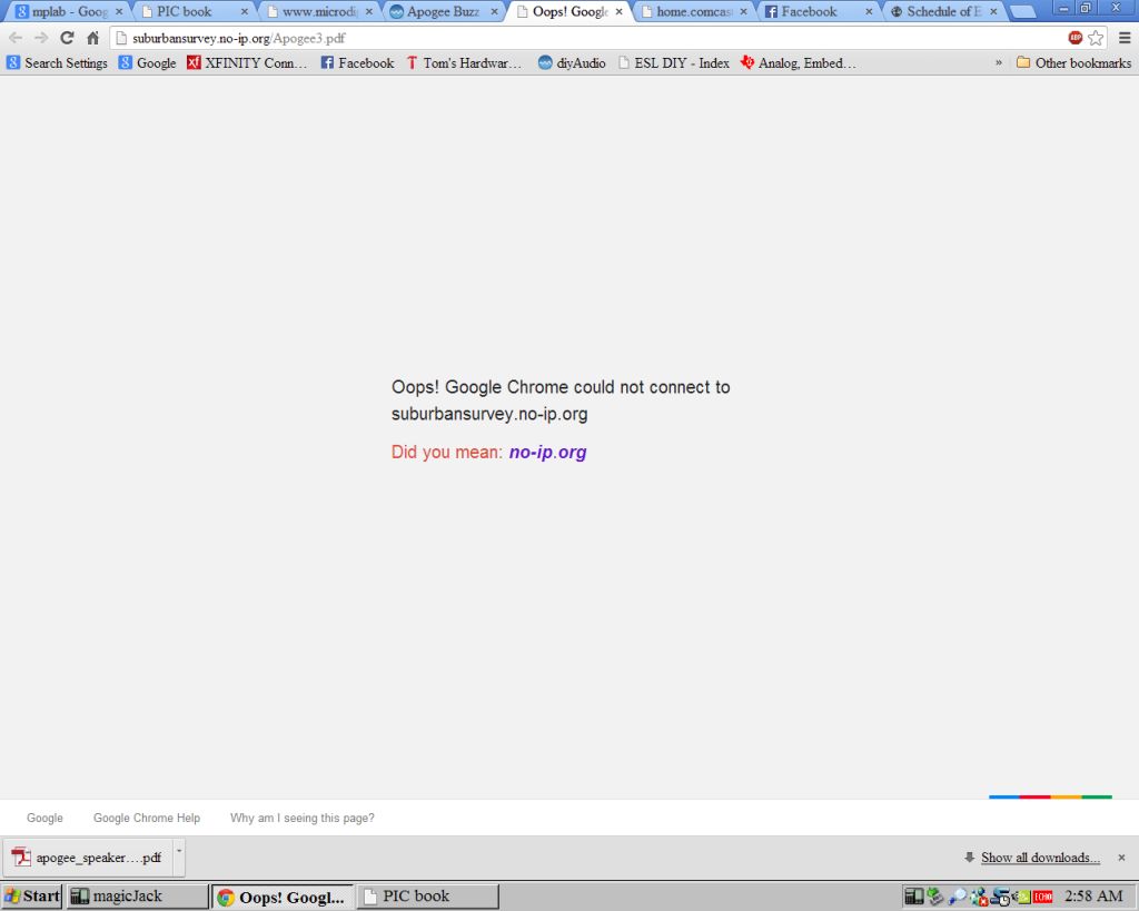

Got the server and links working...apparently my kid set my server up as a Mindcraft server too without me knowing...a little conflict of IPs, now all good. Can't get too miffed at my kid, as he only 10 and understands the basics of setting up servers...well most of it...
Also helps spelling the link correctly - these links should work fine now:
http://suburbansurvey.no-ip.org/Apogee1.pdf
http://suburbansurvey.no-ip.org/Apogee2.pdf
http://suburbansurvey.no-ip.org/Apogee3.pdf
The last one shows the tension requirement for the MRTW ribbon on a Stage (its 95.3 grams)
