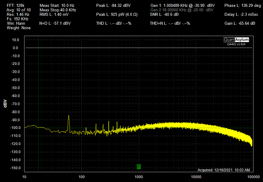

Over the past week or two I have tried many grounding modifications, some suggested by your comments. I will just mention a few: 1 - Running a 3-twist power wiring to the circuit card, made no difference. 2 - Breaking the connection between the star ground and the 115V third wire ground, made no difference. 3 - Placing a 10 ohm resistor between the 115V third wire ground and the star ground made no difference. 4 - Added more power supply bypassing close to the chip pins, at C9 and C11, this did not seem to have much effect. 5 – Tying the star ground to the amps positive input made no improvement (see attachment 1). 6 – Moving that star ground wire to the ground plane of the PCB at R12 made an incremental improvement (see attachment 2)
Note from Post #1 the photo with the amp opened up. All the testing so far has been accomplished with that geometry . Occasionally I have noted strange differences in readings from day to day. This prompted me look into the isolation or not of the chassis top. Attachment 3 shows the distortion spectrum with the chassis top floating. Attachment 4 shows the spectrum when the chassis top is firmly connected to the rest of the chassis, as would occur once it is put back together again. Some incremental improvement is noted.
The 120Hz IM is still a problem.
1audio, thanks for the comments. The oscillograph in Attachment 5 shows the amp output on channel one and the output through a 1KHz notch filter on channel 2 (1KHz at 1W / 4 Ohm). I see some crossover distortion, maybe someone else will see a lot more🙂.

I would first separate the safety ground from the signal ground. A 50 Ohm resistor between them is enough isolation usually but disconnect for testing to make sure you do not have a ground loop. The QA USB interface is isolated but you can still get noise coupling through it.
The HF spikes in sync with the signal are a little distressing as well. Are they modulating with the power line?

Hello All,
I took 1audio’s suggestion of looking at the power supply output with the scope. The results are not encouraging. The attached oscillographs show the amplifier output (1KHz signal at 1 watt into a 4 ohm load) on channel 1 and either the unregulated or regulated power supply output on channel 2. Attachment 1 is the unregulated supply and Attachment 2 is the regulated supply. The unregulated supply has about 300mVpp of 120Hz ripple while the regulated has about 90mVpp.
It is not clear to me that if I just eliminate the regulators and use the unregulated supply I will be any better off. The unregulated PS cards are not positioned well for that use, so I will probably have to rearrange the components within the chassis. Then the question is, why not just replace them with a properly designed PS.

I think there is something not right in ground references here. The regulators seem to be falling out of regulation on the peaks. My next step would be to look at the chip itself differentially, between the ref pin and the output pin. I would also look between the ref pin and the negative speaker connector. There should be millivolts of ripple in both cases. 1.4V across 4 Ohms load is a peak current 350 mA. That should be well within the range of a LM337. It looks like the regulator may be referencing something that is not at the star ground level. The high level of 1 KHz ripple on the supply ripple suggests that the bypass caps at the amp are not working right.
Seperate question- will the LM337 handle the peak current in your application?
Have you confirmed your 4 Ohm load is 4 Ohms? Sometimes you need to check everything.

There should not be that interaction with the "safety" ground. It suggests some not obvious connection somewhere. Can you measure the DCR between the power supply ground, the signal ground connection, the low side of the input connectors and then the common on the output bypass caps? The data from Apex is not clear about that ground connection on the PCB and verifying that all the ground are connected is important.
When you had it connected to the external supply was the safety ground open? it seemed to be clean then.

I set up the QA401 for differential measurement with a 1MFD capacitor in each leg. With the amplifier operating with a 1KHz signal at 1W into 4 Ohms, I made measurements on the negative leg of the negative regulator (I am assuming the term reference pin is the same as the datasheet’s adjustment pin): Attachment 1, shows the distortion spectrum between output and ground of that regulator. Attachment 2, spectrum between the reference pin and the output pin. Attachment 3, spectrum between the reference pin and the negative speaker terminal. My reading of this data is that the 120Hz noise is at about 13mV or less, which would probably be considered low, do you agree?
I agree that some stray ground connection could be in play, but I have spent a lot of time looking for it, and have not found it. The resistance between the PS ground and the low side of the input connector is 0.087 ohms. I am not sure what the “common on the output bypass caps” is.
