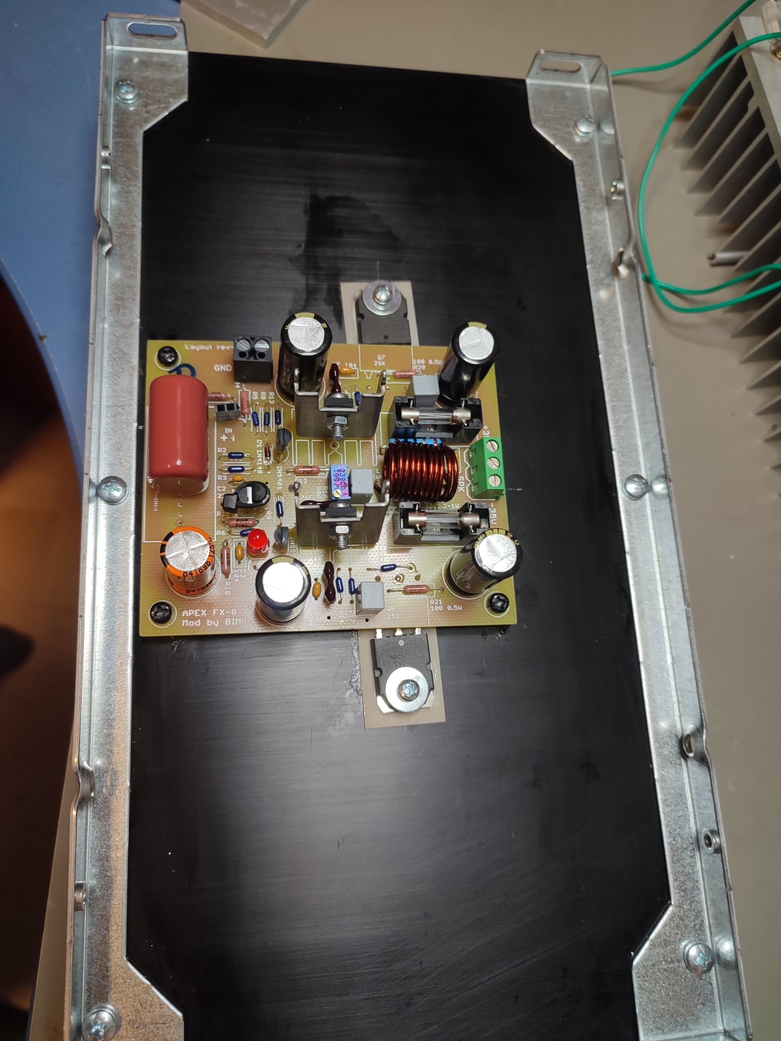

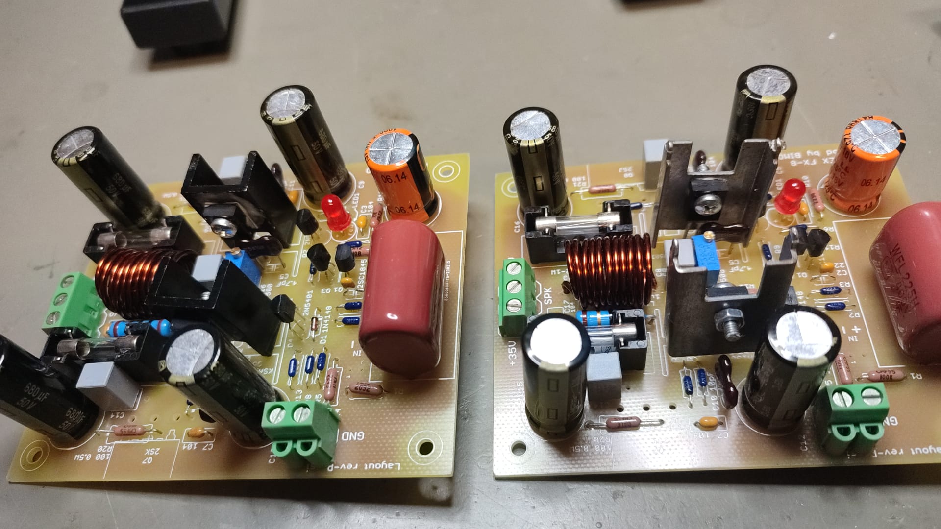

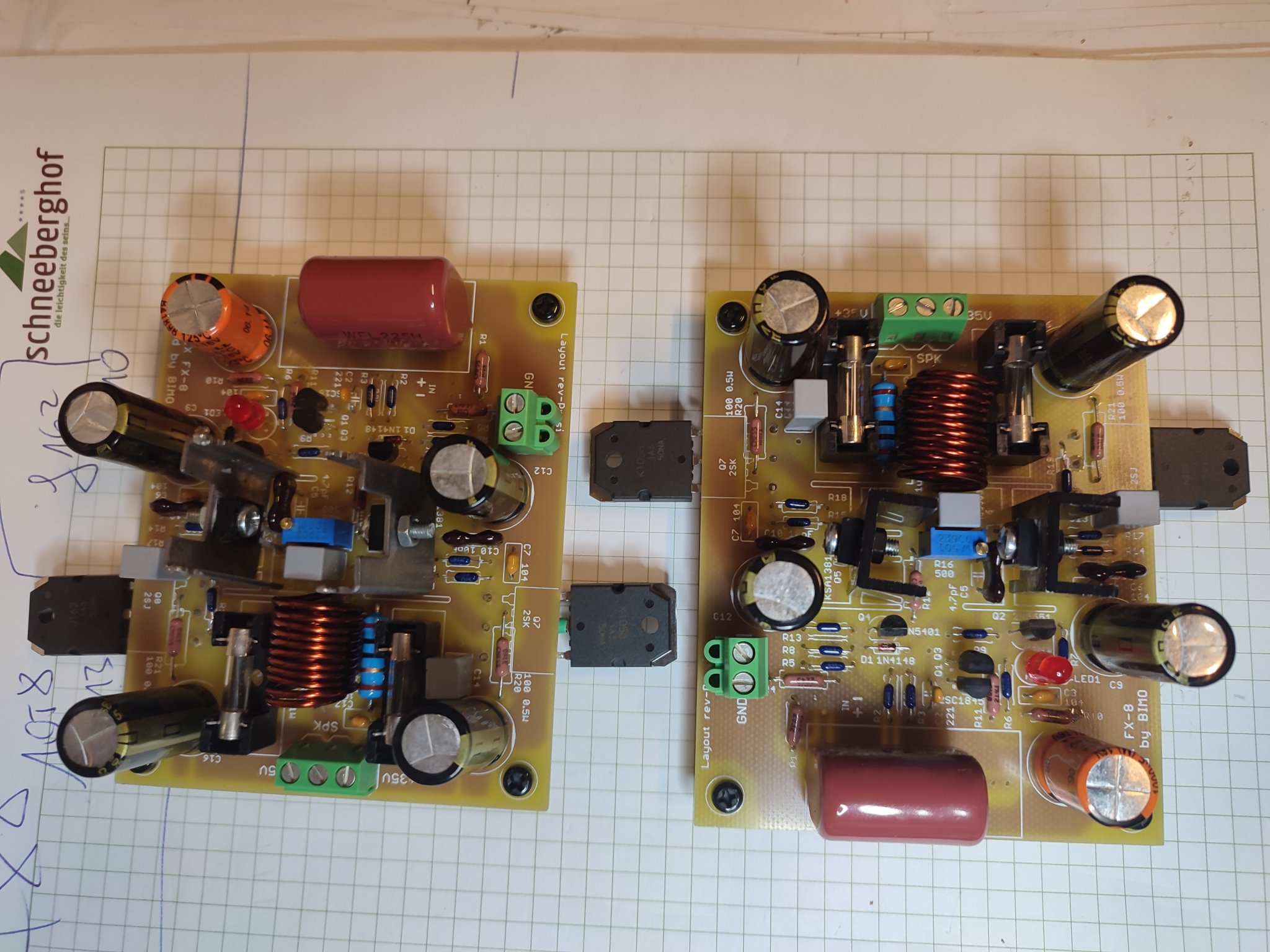

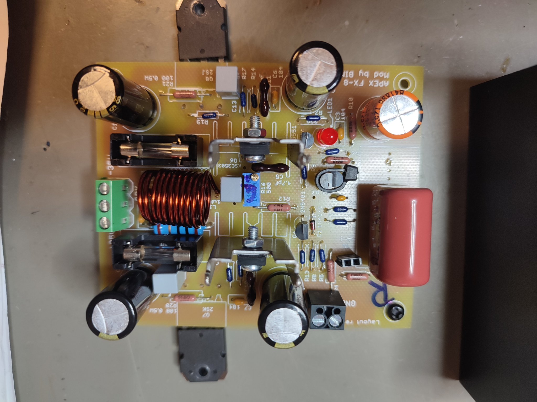

Hi
The big thread of "100W Ultimate Fidelity Amplifier" is a chaos.
i need time to search through all the page and mark all i can find.
pcb is done in yellow by jlcpcb.
Gerber and all other documents are in post 13908: here
input BJT i use the recommended KSC1845, driver are 1381 and 3503, power mosfets are the renesas 1058/J162
as C4 it is written 220µF, and XRK use a polymer elco with 330µF. I use a orange 1000/16VµF by epcos
for C9,C16, C12, C15 i use Panasonic 680µF/50V
input cap is a red
polymer panasonic 2,2µF/400V instead of 10µF
i use the lower gain setting R11, R12--> 550R and 20k

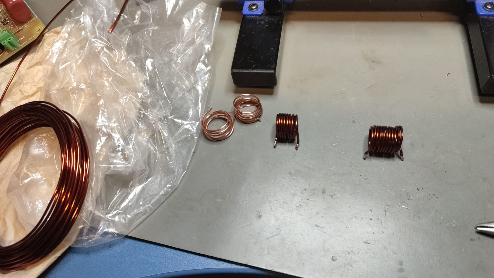

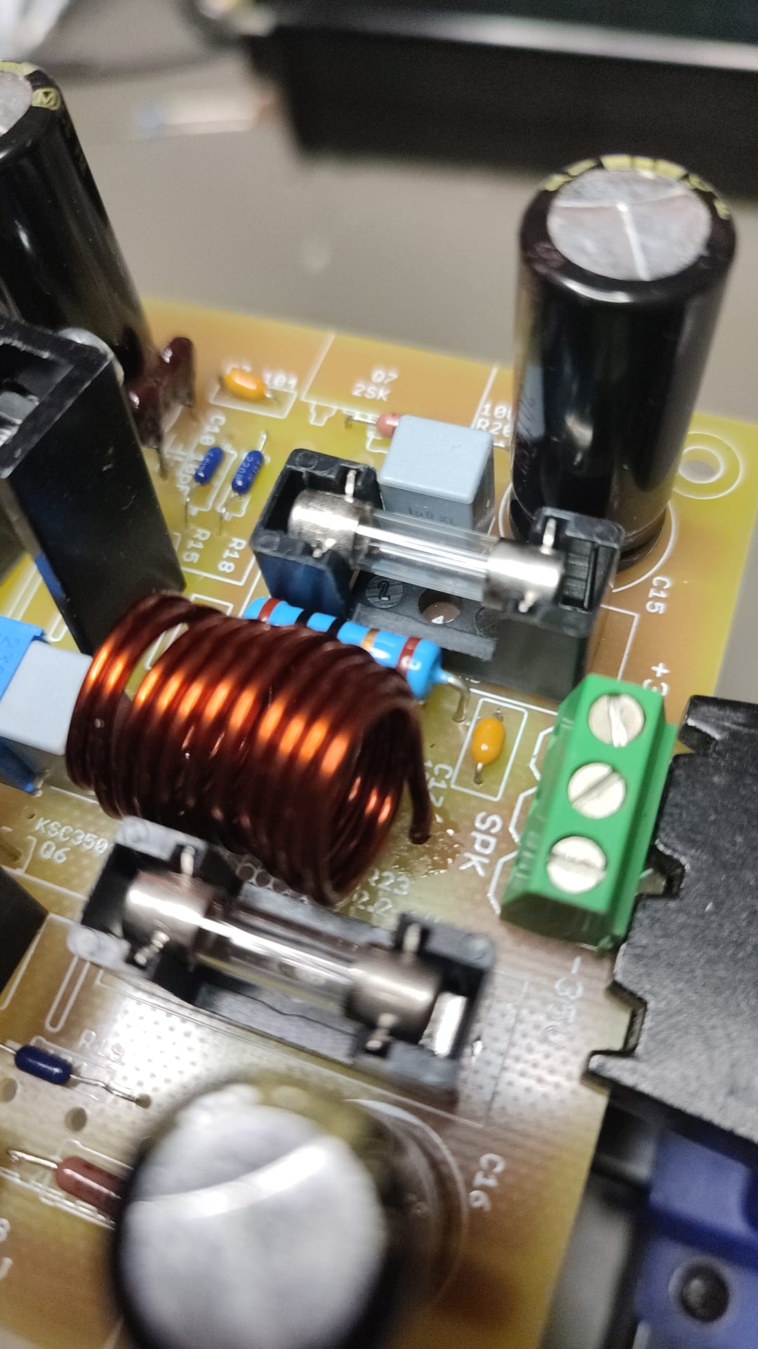

i did my first output coil...its not nice done but it has about 0,9µH the resistor is under the pcb
bias setting:
post 6686 bias at 100ma-170mA, wrote about goldmund amps--> bias 200-300mA
my bias is set according to the hint of post 7753 by bimo to 400mA. the amp is working fine.
post 6971 test by XRK as an Class A amp with 1,3A works fine...big heat sink is needed!

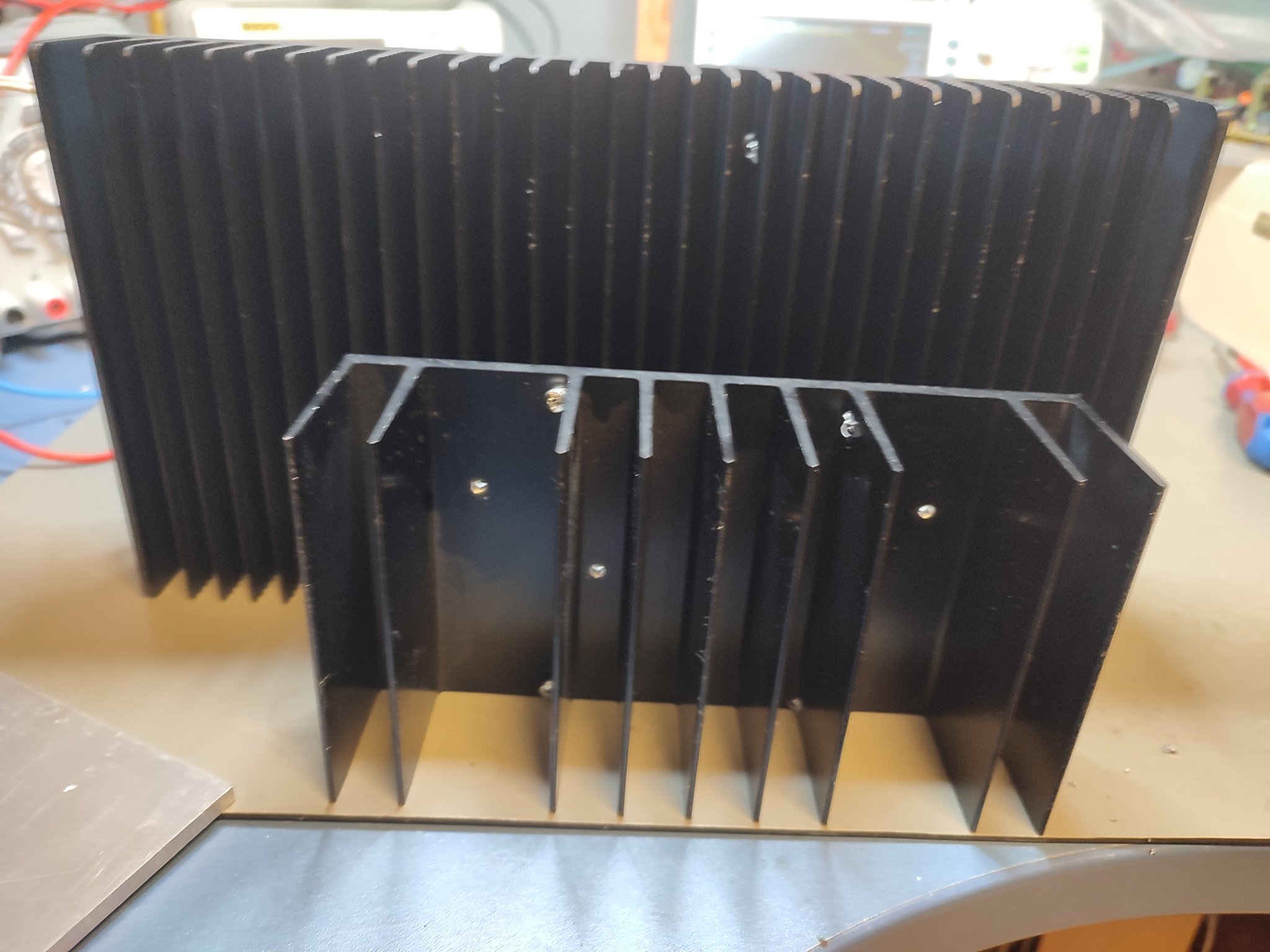

i used for the first test a 0,65K heat sink.
i plan to use a 4U/300 case by modushop with a 300VA 2x24V sec. transformer
i will just check the other channel.
psu voltage is 31 per rail and bias is after 2 hours 420mA stable. no heat problems, no smoke..
Gain is about 31dB, at 8ohm load about 29WATT.
if you have any hints , let me know.

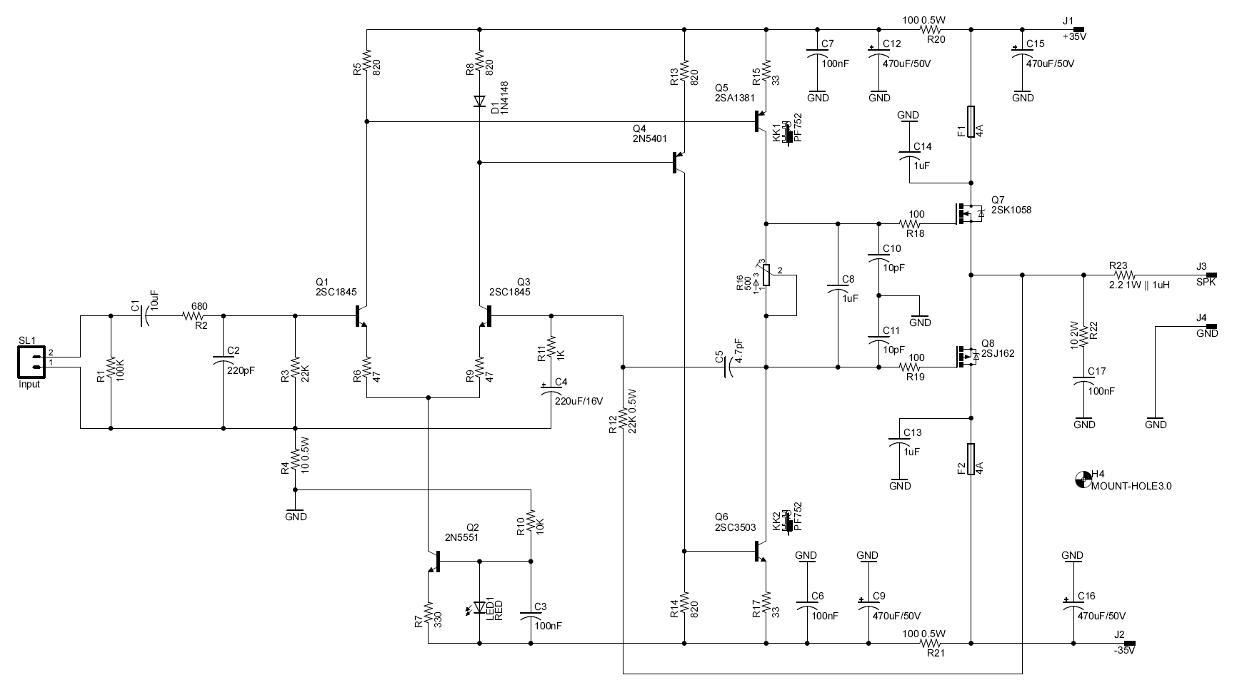

oh ....i forgot....C5 FB cap is 5pF mica...not 4,7µF
Voltages @31V supply rail and 420mA bias: both channels a very closed together so i write one channel :
input stage:
R5: 1,275V
R8: 1,412V
R6: 78,5mV
R9: 81,9mV
CCS:
R7: 1,294V
Driver:
R13: 1,468V
R14: 1,285V
R15: 0,61V
R17: 0,625V
Gate to Gate Voltage directly on the MOSFETS.....to have an idea .... is 2,74V
kr
Chris
input stage:
R5: 1,275V
R8: 1,412V
R6: 78,5mV
R9: 81,9mV
CCS:
R7: 1,294V
Driver:
R13: 1,468V
R14: 1,285V
R15: 0,61V
R17: 0,625V
kr
Chris
Bias setup
done by prasi: post 9995
bias procedure |
Procedure for bias. |
1. you will need 2 nos. of 10ohm 1W/2W resistors. |
1a. turn the trim pot so that resistance between first and third leg of trimmer is approx 250 ohm. |
2. Connect one lead these 10ohm resistors in series with your + and - rail wires of psu. |
3. connect the other lead of resistors to amplifier +/- supply connector on amp pcb. |
4. switch on supply and measure the voltage drop across these rail resistors. |
4a. measure the voltage between spk out and ground. this is offset. it should be less than +/-30mV. Good matching of Hfe of i/p transistor pair (Q1/Q3) will ensure that offset is close to zero. |
5. total quiescient current is given by I= V/10ohm |
6. set the pot so that voltage drop across 10 ohm rail resistors is about 1V to 1.1 V. |
7. Let the amp warm up for 1/2 an hour recheck the bias |
8. Adjust pot if required to have voltage drop of 1 to 1.1 V. |
9. This will ensure that you get a bias through o/p stage of approx. 100mA. |

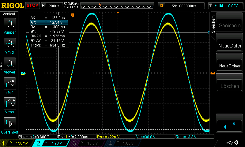

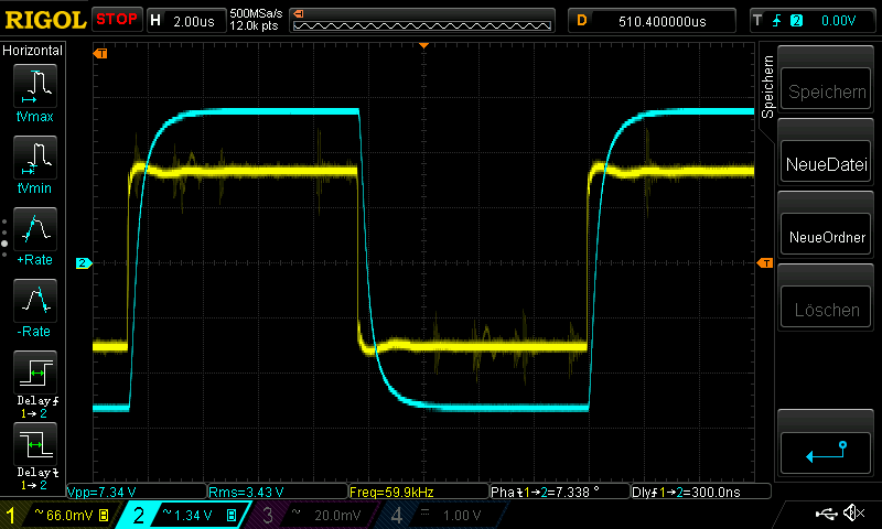

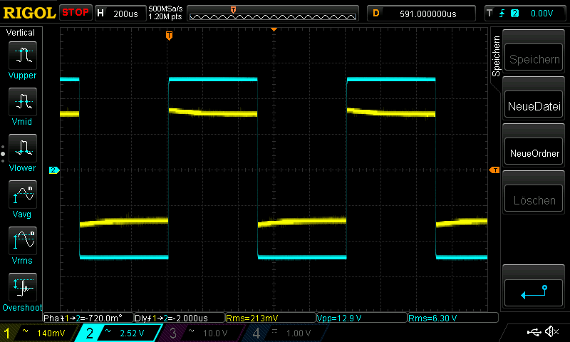

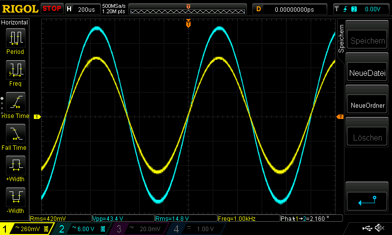

short measurements with the Rchannel yesterday night evening.
8R is so far no problem
yellow ch1 on oscope is input
blue is ch2 the output
pic1 8R 31Vrail_420mVrms 1kHz input we get about 27 WATT...looks okay
pic2 8R square with 100mVrms 60kHz input
430m-440 Vrms input is about the max power without clipping--> 28WATT

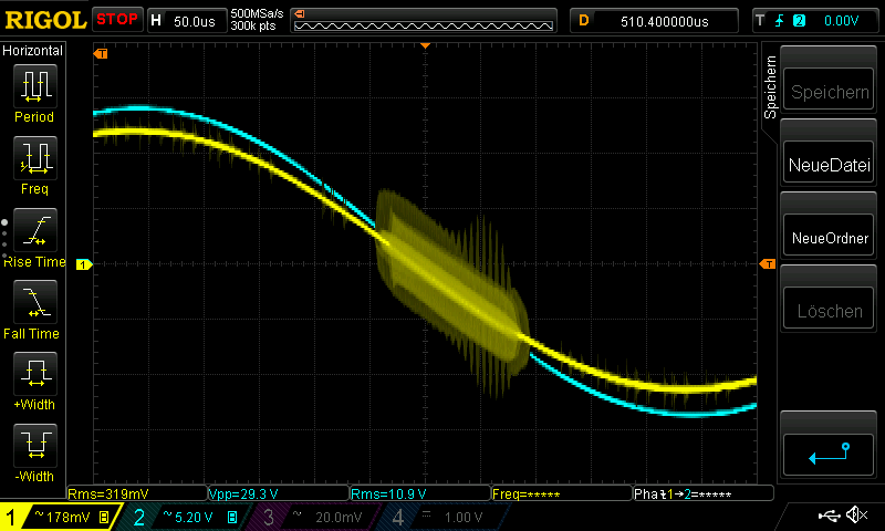

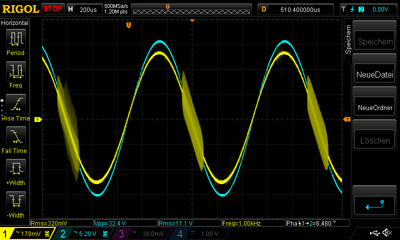

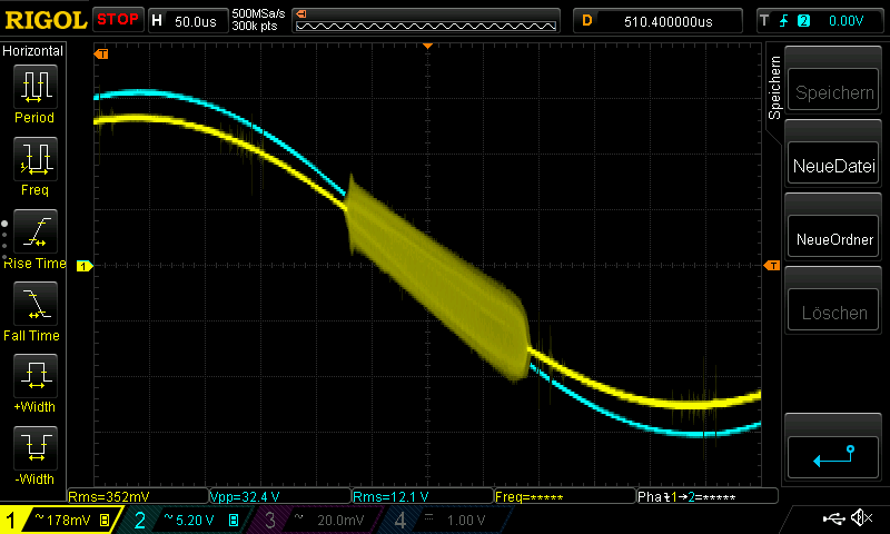

R channel with 4R i got oscillation problems on the input = yellow channel 1 scope ????!!!!!
at 4R load it start at 290mVrms input and gets bigger nearly at the max. (350mVrms input) of input and then it dissapears!
370mVrms is the max input and we get about 40Watt at 4R.
is that because the C5 with 5p is not correct. or is the gain in my amp too high.
as i remember my input Transistors ksc1845 had 470hfe and my driver trans about 137hfe.
any comment and help is very welcome because i use 4R loudspeaker
good morning.
i changed the Rchannel pcb to the Lch pcb and i have the same issue.
so 2 options could be:
1. it is a measurement (scope probe without shield at th input terminal of the amp) behavior and i have no problems in "real life"
2. i have an oscillation problem on both channels
any ideas?
i appreciate your help
thx
chris
any ideas?
thx
chris
i did another test. with an extra probe.
i found that the oscillation is not before C5 and before R12 so at the "power side" of the amp is clean!
so the oscillation is at input stage what I probe around.
both channels
ideas?
both channels
ideas?

Success ! FX 8 is working oscillation free!!
why? i found a bad connection at GND on the fg!...🙄

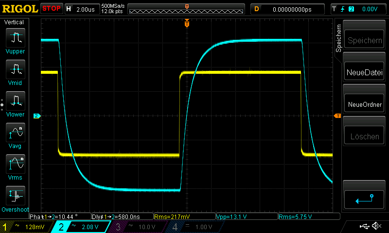

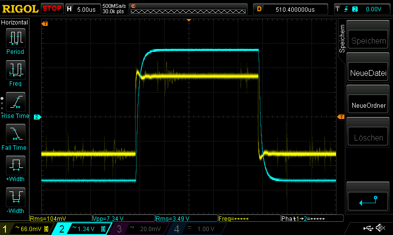

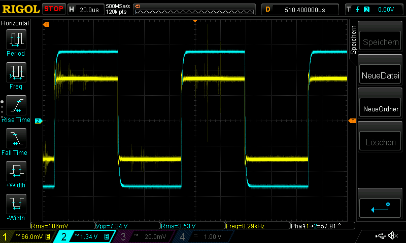

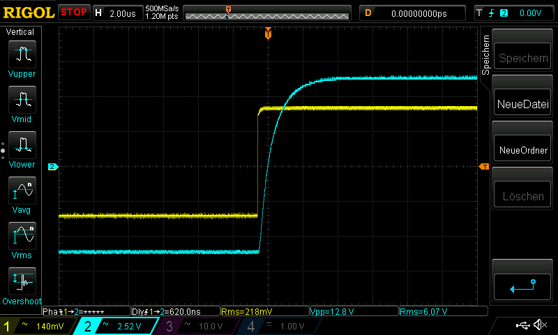

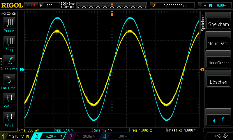

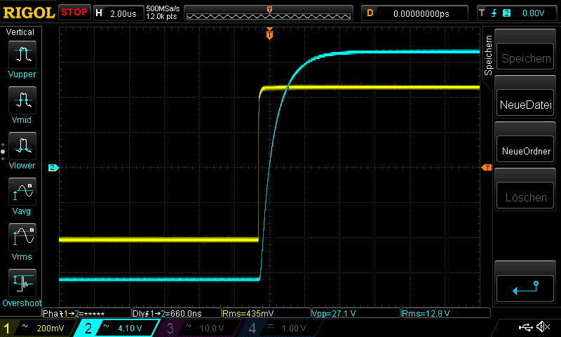

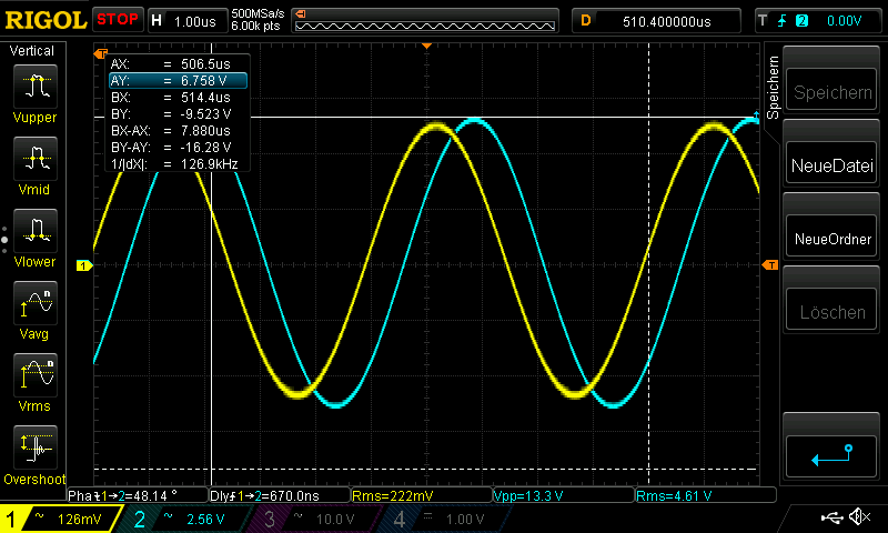

here are some measurement with.
setup:
31Vrail power supply 4,45R 40WATT resistor load. amp mounted on a 4U/300mm heat sink (modushop)
bias 420mA.
pic1 210Vrms input sinus is 10Watt on 4,45R at 200khz is fg..about 70,7% of 1khz signal
pic2 420mVrms input sine max power at 4,45R load about 39WAtt
pic 3,4 210Vrms square to check ringing or slew rate
setup:
bias 420mA.

GAIN
any ideas why i have still 31db with the low gain setting R11 R12 (24db should be)
i check some BC550 or BC557 low noise but they have the some hfe range
ideas?
ideas?
