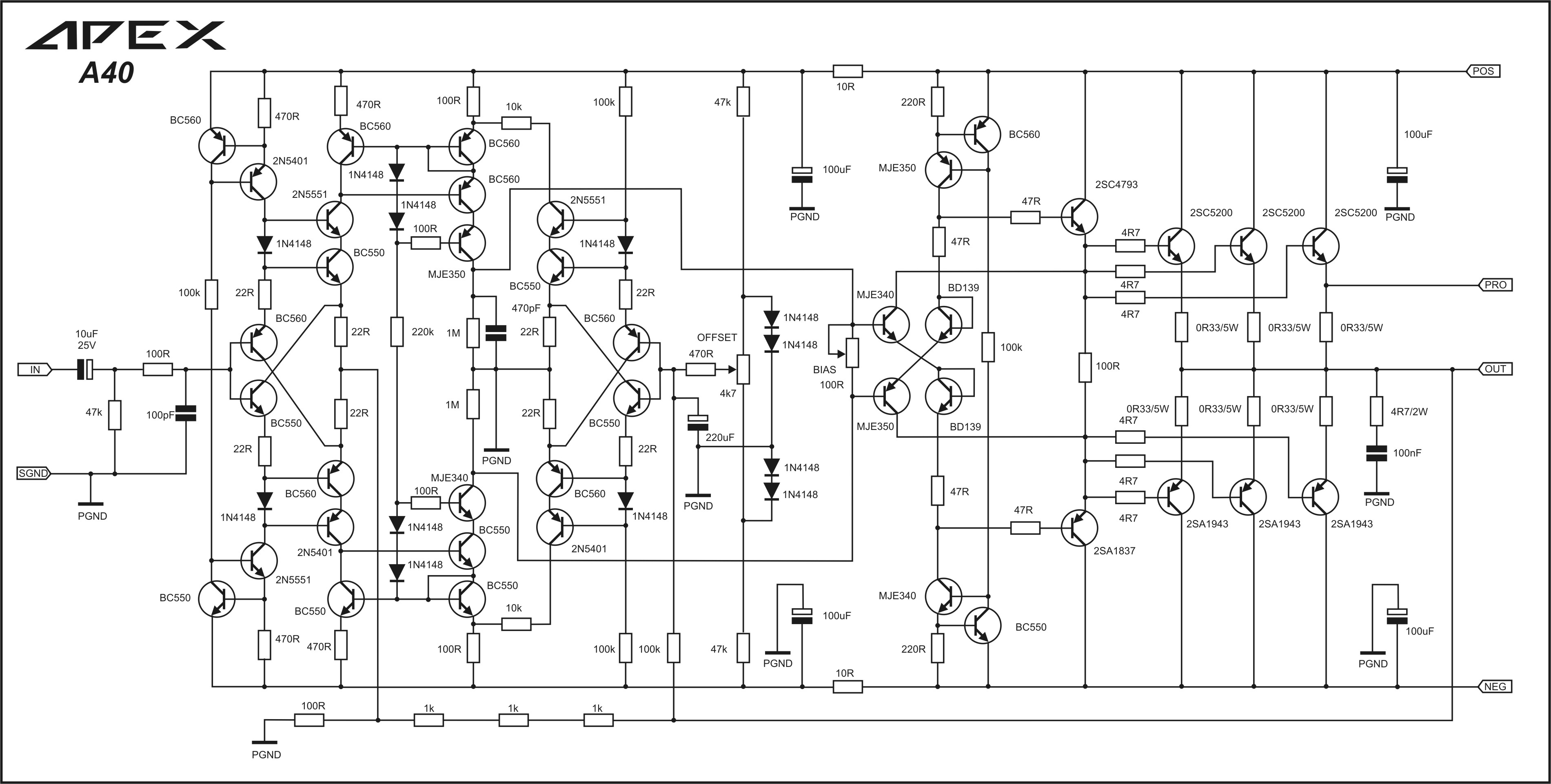

This is a dedicated thread to the Apex A40 Amplifier. Feel free to share your build and discuss and share information about the A40.
I will do my best to keep this 1st post updated with as much information as possible. I am still building this out, please be patient. If there are any errors please let me know! 🙂
The Project
The Apex A40 Amplifier was designed by Apex Audio and kindly shared to DiyAudio community. He has continually shared various designs, revisions and countless feedback over many years. All of his designs are popular and well endorsed by many experienced members in the DIYA Community. The original thread can be found here - 100W Ultimate Fidelity Amplifier - diyAudio

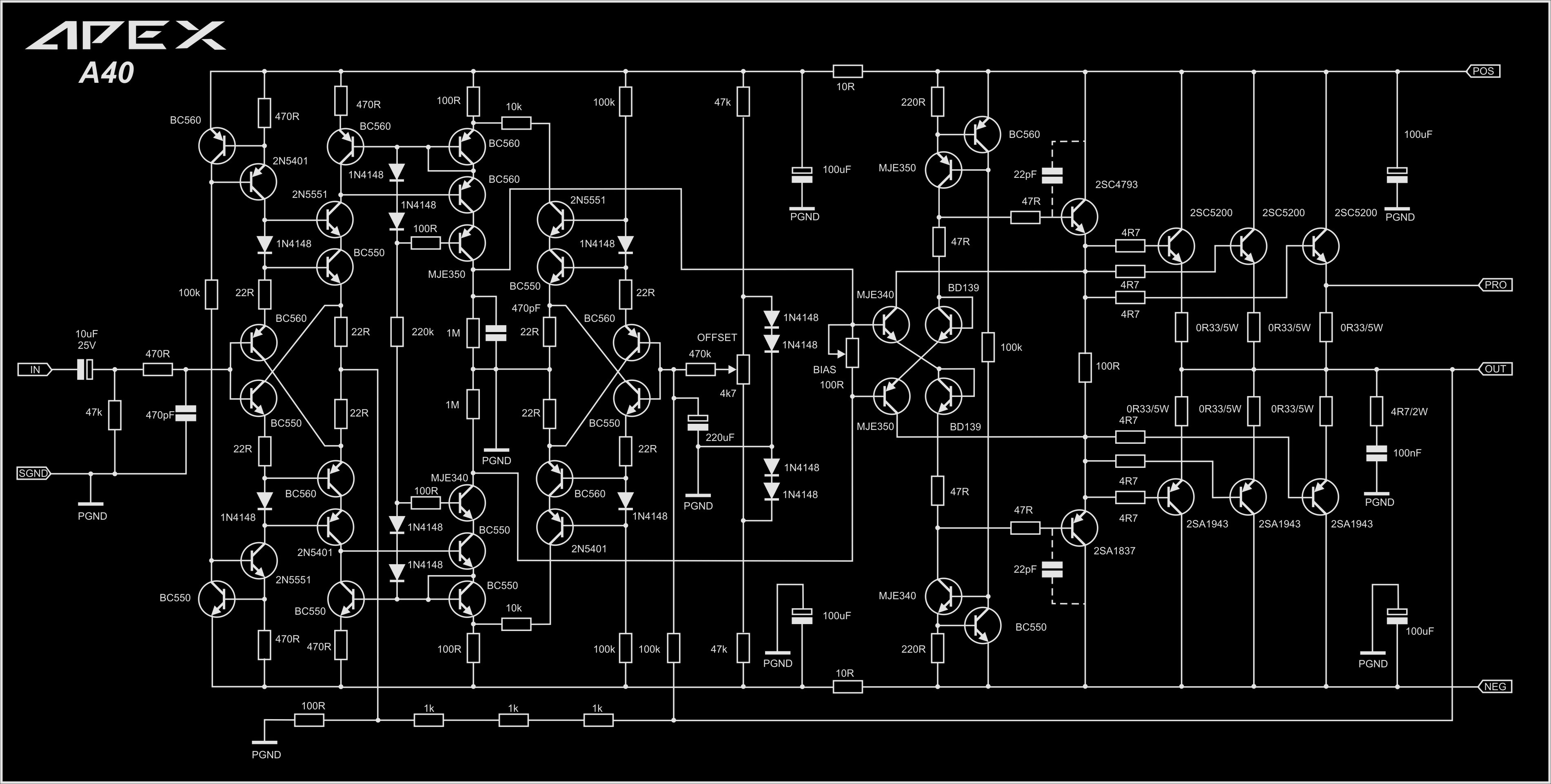

Schematic
Apex A40 Files

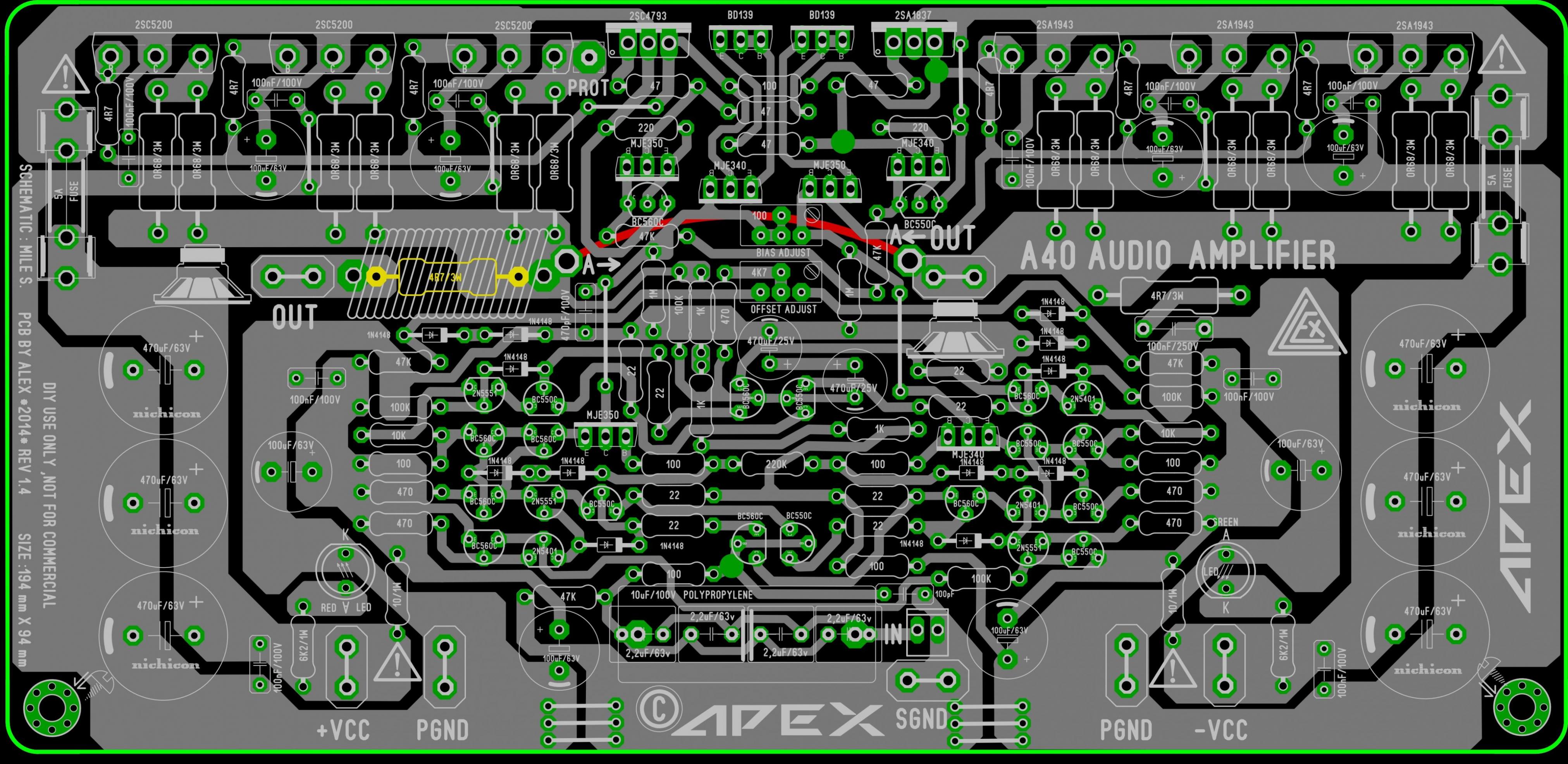

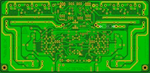

APEX A40 FILES
Includes - Gerbers, Mirror PDF, Schematic, Top view.
APEX PROTECT FILES
Includes - Silkscreen, Mirror PDF, Sprint File.
APEX PROTECT FILES
APEX A40 CFA ALL CRAY RED BLACK TOP VIEW By ALEX MM rev1.4.pdf278.3 KB · Views: 1,362

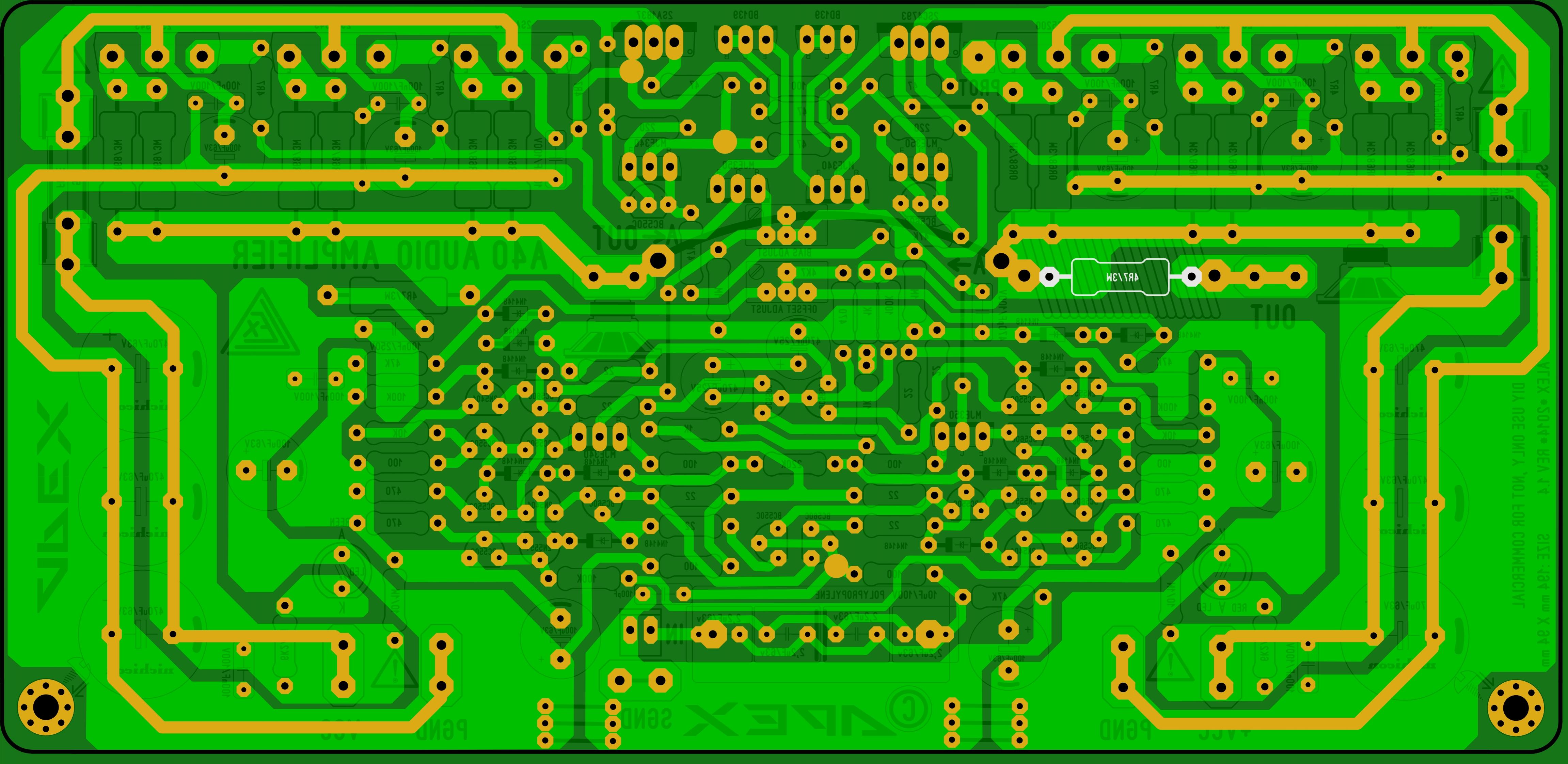

More APEX A40 FILES
These files I've listed as Version B only to help all the files from getting mixed up. 🙂
A40 CFA APEX TOP SILK SCREEN MIRRORED rev1.4 (Version B).pdf329.3 KB · Views: 858

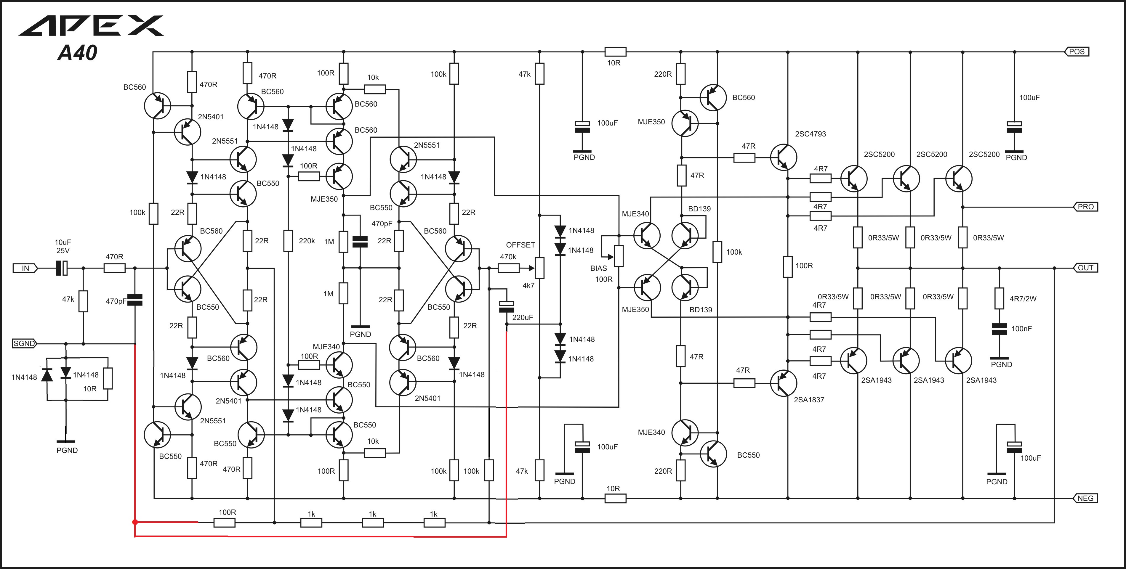

APEX A40 SCHEMATIC From Directory of Apex Audio Thread.JPG620.4 KB · Views: 5,434

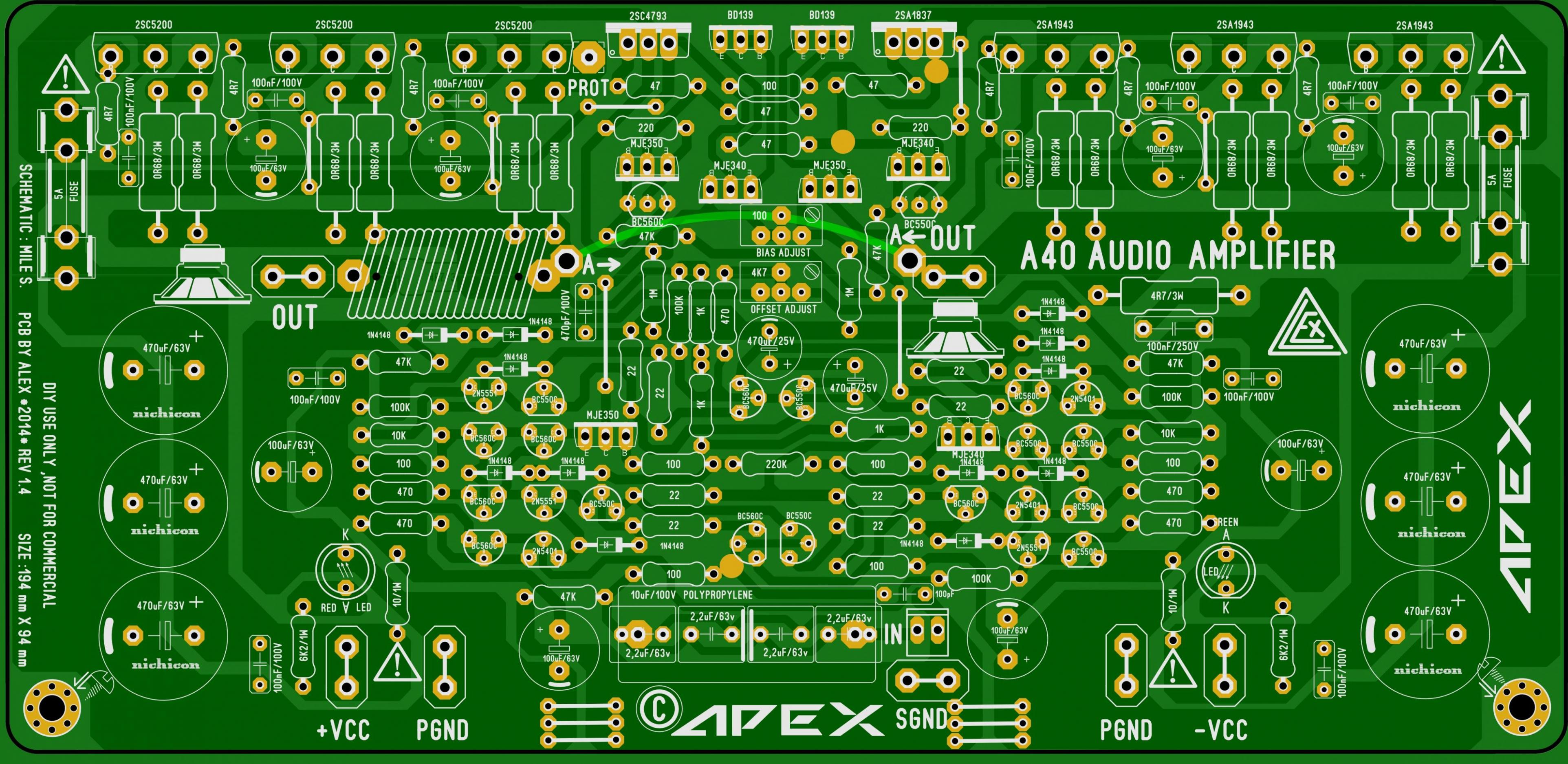

Is it possible to feed A40 with +/-75vdc? Output devices are sanken's a1216 c2922.
Hello every one
Yes you can feed A40 with +/-75vdc.
Any modification?? Change in resistence values and bias
No changes

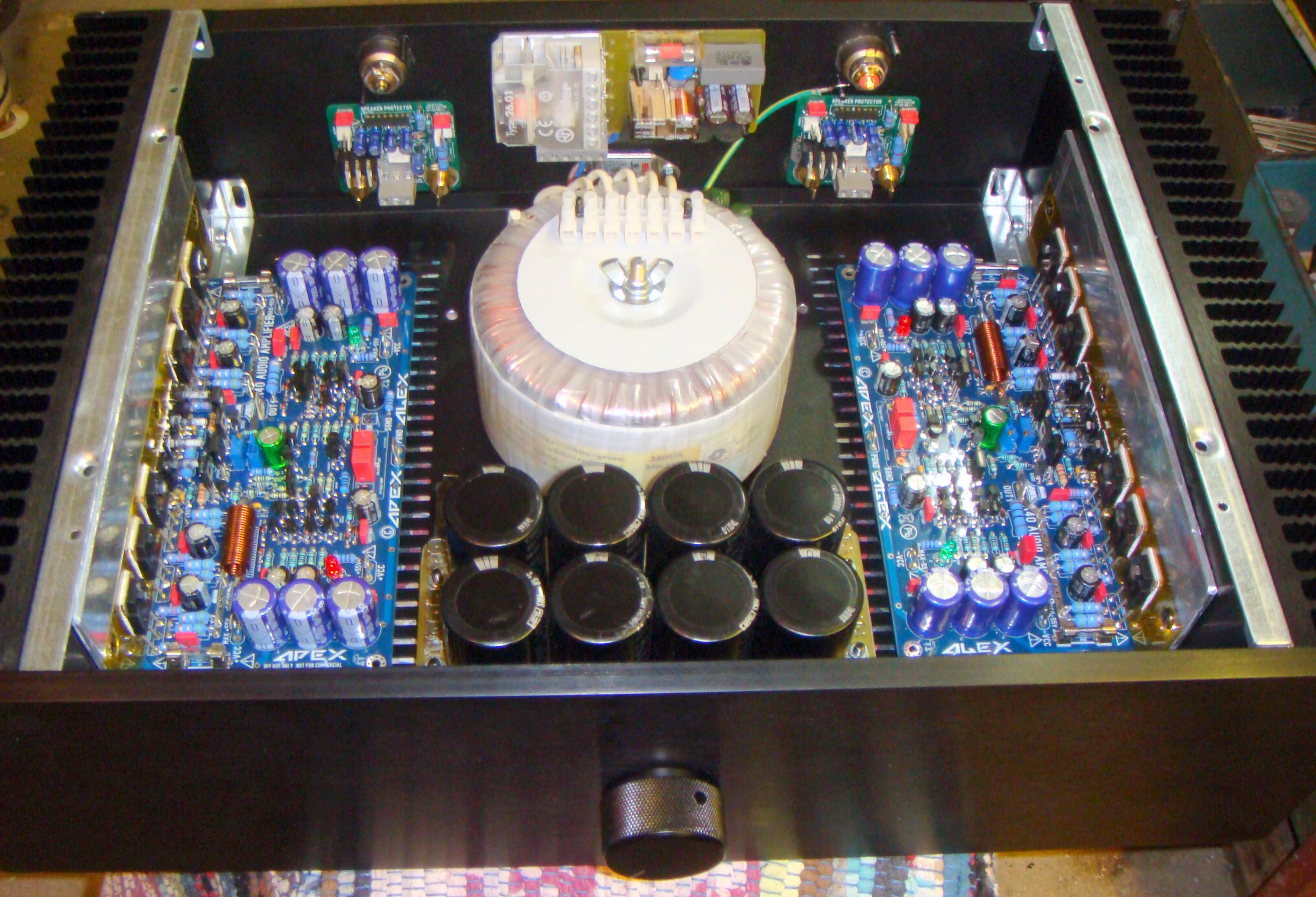

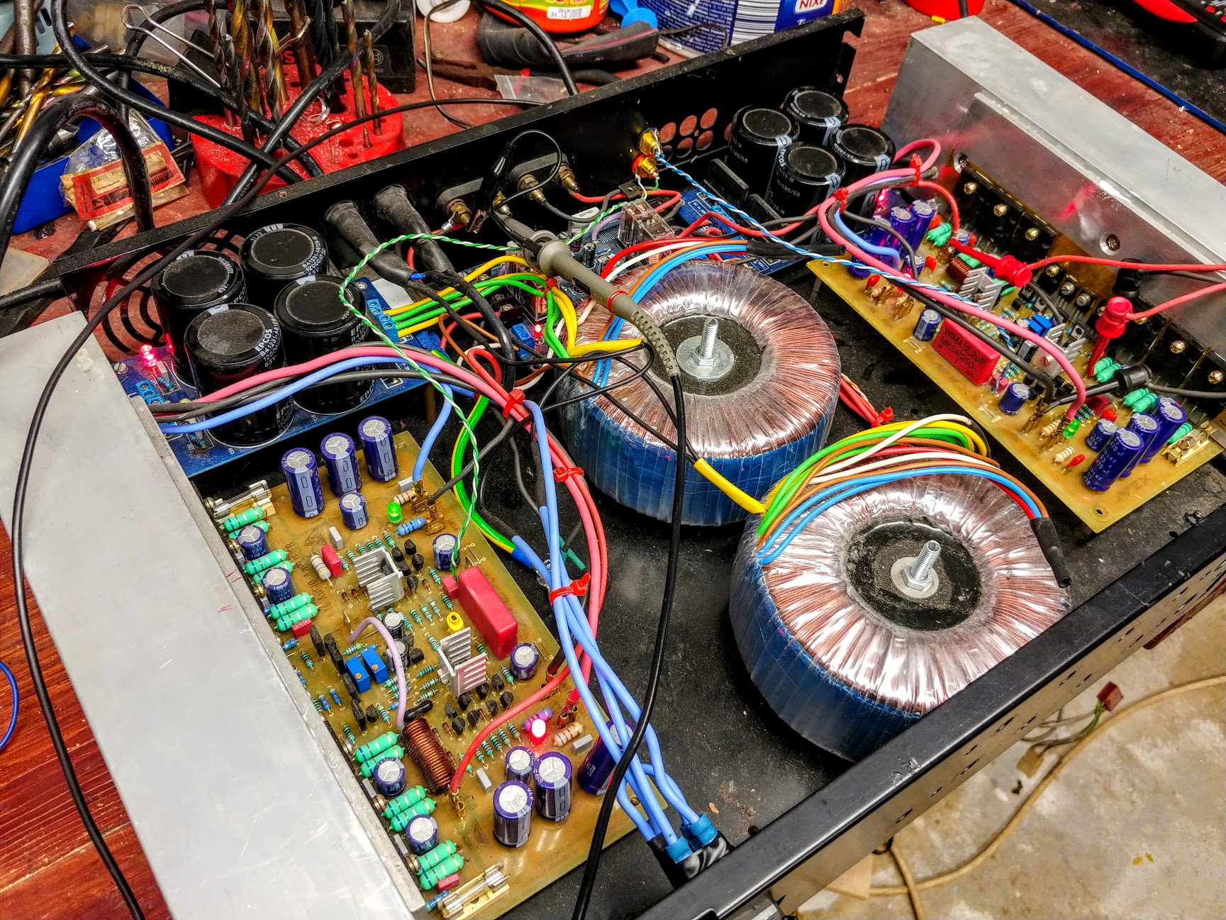

Hi shahzad831. Hope you know what I'm saying because I'm using an online translator. Which I changed into my future A40 and I hope it is good. To double the power I build 2 monoblocks, each block having 2 bridge boards. I use on powerful transistor terminals. I raised the current in the 800mA final resistors ... you probably call it a bias. The end transistors are very expensive, so I use big radiators. Extremely strong I have emphasized on the capacities, as I am convinced that they bring the good sound.)) For each monoblock are provided 250,000mF. For the whole amplifier 500,000mF .... or in short, half Farad.) Previous tests passed successfully. The good thing in this case is that every monoblock due to the bridging connection will use XLR connectivity, and also my oppo sonica dac has a fully balanced XLR output.
I hope I've been helpful. Greetings.
Thanks for feedback guys. Actually i have some numbers of orignal sankens in stock ao i want to utilize them in a40 or sr200 . Issue is this, that i have an SMPS (based on 2110 3525 ETD 59 DIY) whos output is +/-75vdc 10 amps . And i want to put that smps on job. What will be the best option SR200 or A40? Which amp have low THD and good temprature average. My speakers are peavey SP2. Thanks for your precious feedback.
Your option is A40, SR300, B500, HV23...
Then i will go for A40 nice symetrical design. I didnt saw Hv23 schematic yet i will try to search it

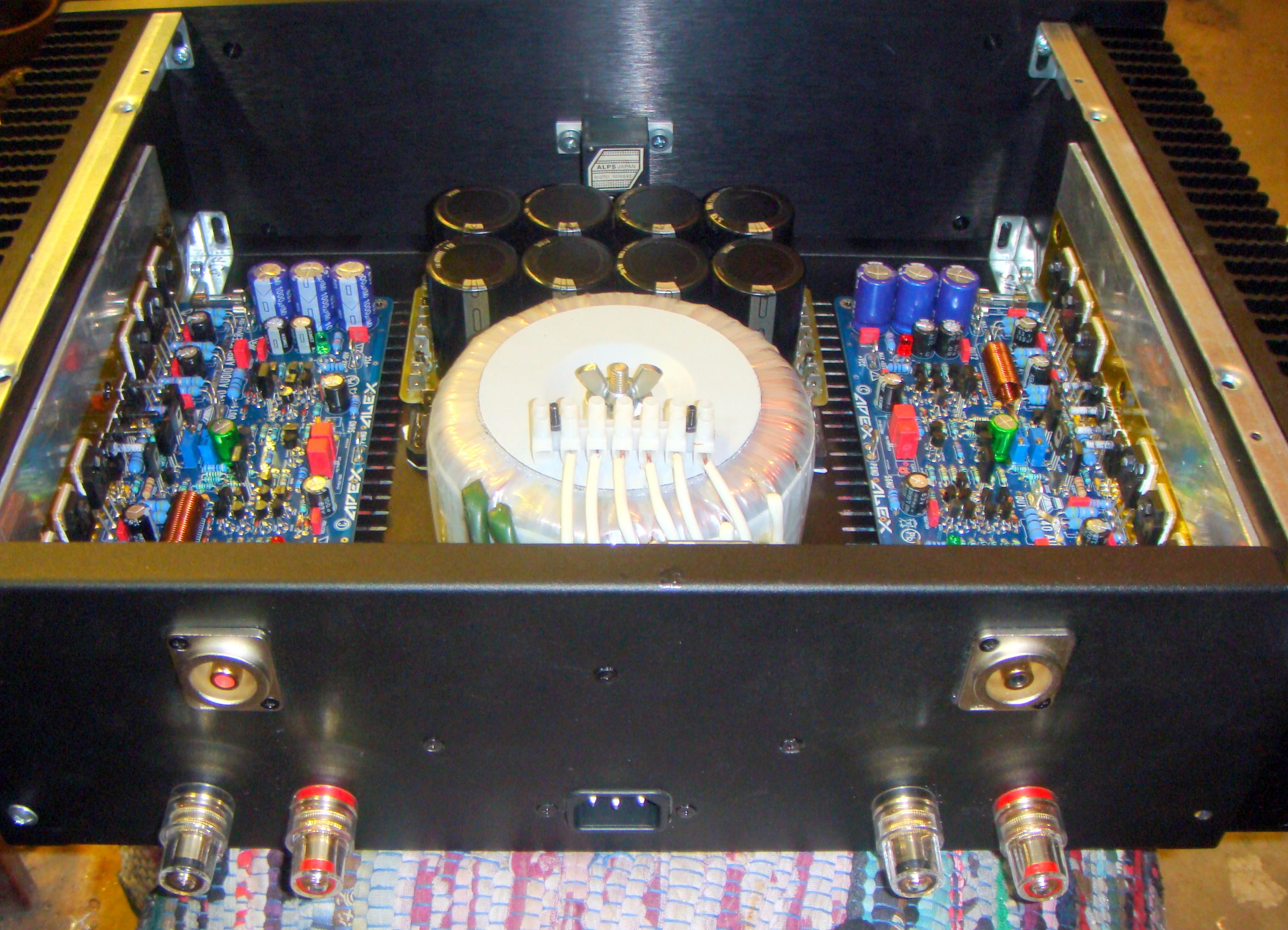

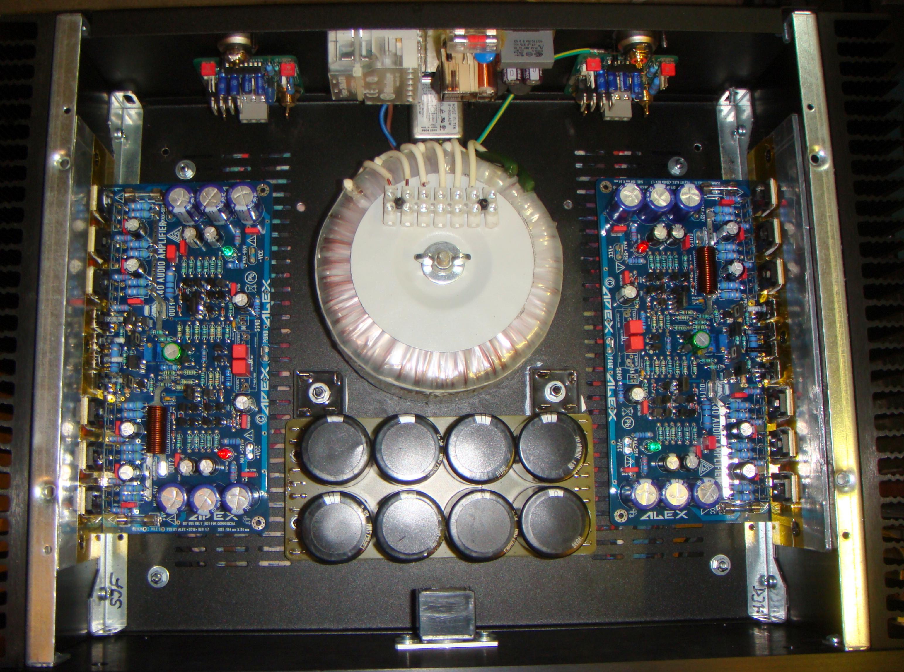

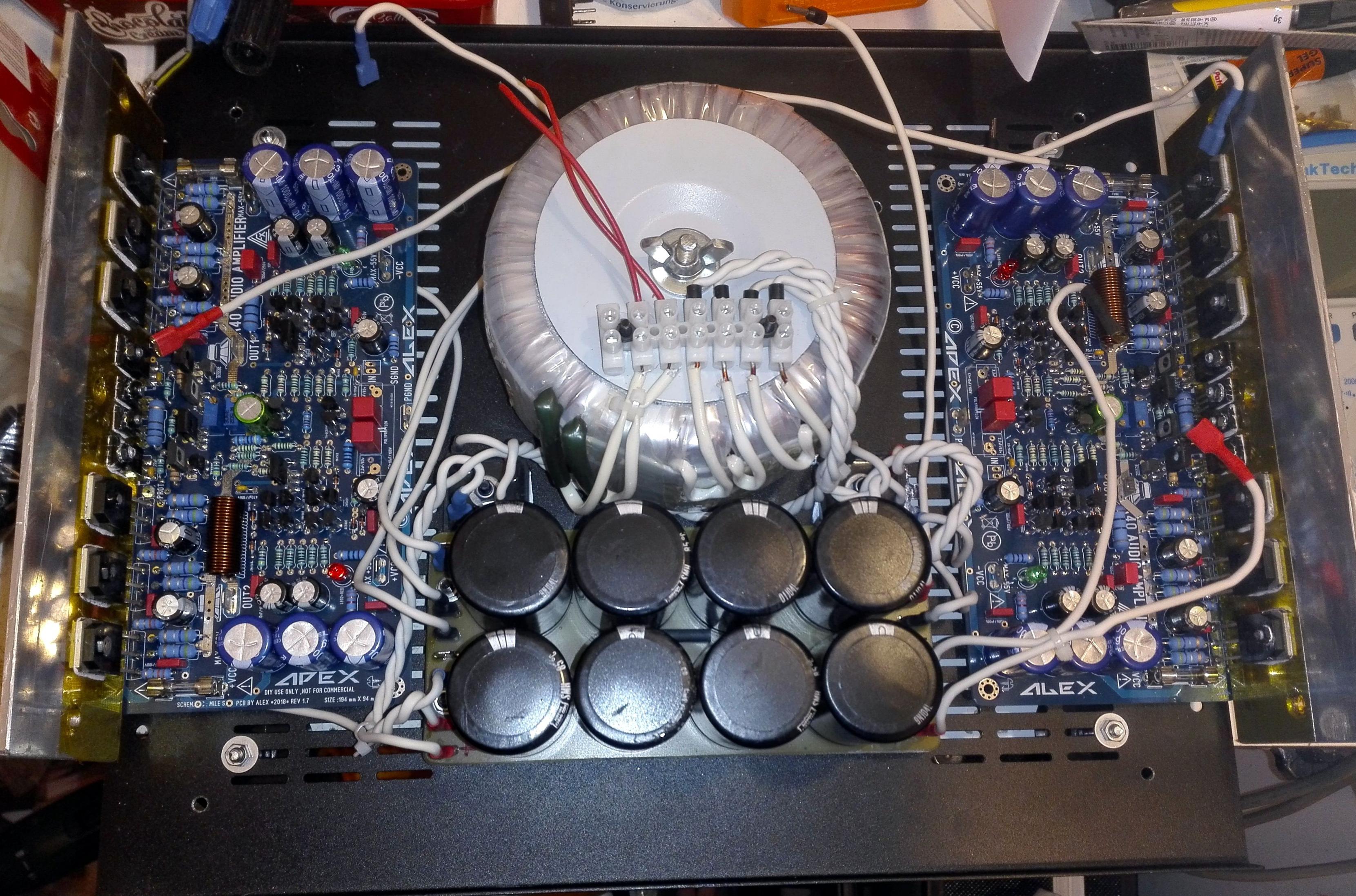

Hello Friends, Below are my build details. Trafo: 39-0-39, 5A per channel. Dual Mono. Drivers: MJE15028/29 (rated @120v, but i hope it is okay for +-54v dc ) sourced from RS components. Outputs: Toshiba 5200/1943, sourced from taydaelectronics. BC550/BC560/BD139/MJE340/50 - Sourced from RS Components.
I used Alex MM's 1.4v PCB (the offset series resistor should be 470k, that is the only change from the silk, otherwise populated components as per the silk). If you use 1.5v PCB, silk is having the correct value 470k it seems.
Bias: ~45mA, Offset +-5mV
Use genuine components, your amp will be up without any issues. And of course you will never get disappointed with the sonic, a great sounding amp 🙂
As of now I have only two pairs at the output, adding the other one soon.
Happy time for the Apex A40 fans 🙂
