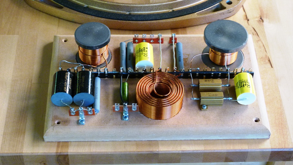

@doctordata
nice work have you made whit those nice filters !!! looks really good !!!
I will follow blue_luke and your "active evolution" because I have an Xta electronic DP426 waiting and a couple pro amps for this purpose..

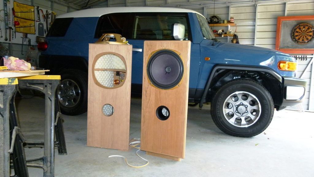

I found this site which is pretty much everything there is about tannoys: TANNOY Monitor Gold dual concentric speakers and particularly a complete discussion on the 'notch' in the passive crossover that is included in this active crossover circuit. tannoy
I also found that some guys use 2 amps per speaker by feeding the same signal to both amp and splitting the two sections in the passive crossovers 😕 I guess there can be some benefit here (better controlled impedances)but at that point a 2 way crossover is quite easy to fabricate and quite inexpansive so why not go all the way?

I am working on the speakers. (evaluating the TS parameters, removing dust, cleaning and repairing the wiring and the Xover)
One of the speaker was poked by a kid in the dust cap. This is not major and should not alter it in anyway but it looks bad 🙁
While evaluating a course of action to fix this, I noticed that a part of it seemed unglued, I pulled ever so slightly and it came off very easily!
I have read that some will remove the dust cap but I feel that Tannoy knew what they were doing and I would like to place it back.
What kind of glue should I use then?

I've erm.. "built' Ridley's active Xovers.
Frankly.. now relegated to the Spares box.
Emporer's Clothes.. as the quick answer.
Rebuilt (but re using OEM coils though) Tannoy original crossovers... simply sound/work better, with a LOT less complexity.
Notch?? Lotsa words on that subject 🙂.
Darned little audible evidence though.
Some can and do babble on about.. anything.
Caveat Emptor: Audio Land is full of half considered notions 🙂
