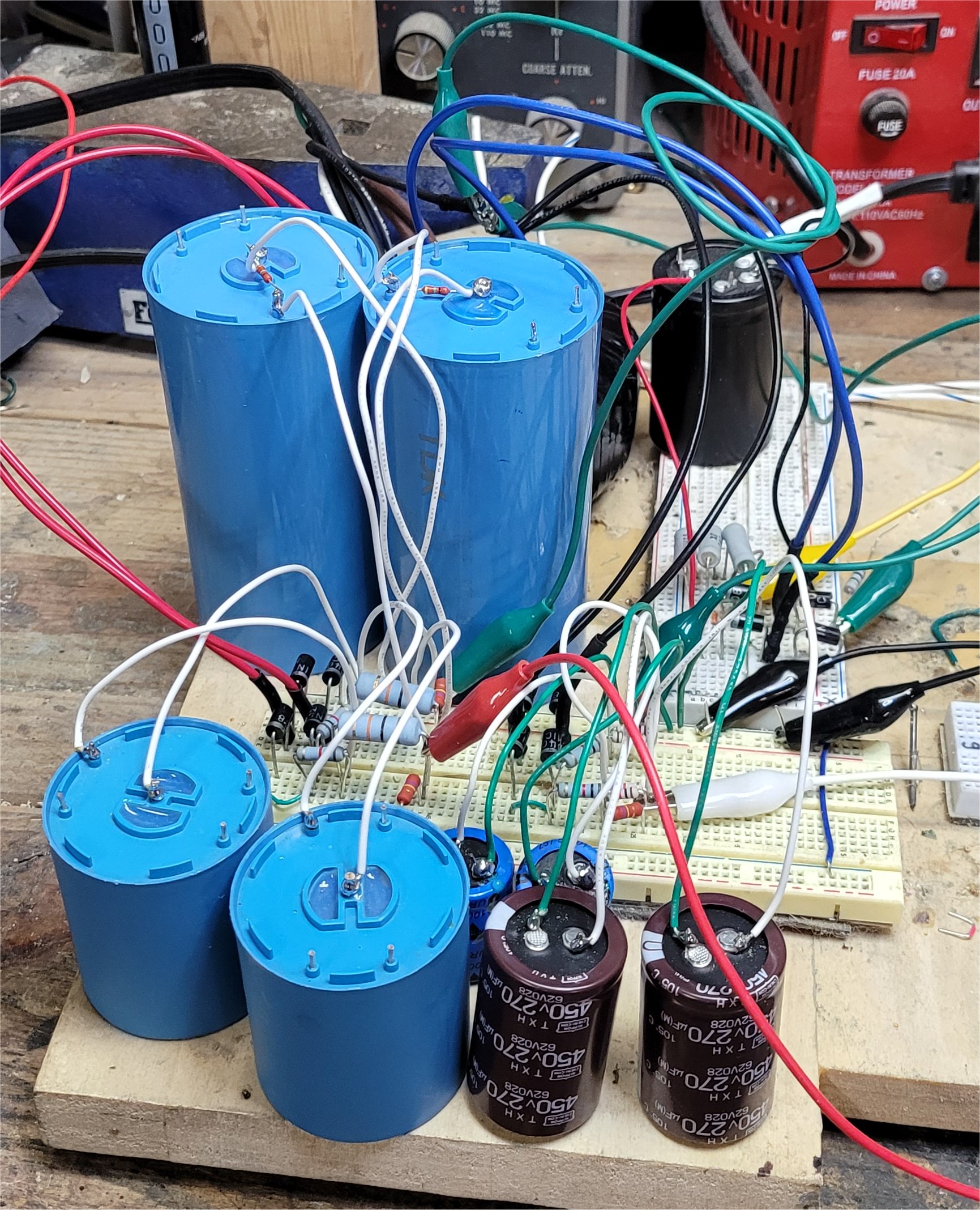

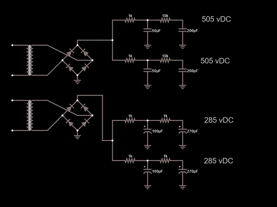

Either way, my order came in and I split the power supply into separate rails for left and right. The film caps are on the high(er) voltage section and they are MASSIVE. Think "soda can." I need to bring the voltage down a bit on the lower voltage section. I deleted the filter reactor as it doesn't seem necessary at this point. It's still a work in progress and nothing is set in stone. Attempting to get the front end biased with the new B+ now.
I wanted to add that everything else notwithstanding, the channel separation is OUTSTANDING on this thing now. Little to no audio leakage to the B+ rails either, from what I've seen so far.
