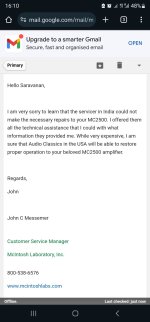

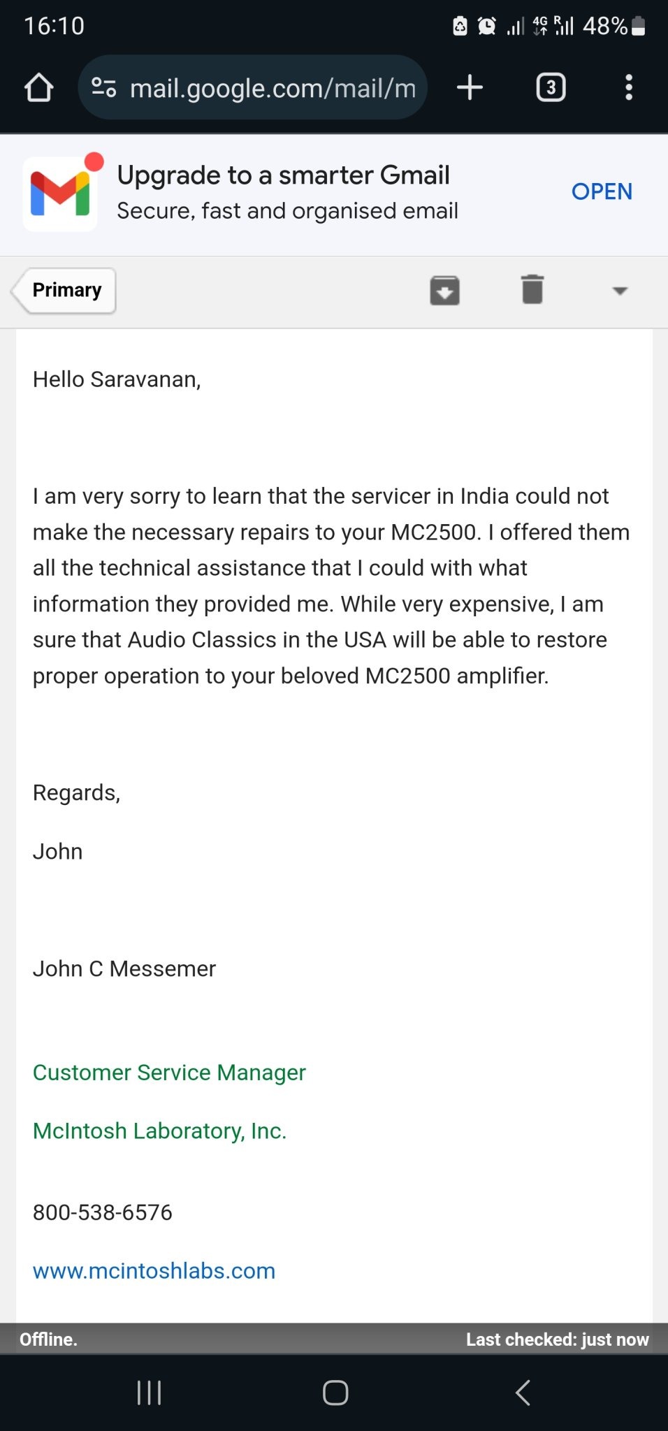

Hi Rayma,
The attached screenshot is the email that was just sent to me by the head service person, John Messemer at McIntosh USA an hour ago as a reply to my email about how, after being made to purchase all the expensive spares from McIntosh, the local service centre still failed to repair my amplifier and is just returning it back. To be honest with all of you, I feel extremely cheated. I don't know if I am correct to be feeling this way but I still do.
Yes. After a bill of an equivalent of almost 1600 USD and a still broken amplifier, anybody would still feel cheated, Rayma. This is just a transistor amplifier made in the 80s. If an authorised service facility is incapable of completing their job that they have even billed me for, someone has to take responsibility for it. The company that authorised this facility is McIntosh isn't it? So, who has to take charge and be responsible for this? Instead, all I get from these people are a ' I am sorry, our bad ' email. Is that the kind of response and attitude, one would expect from a company such as McIntosh? I am not complaining here. This is just an answer to your reply last Tuesday about contacting the company. You were right in advising me to but there is something to learn from this for everyone reading this post and anyone who considers purchasing anymore of this company's products. 928, please pm me should you need any help with your amplifier. This post is now closed.
